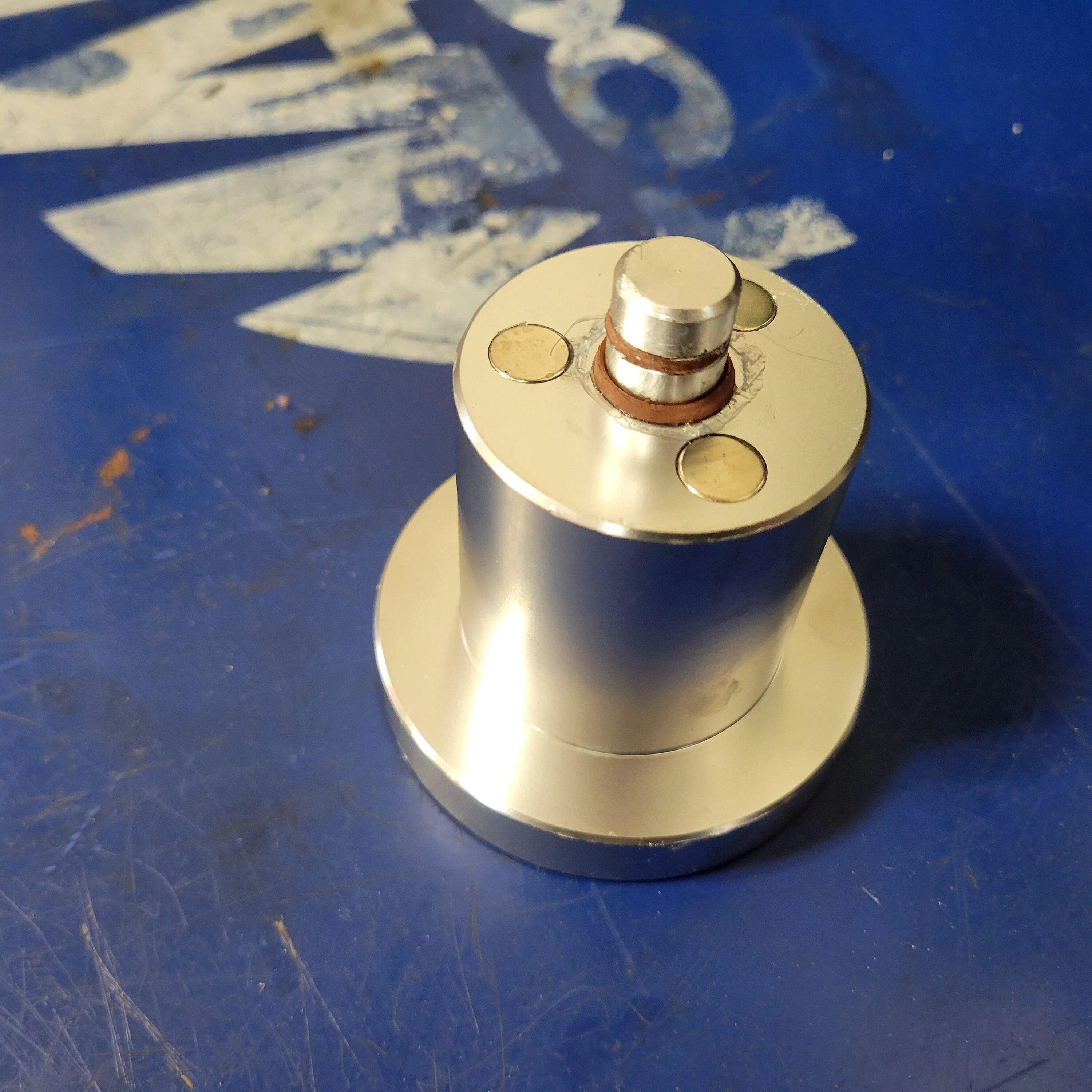

This week the R1T hit 4,994 miles and it seemed like a good idea to rotate the tires. We have a two post lift so I ordered four of the hockey puck inserts from Jeff Bezos at
https://www.amazon.com/gp/product/B0C22YV6NV/ref=ppx_yo_dt_b_search_asin_title?ie=UTF8&th=1

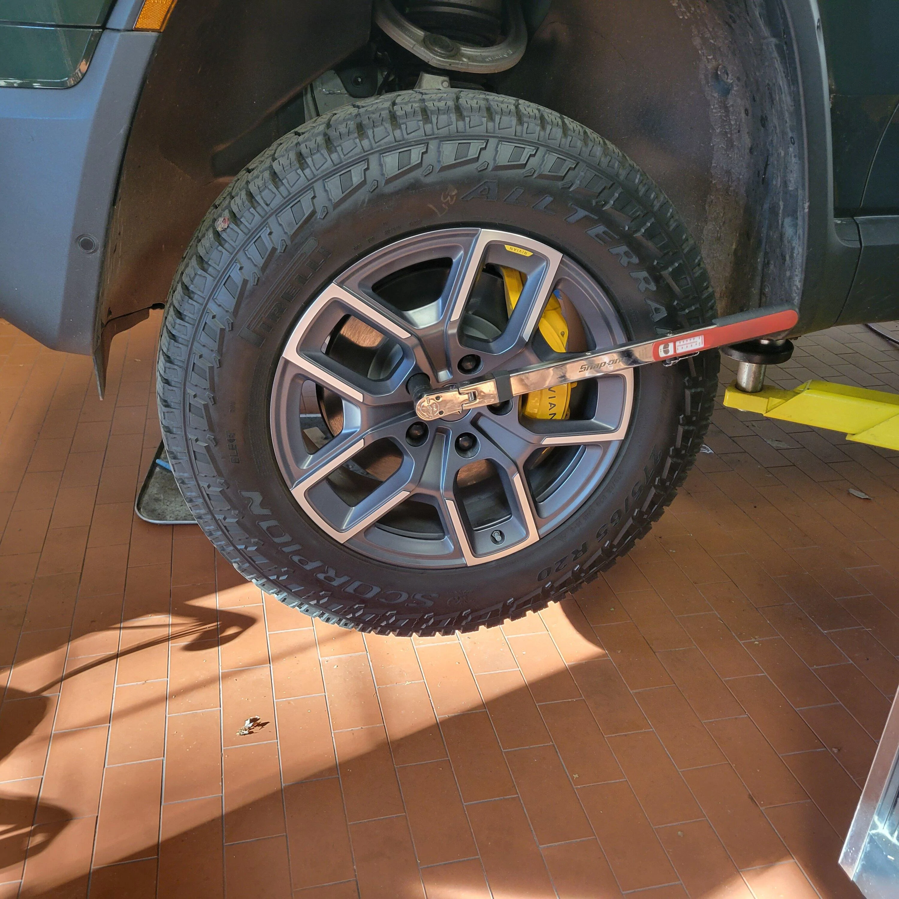

A couple of things to know when you do this. They say to set the ride height to the highest setting.. Then, go to settings and put it in tire rotation mode. From what I can tell the tire rotation mode locks up the rear tires and allows the front tires to rotate. This is a heavy truck, and the wheels have five lug nuts. For such a heavy truck I am surprised it doesn't have eight. When you put them back on the torque is supposed to be 140 foot pounds.

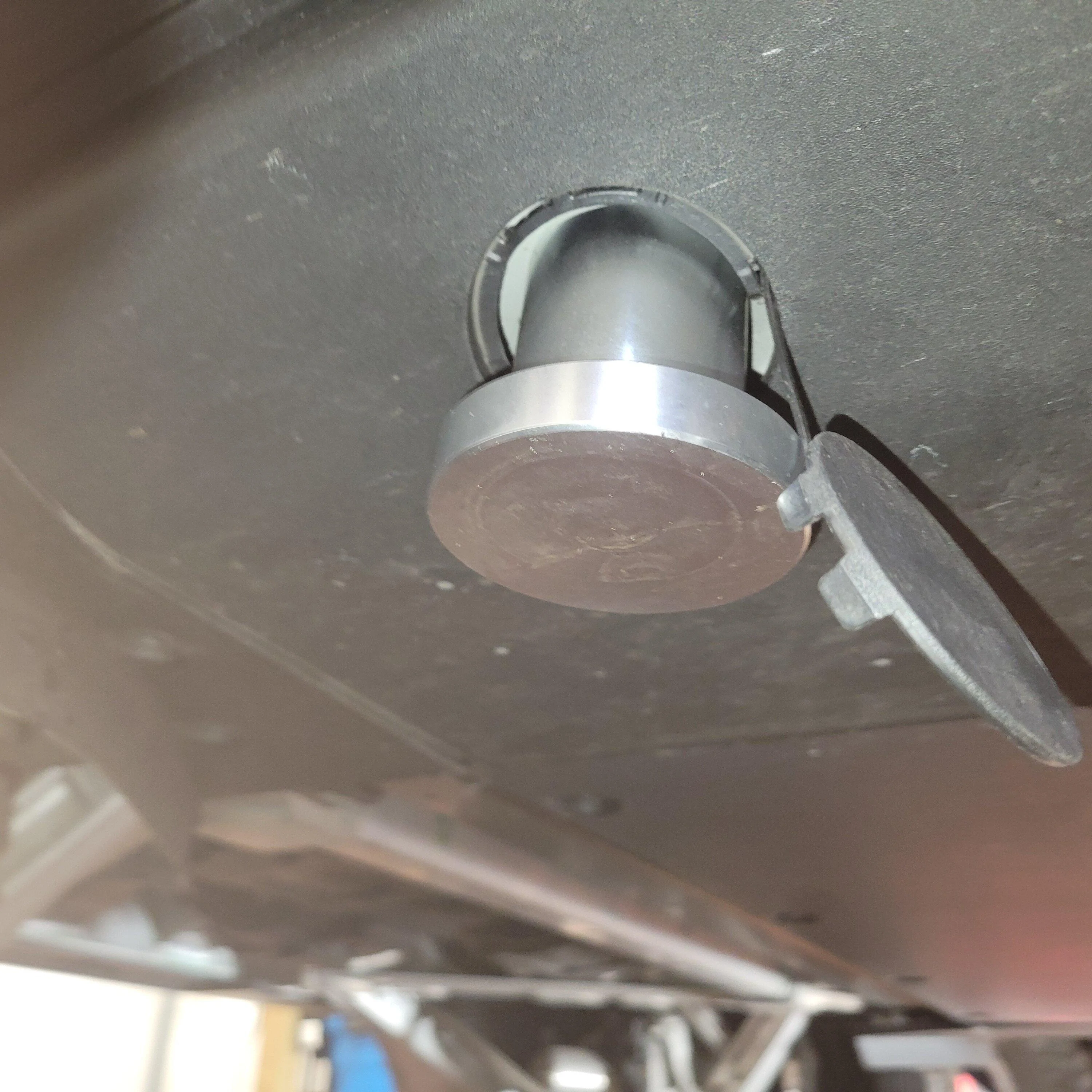

You need the hockey pucks if you are using a lift, or some way to put your jack on the frame and not the plastic. The pucks I bought have three magnets to hold them in place in addition to an "O" ring, which seems like a clever idea. The "O" ring is useless and only makes it hard to use. I tried putting some silicone lube on it and still no luck. As you can see, the "O" ring got cut when I installed it.
Rotating the tires took less time than putting it on the lift! I also set the tire pressure to 48 PSI.
