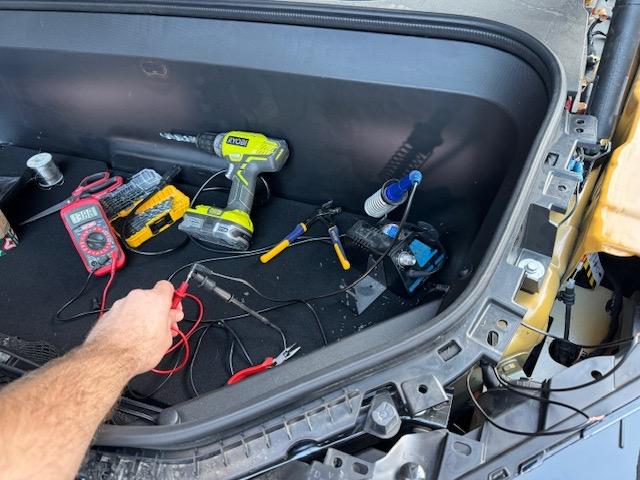

My R1S didn't come with the frunk 12v outlet but as others have mentioned the harness that feeds the driver's side frunk light still had the 12v wires attached. A lot of people have been trying to find an after market plug for this. Instead of going that route I just used wire taps to splice the wires directly.
The tank comes with a nice cigarette 12v plug with a built-in power switch. I disassembled this and installed it all directly in the frunk tub. Pictures below.

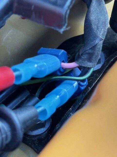

Added the wire taps here. The pink is positive, black is negative.

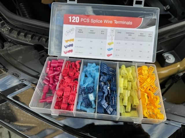

Splices I used.

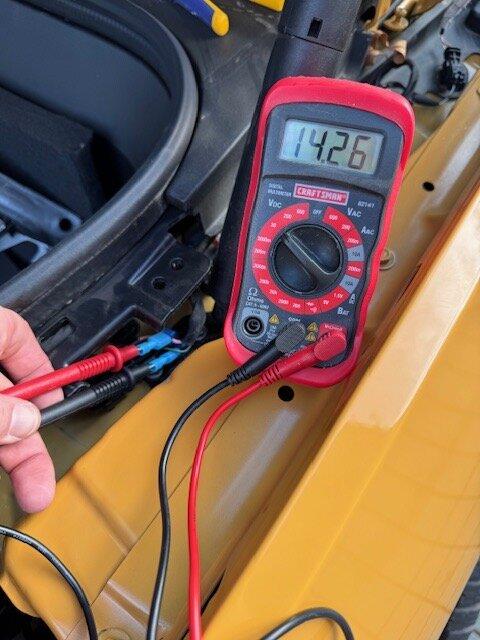

Verifying polarity and voltage.

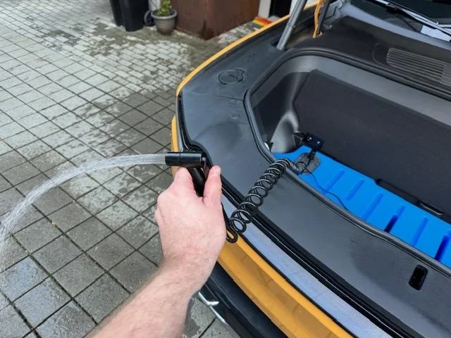

Installed...
Rivian R1T R1S Frunk Water Tank (Rivian-Aftermarket / Boxgods) and Custom 12v installed IMG_0173
... and working.
