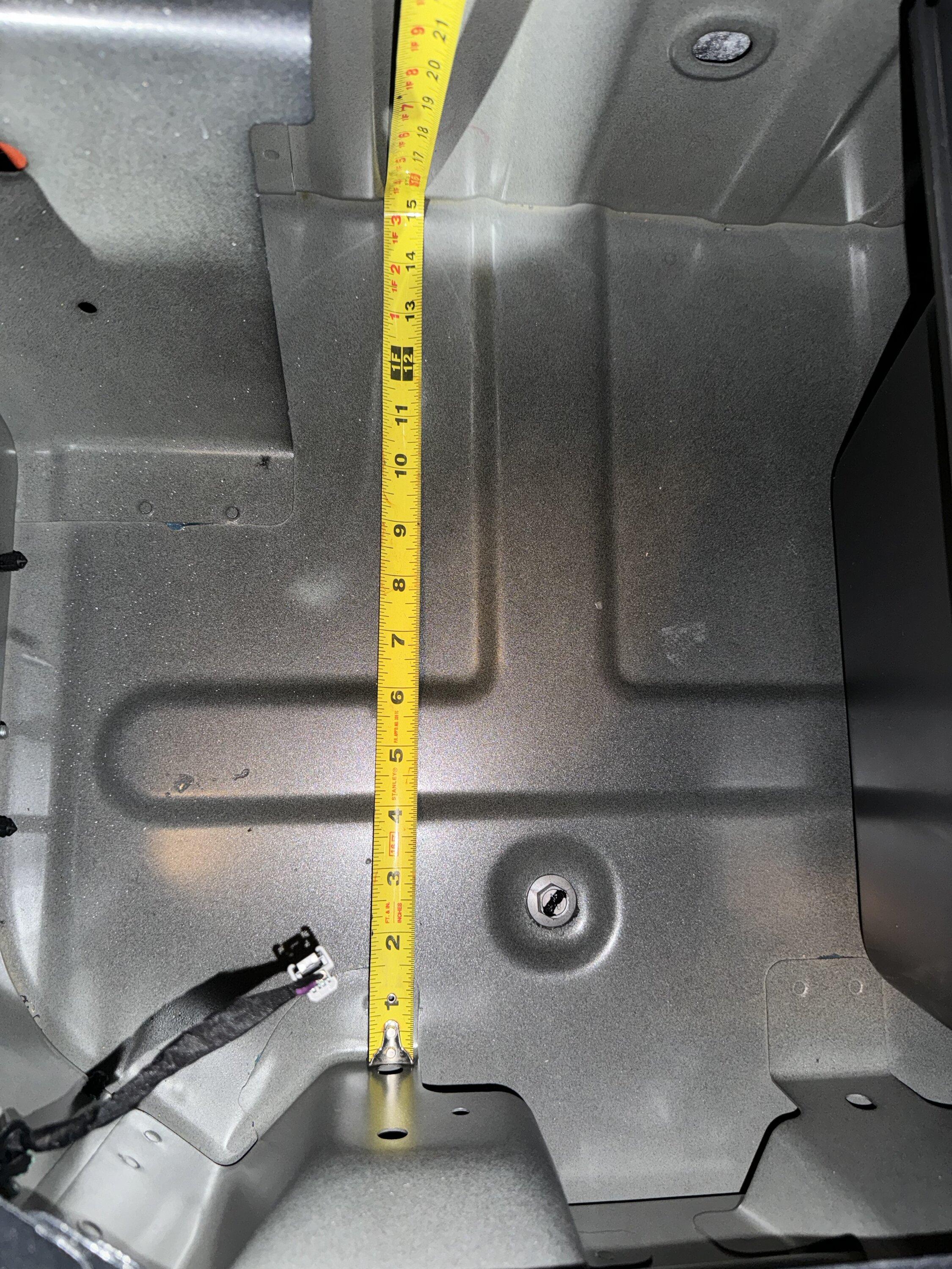

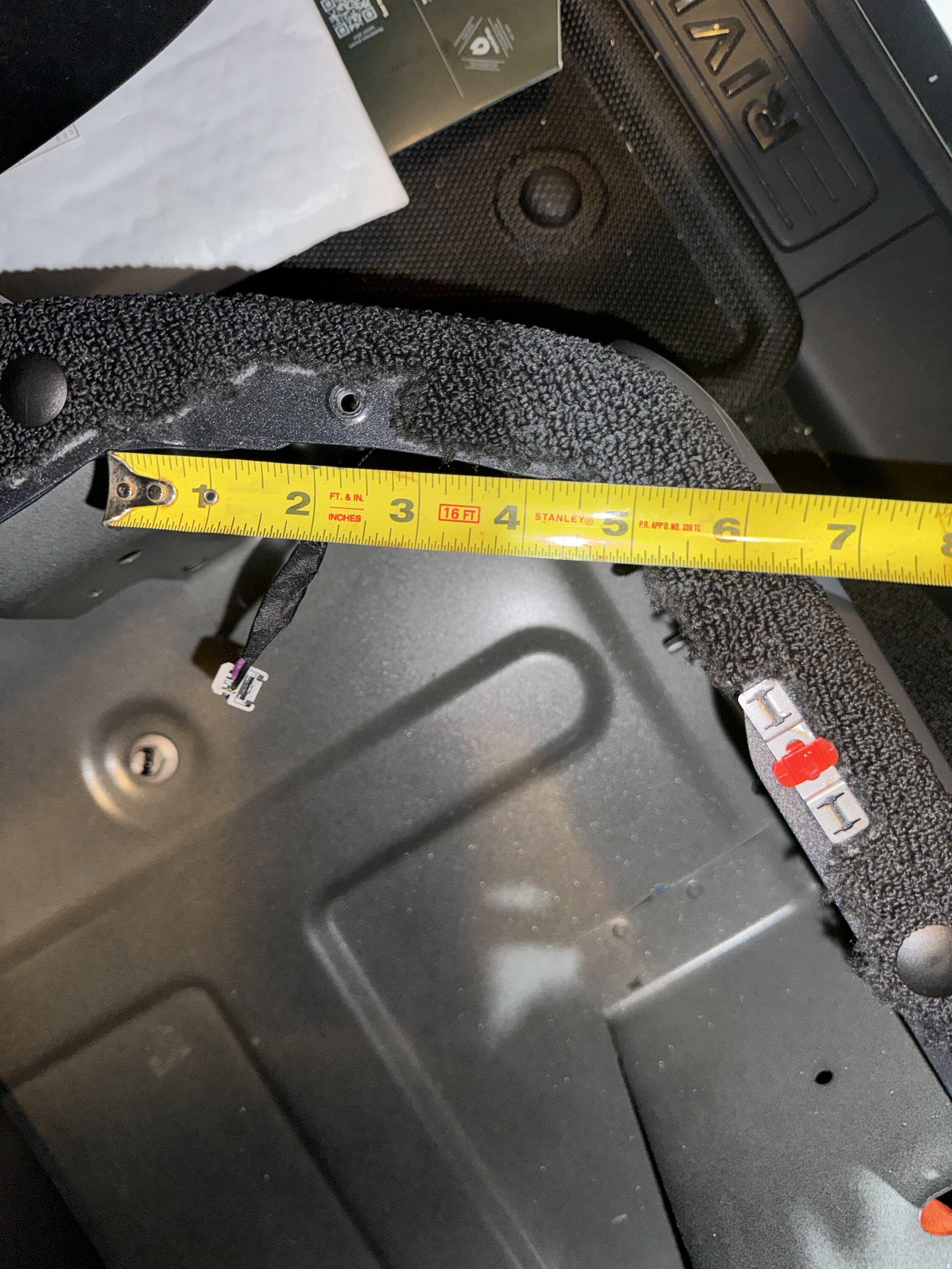

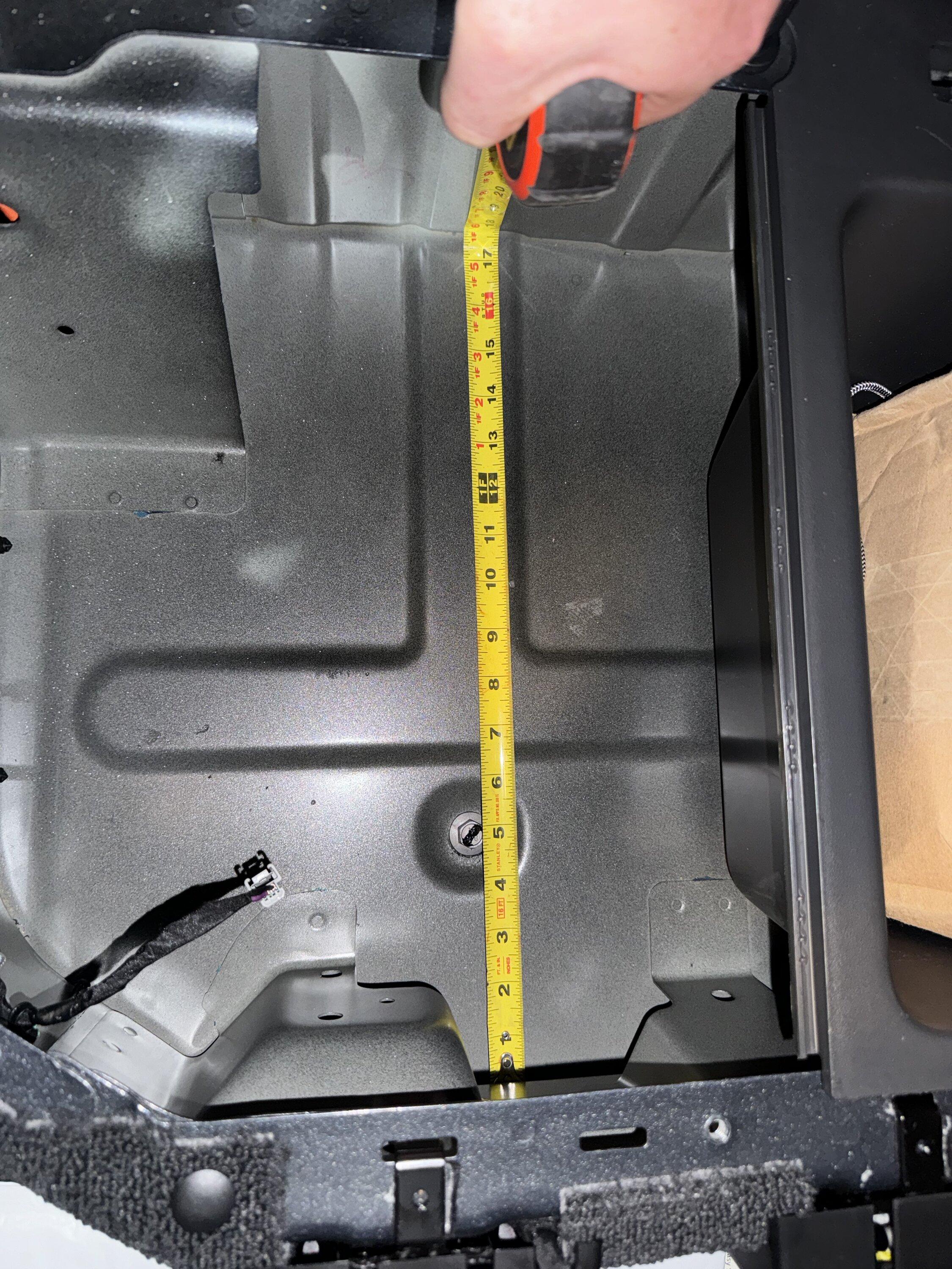

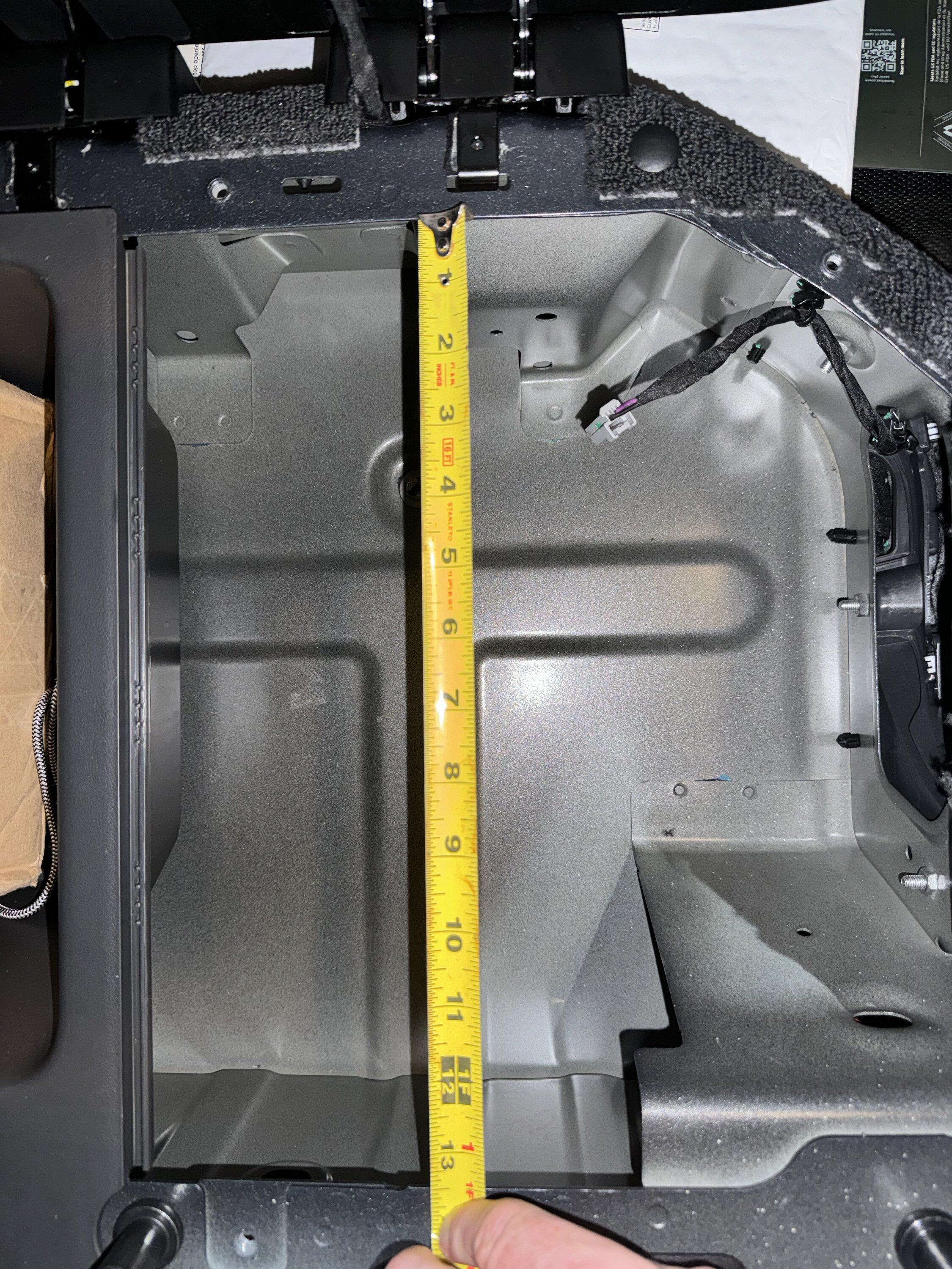

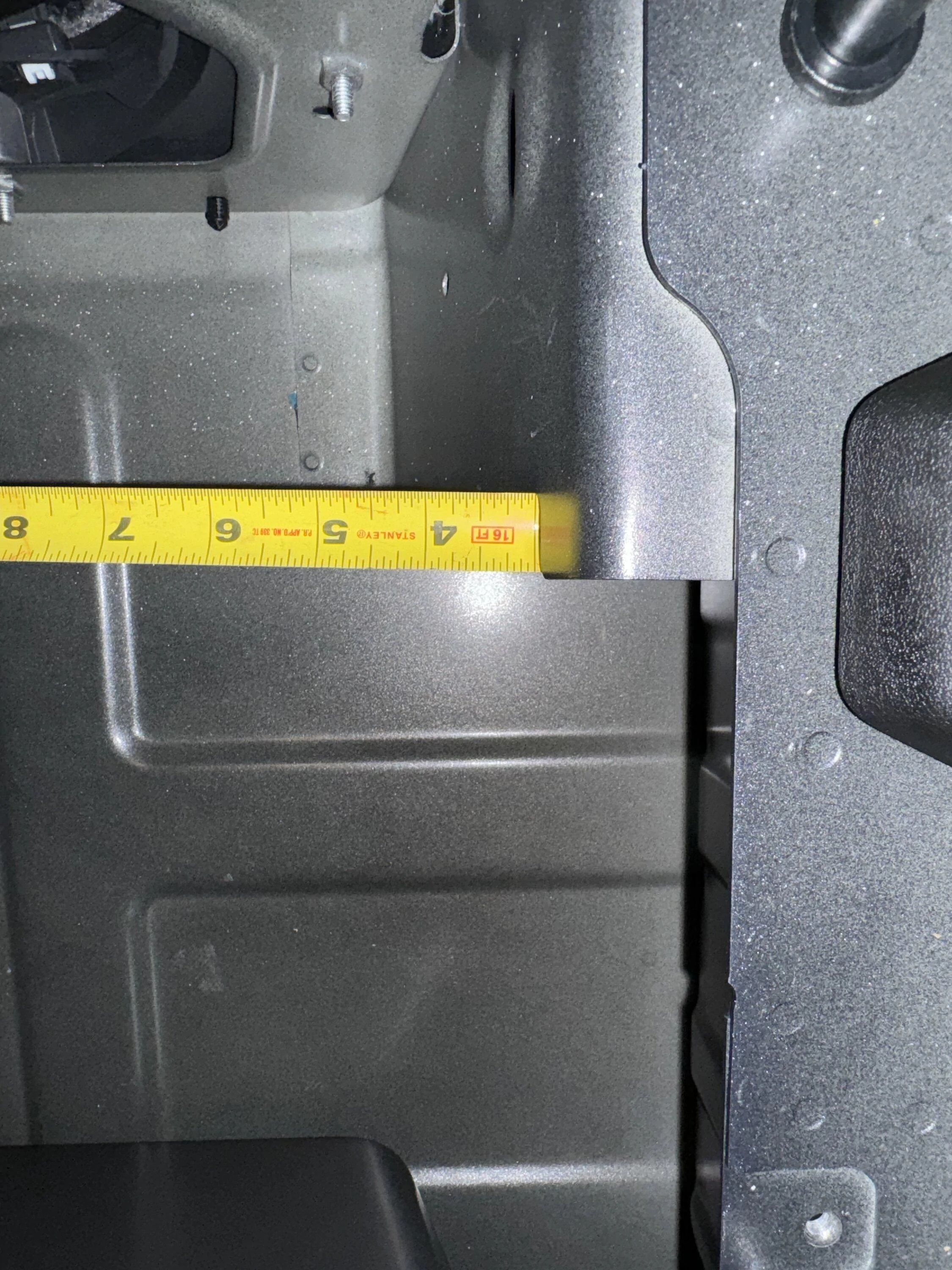

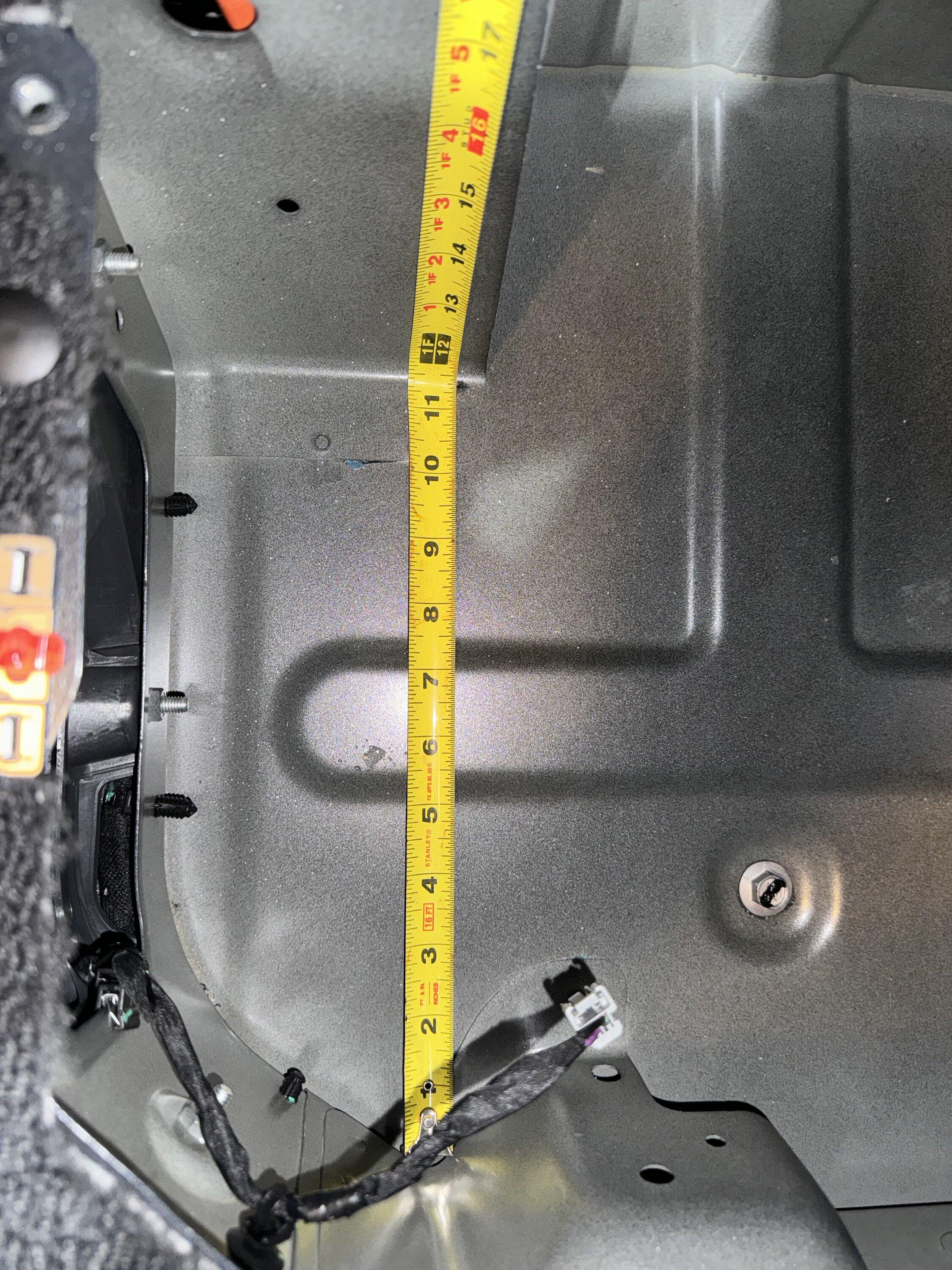

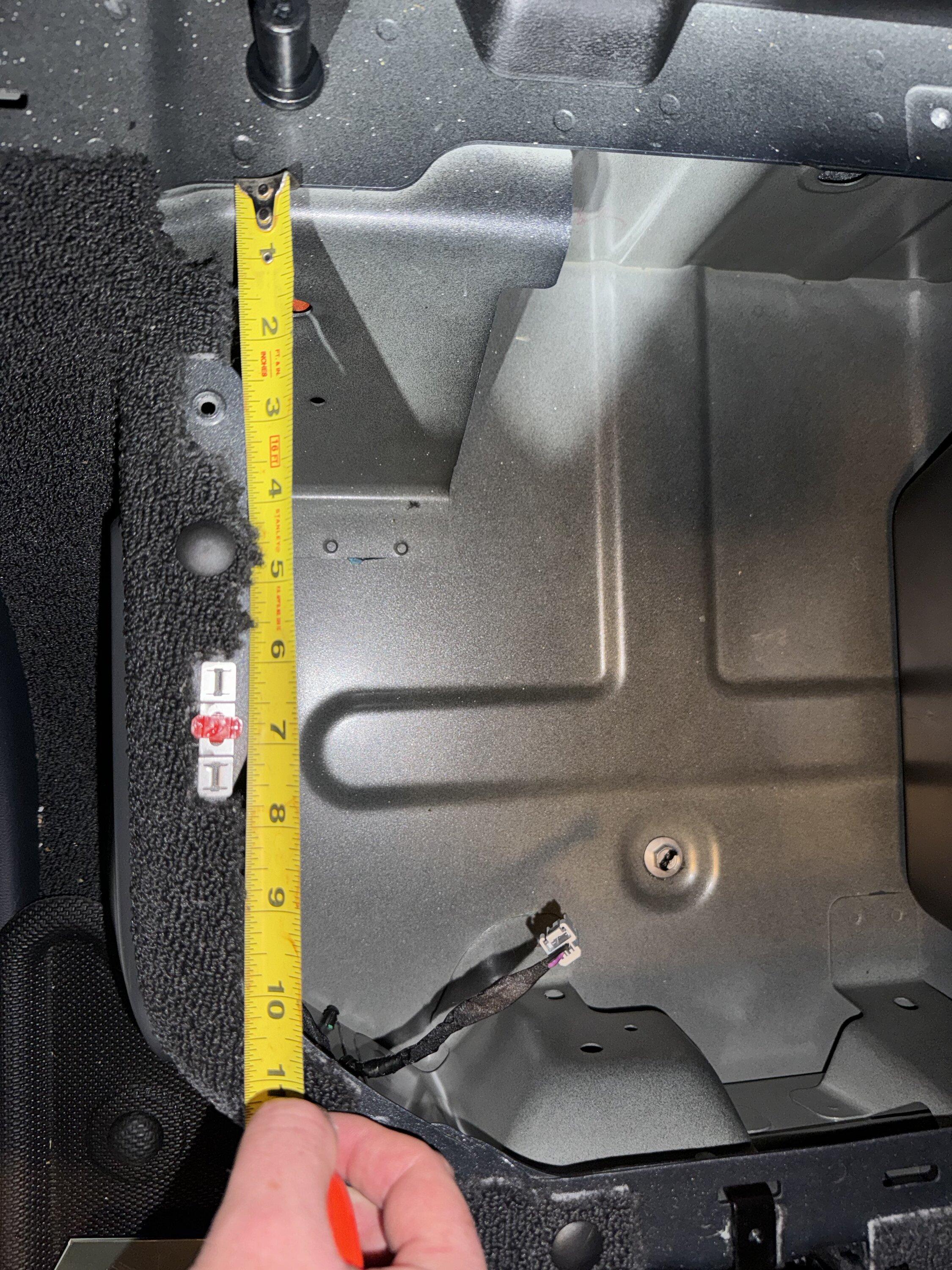

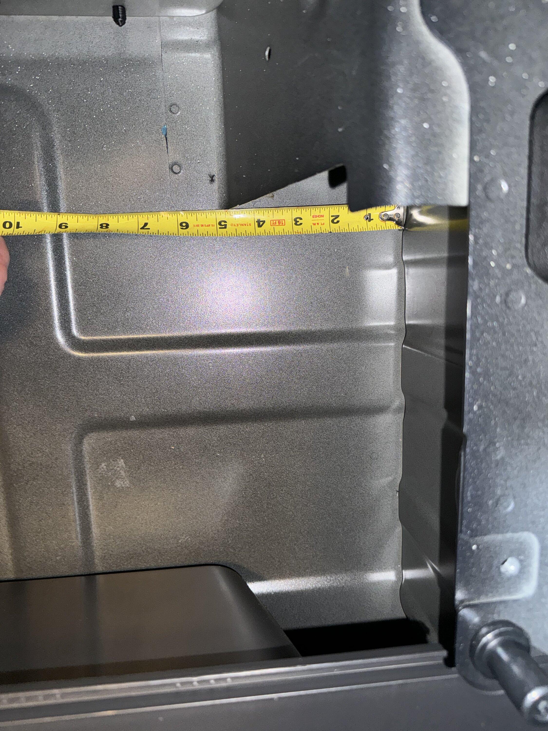

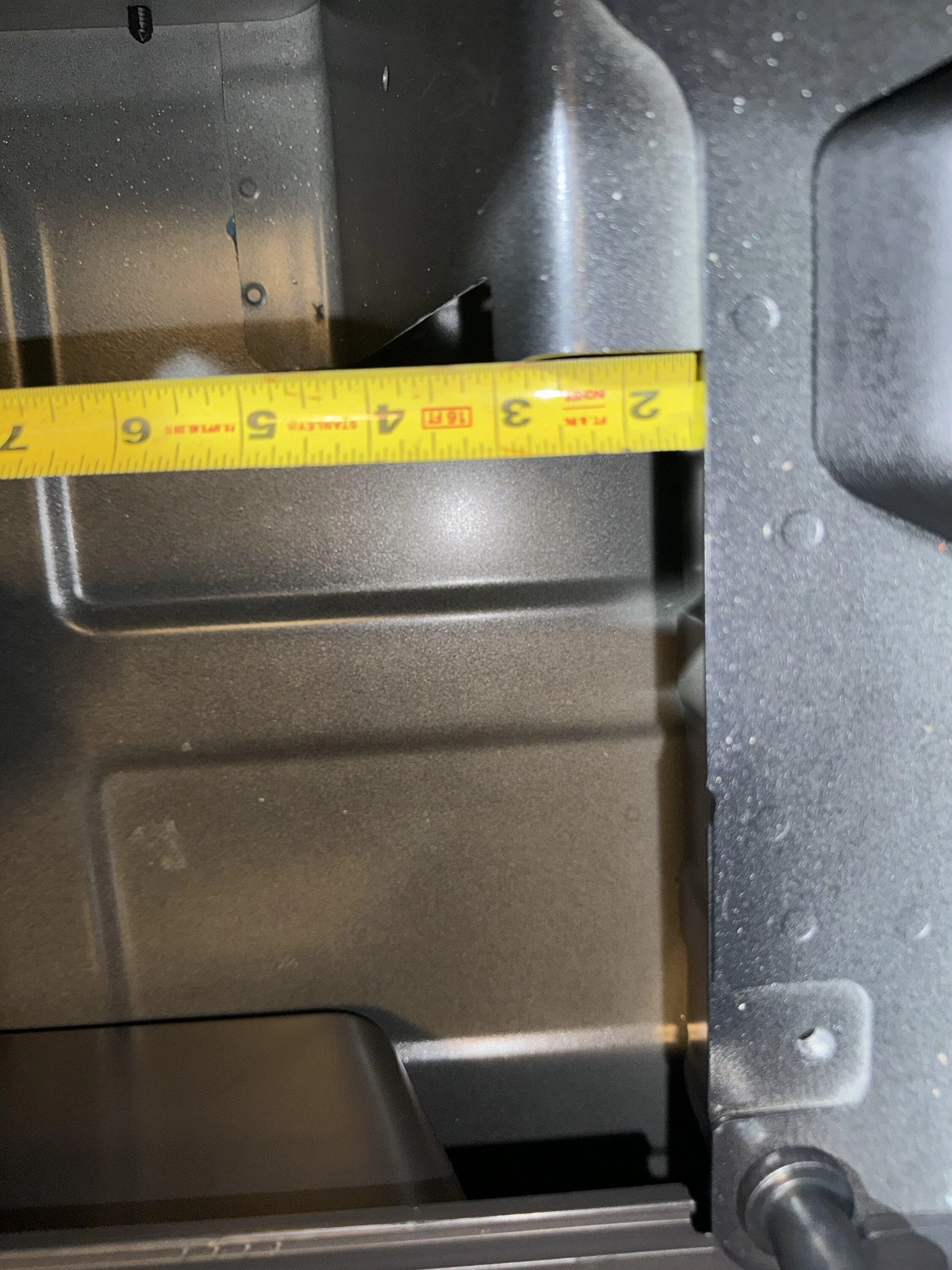

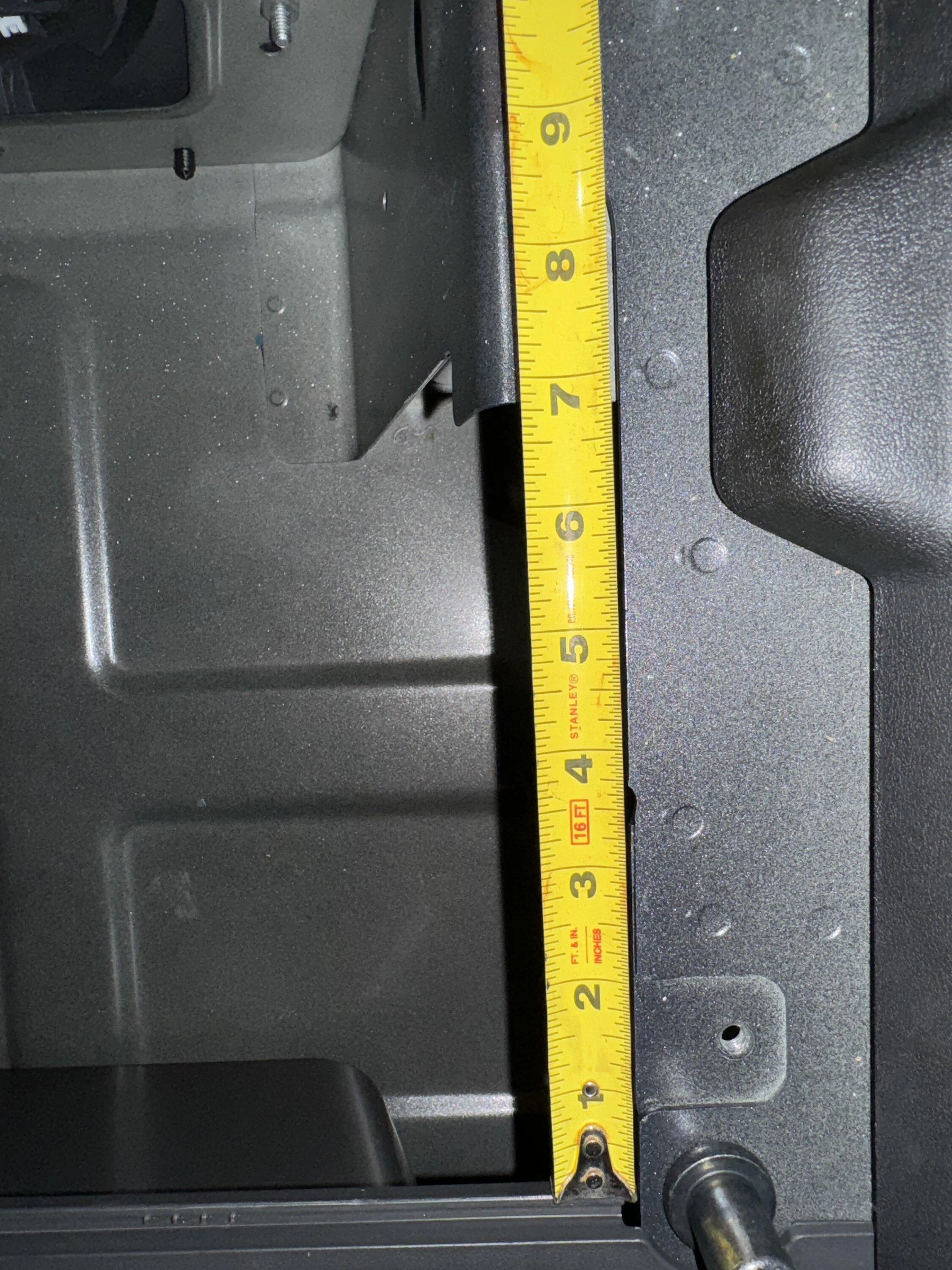

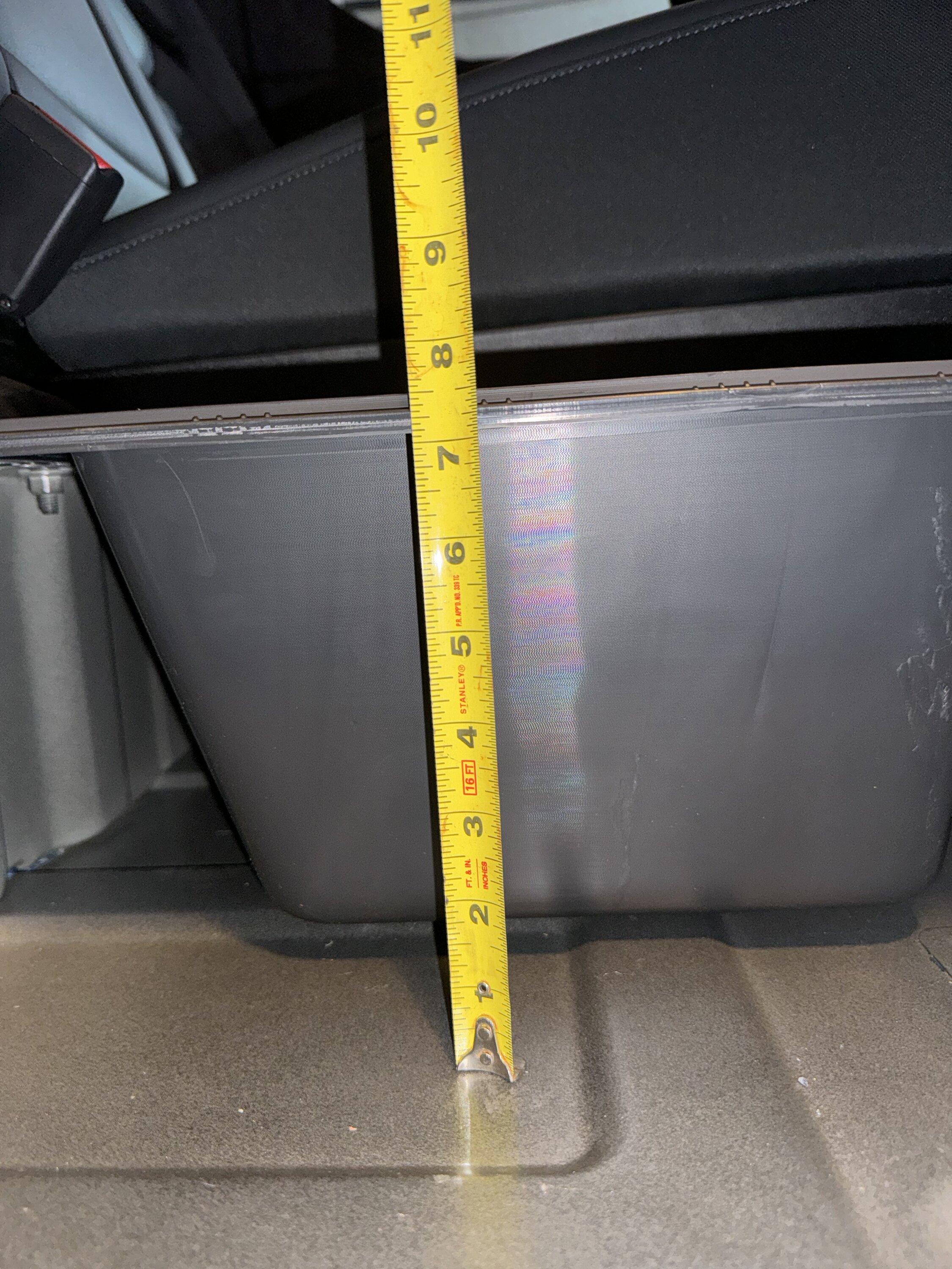

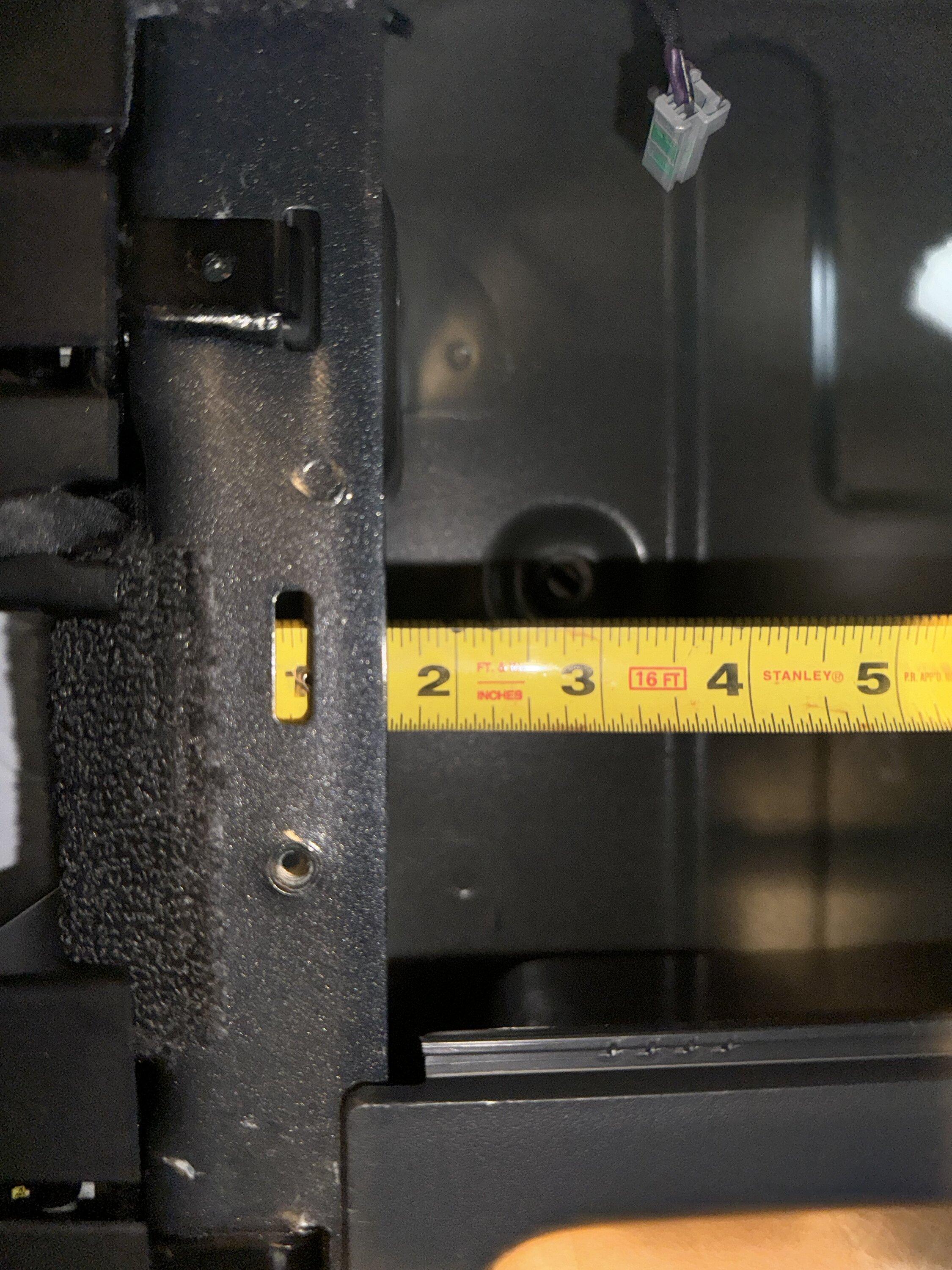

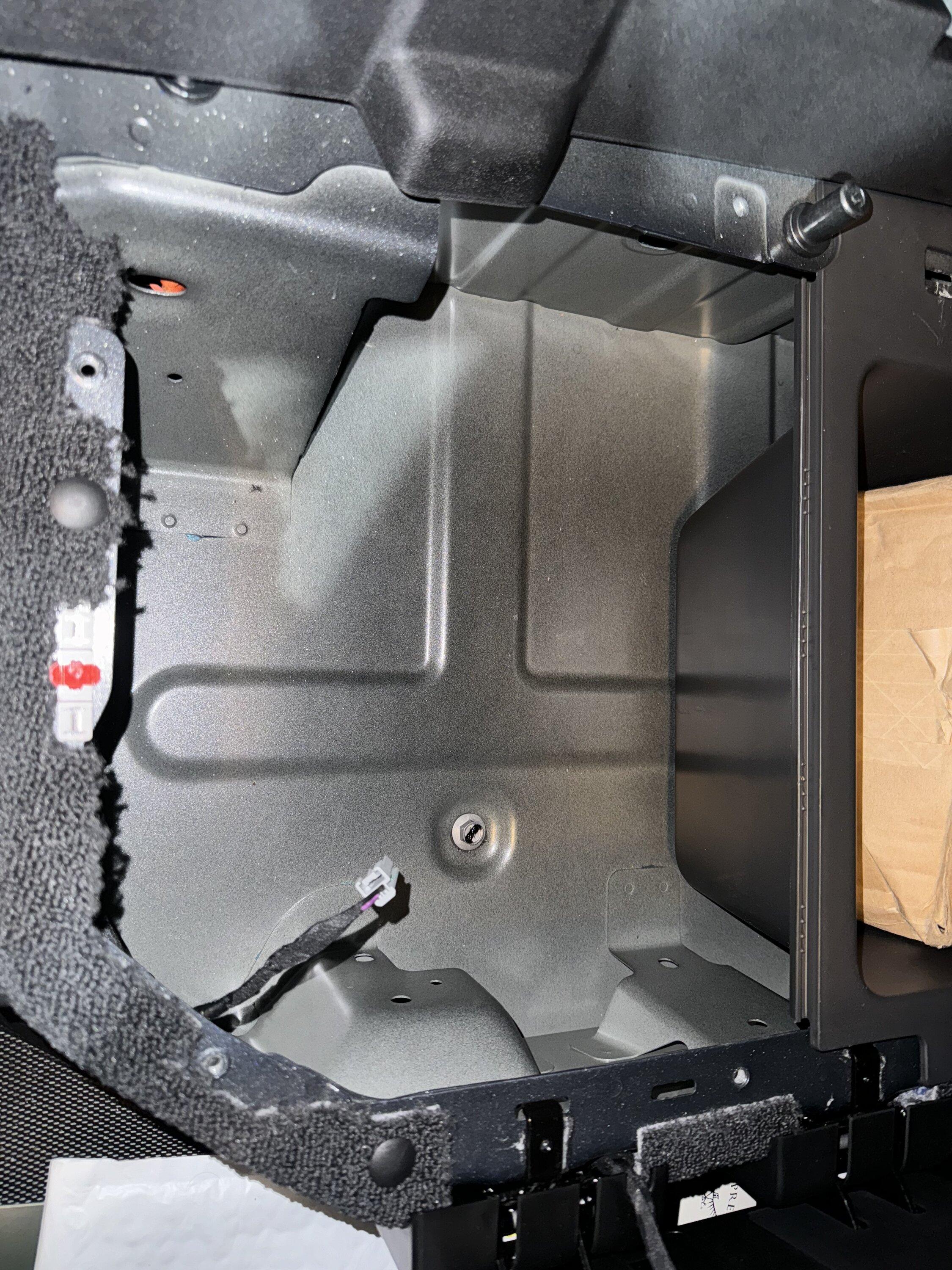

I've put 20,000 miles on my R1T and I LOVE this thing. But one of the things that has continued to underwhelm my ears is the absolute deficit of low end bass response out of the Meridian System. I think it's an absolute joke they put a 6x9 speaker in this truck and call it a woofer.

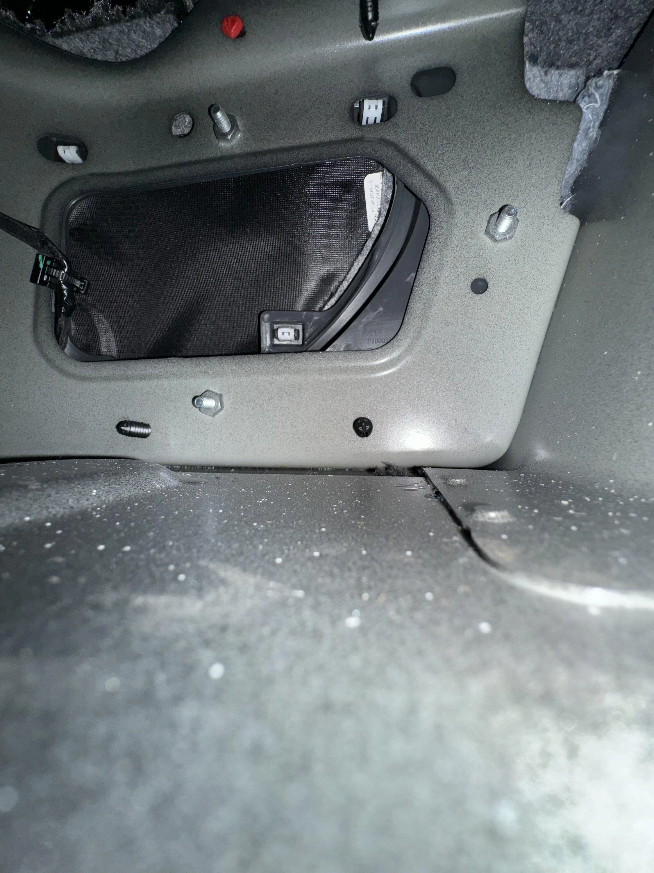

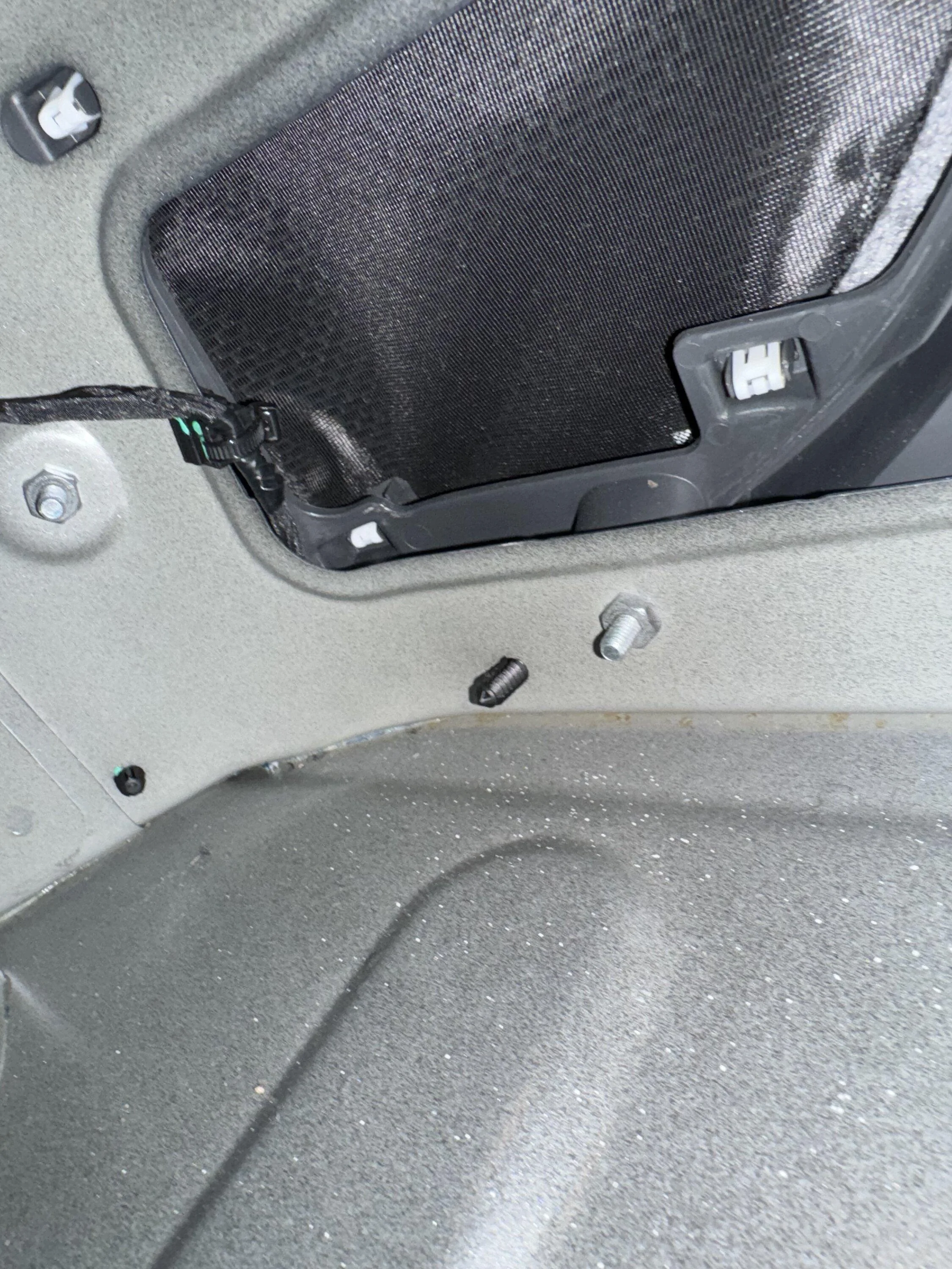

As such I've begun to explore what options I may have to upgrade the subwoofer. I hope to create a rough sketch of the measurements and get an idea of what kind of sealed box and its volume may fit into the stock space with some modification.
Rivian R1T R1S R1T Subwoofer Area Photos and Measurements IMG_0363
Rivian R1T R1S R1T Subwoofer Area Photos and Measurements IMG_0380
Rivian R1T R1S R1T Subwoofer Area Photos and Measurements IMG_0379
Rivian R1T R1S R1T Subwoofer Area Photos and Measurements IMG_0378
Rivian R1T R1S R1T Subwoofer Area Photos and Measurements IMG_0377

Curious to see what the original meridian enclosure looks like when removed, and the 6x9 speaker enclosed.

Oddly enough its an enclosed box made of roughly ⅛" thick plastic that is extremely custom fit to that space. The 6x9 fires outward into the grill found on the base of the R rear passenger seat. I'll take a pic of it the next time I tear it down.
I think the existing box (as a 3d template) will be how I create a fiberglass shell for the space in which I can mount a 10" or 12" sub, depending on the resultant volume and mounting diameter. I'm thinking only a 10 will fit in the space without sacrificing under-seat storage.

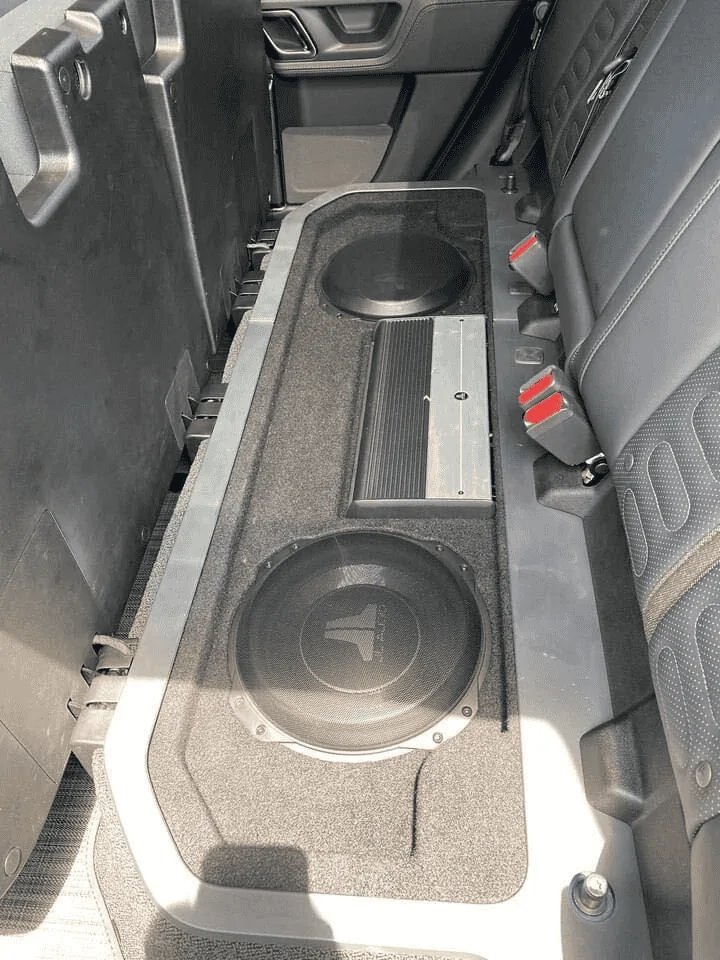

There is a post floating around somewhere where a sub shop built a custom enclosure that used the entire under rear seat space and used 2 10"s if I recall. Really nice set up. I will see if i can find it.
