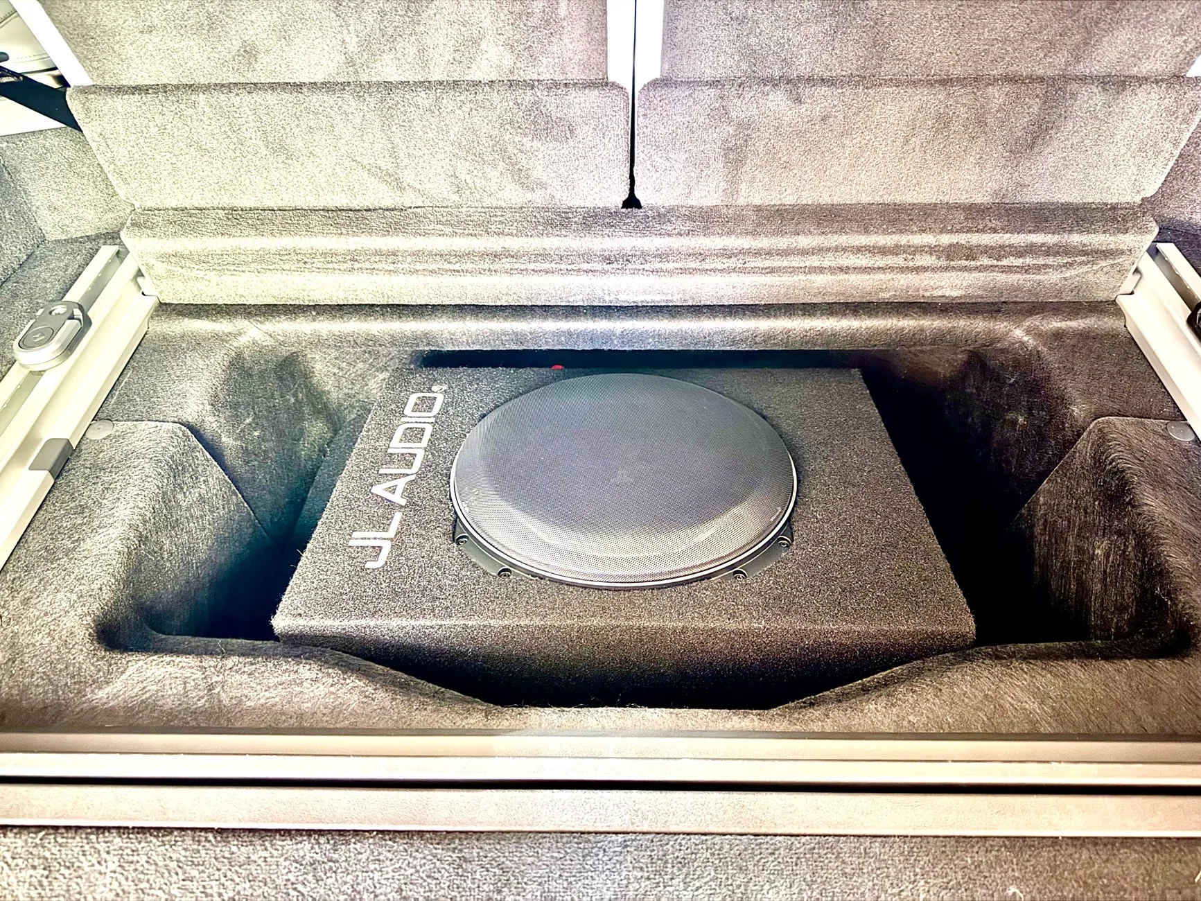

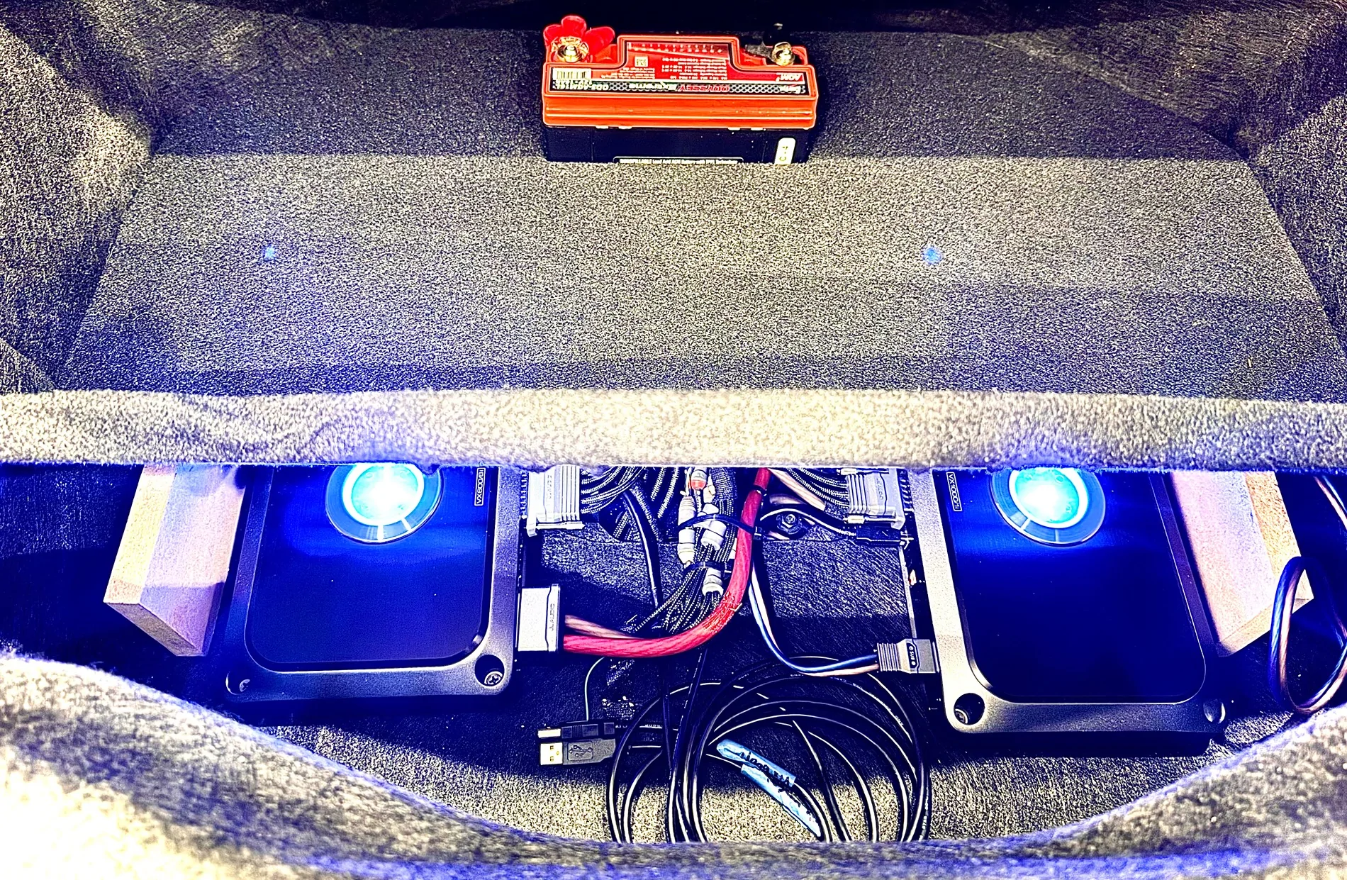

I have a full aftermarket sound system with 13 inch sub. After the update I immediately adjusted the bass on the EQ and on my bass wheel. Clarity sounds even better to me now but the bass was definitely turned down on the most recent update.
IMHO just need to update the full system, it’s my favorite thing about my Rivian now 🤣
So you put adapters market system in your R1S? I was considering this, but I already paid for the premium system.
AdventureTravel
Steven
Oct 19, 2024
Rivian R1S, Tesla Plaid, Jeep Wrangler 4XE
Well if you are happy with the system you have then no need to change it.
I had the regular stock system and the sound quality was so bad that I immediately had to replace it. A good system transforms the vehicle, night and day difference.
