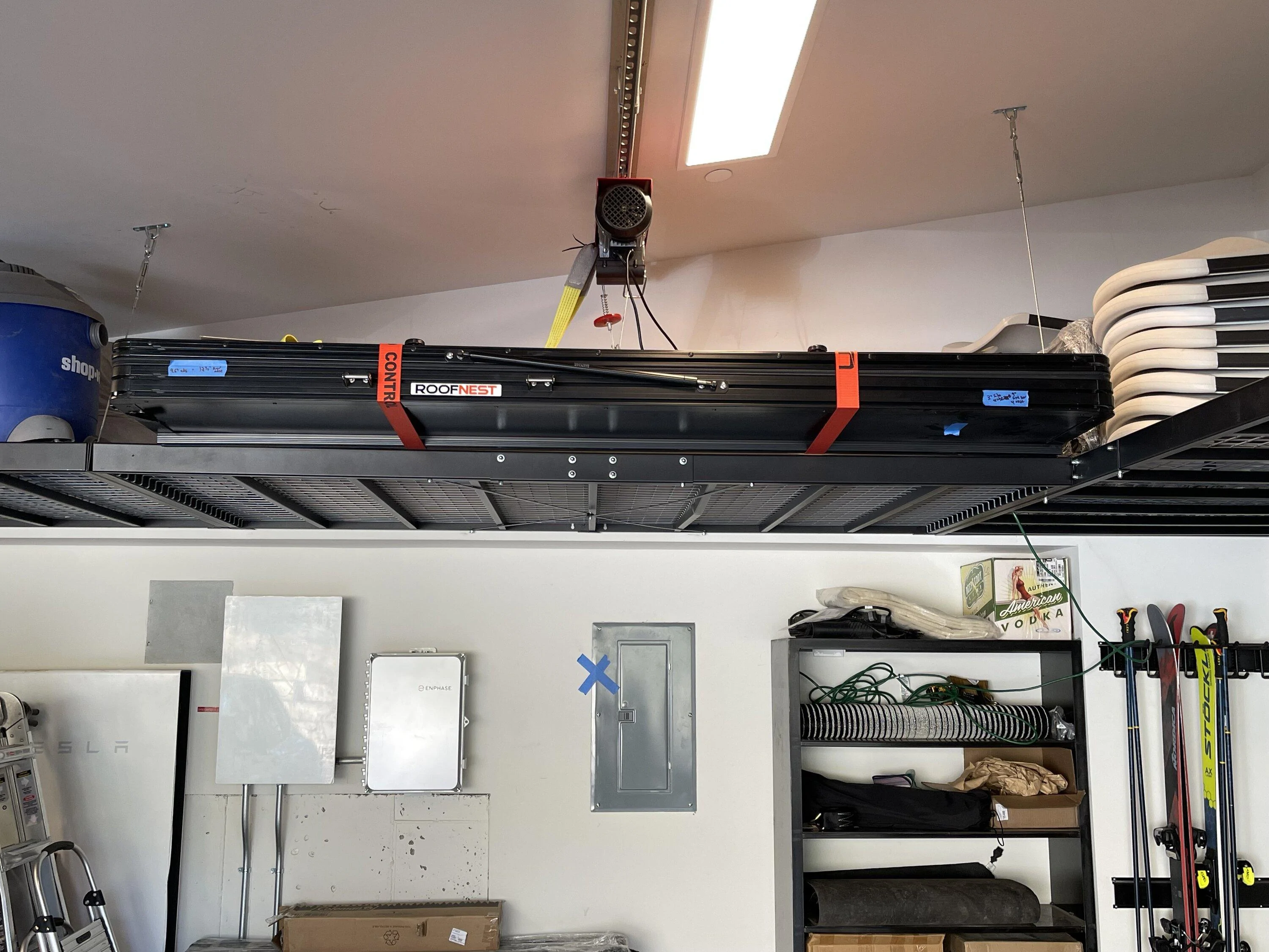

The Falcon is pretty heavy (175 lbs). So, mounting and removing it requires friends. Or, you can geek out like I did and build a trolly winch system! I bought an inexpensive Vevor 440 lb winch and some trolly wheels which I mounted to a 12 foot peice of Unistrut. To secure the RTT to the winch, I bought a pickup truck bed lifter — essentially a heavy duty H-shaped rig made of square steel tubing. The bed lifter sits on top of the RTT. I run 2” ratchet straps through the cross bars of the bed lifter and around (underneath) the RTT.
With this set up I can back into the garage and lower the tent onto the R1S, take off the straps, lift the rigging and drive out with tent. When the season is over, I back into the garage agin, attach the rig, lift the tent off the bars, pull the R1S out of the garage, rotate the tent 90 degrees, and using the trolly, slide it back over the shelving and let it sit there. Pretty sweet!

Unfortunately, I’m back in Texas and (as the photo suggests) the RTT is stored for the winter. Ski racks are next! I’ll take a video next spring. When I mounted it the first time, I took a while (and had 2 friends there to help). When I removed it and stored it last week, it was just me and my wife. I could do it alone but I had her there to help guide it past the cables that hold up the shelves.
The trolly system is cool. I had to set up the winch with the pulley hook because that helped center the load laterally on the winch. Without the pulley hook, the cable hangs on one side and the load causes the winch to list/torque on the track which makes it a lot harder to slide with a load. With the pulley hook and the load centered, it slides pretty easily. I am very happy with the results.
