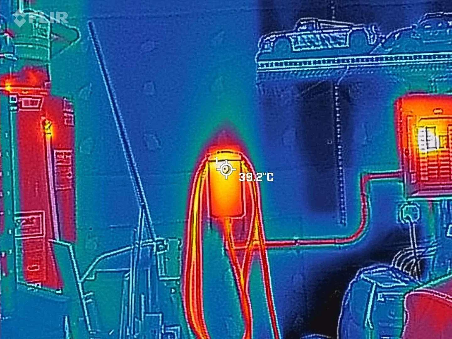

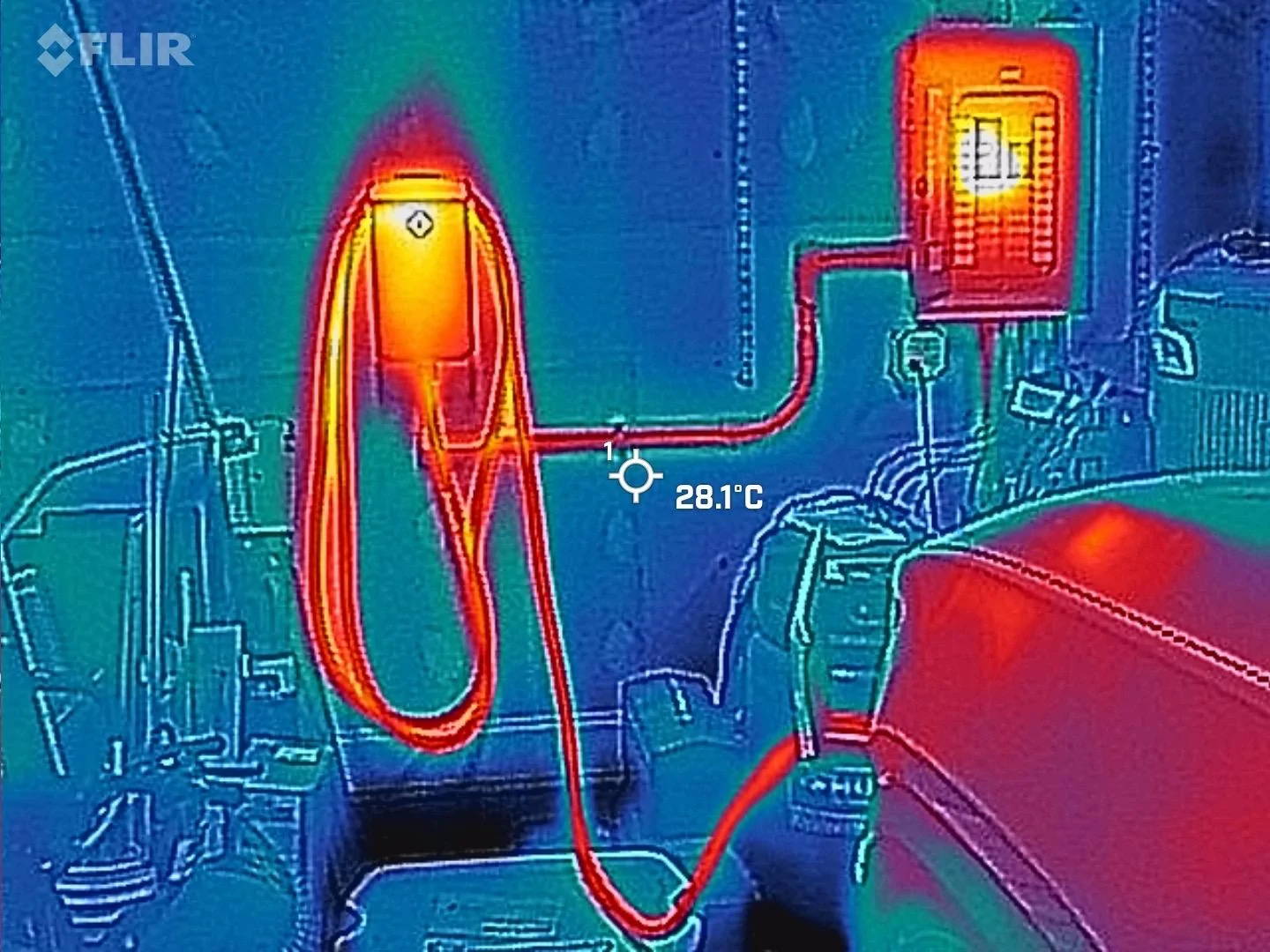

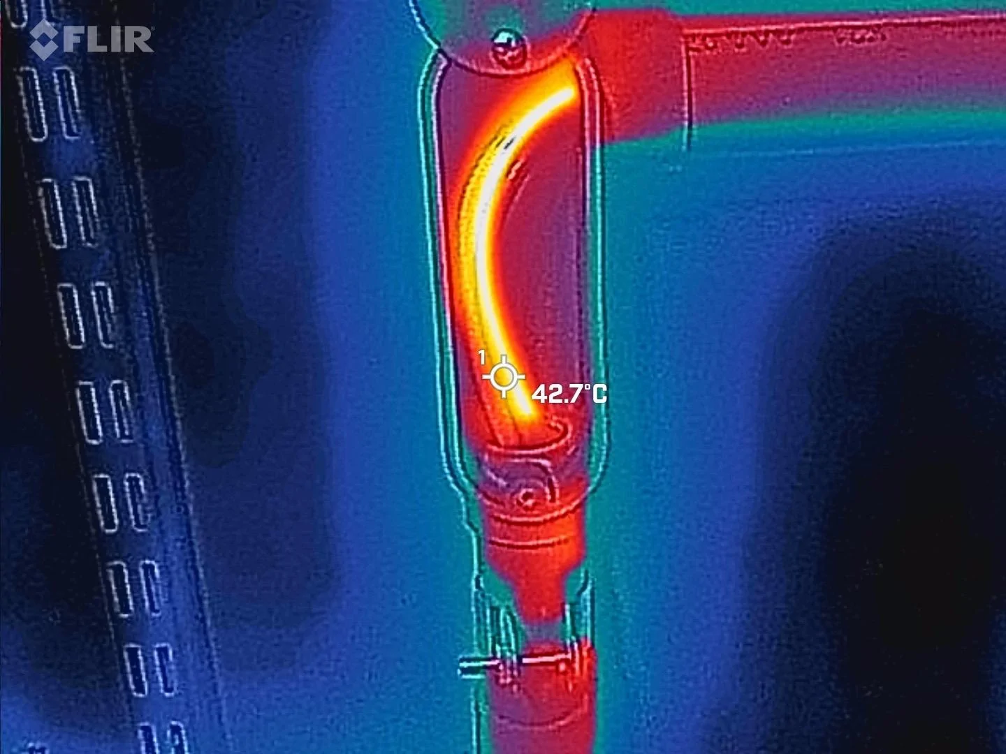

Picked up my R1S on Monday in Richmond VA and drove it to Raleigh NC.
I got all wrapped around the axle on the charger install, going back and forth on wire gauge, conduit size etc…
in the end I installed a 90A sub panel in the garage with a 60A breaker for the charger. I ran 6ga wire from the breaker to the charger in 1” PVC sch 40 conduit.

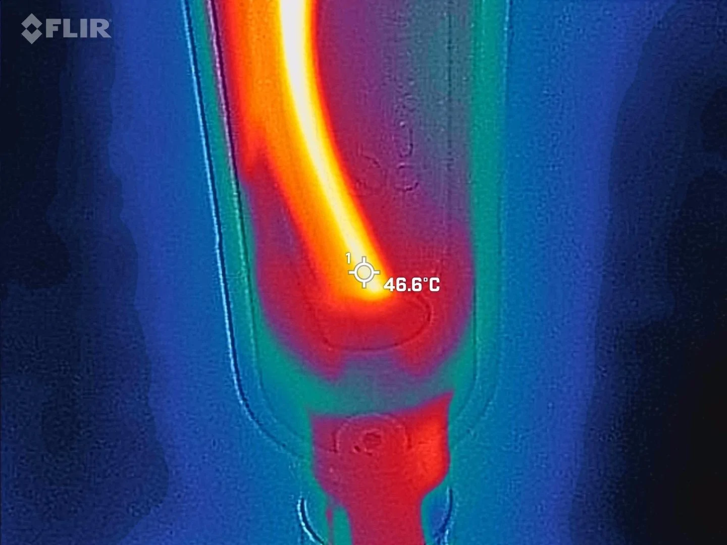

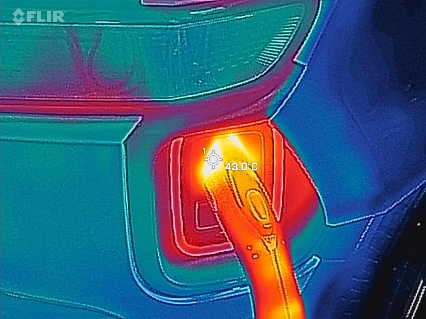

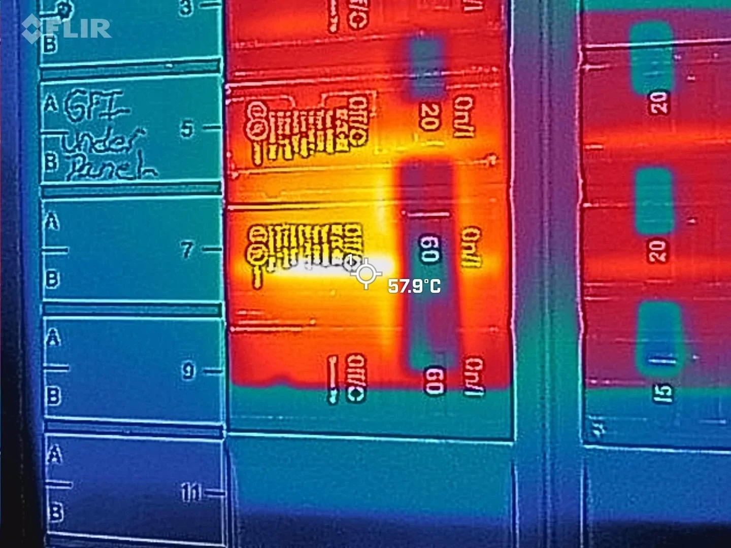

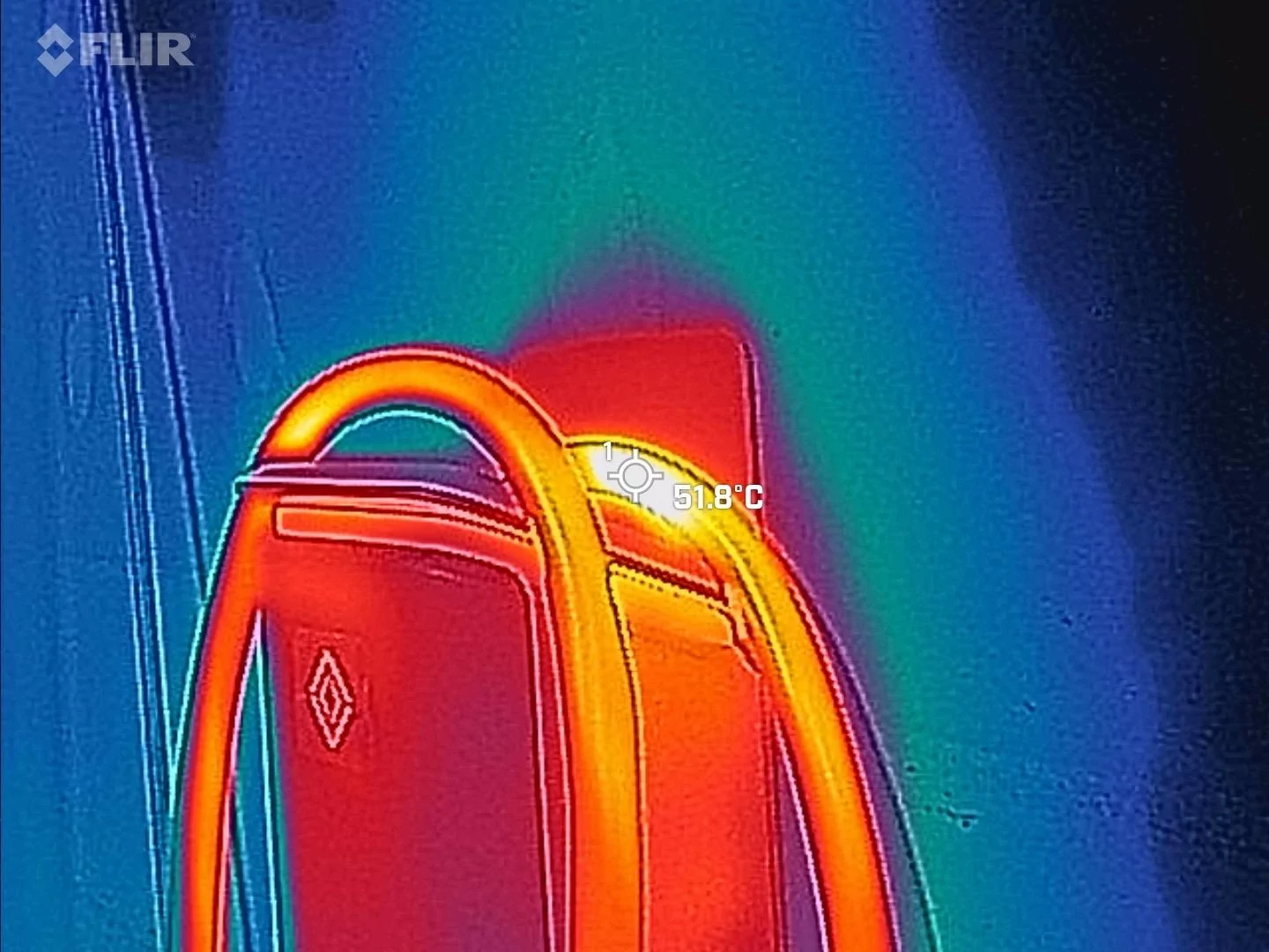

I decided to take some pictures with my thermal camera to see what the temps of the system are looking like. It was 78 F in my garage and I had been charging at 11.5 kWh for 3 hours prior to taking the photos (was still charging during the photos).
These pics look scarier than they actually are as the camera auto-ranges for the temps in the picture...
The 6 GA wire temps were only mid to high 40’s C, but the charger cable was closer to mid 50’s C where the two coils were touching on top of the charger.
anyway, this makes me feel better about the install, hopefully you guys find this interesting.

I'd double check the tightness of the terminals on the breaker since the heat looks slightly unbalanced. Could just be a trick because the visible light overlay is offset quite a bit though. I try not to take photos this close with mine when I am showing both things.
Justin
Aug 25, 2023
152
243
NC
'23 R1S QM Adventure, UnderShield, Megawatt sliders, and 20" Darks
so i just torqued both ends of the 6 ga.
The charger was ok (12 in-lb) the breaker bottom lug was ok, but the top lug was maybe 1/8th turn more to get back to the spec of 27 in-lb (stated on the side of the breaker).
I'll take another picture next week when I charge again to see if it is more even.
