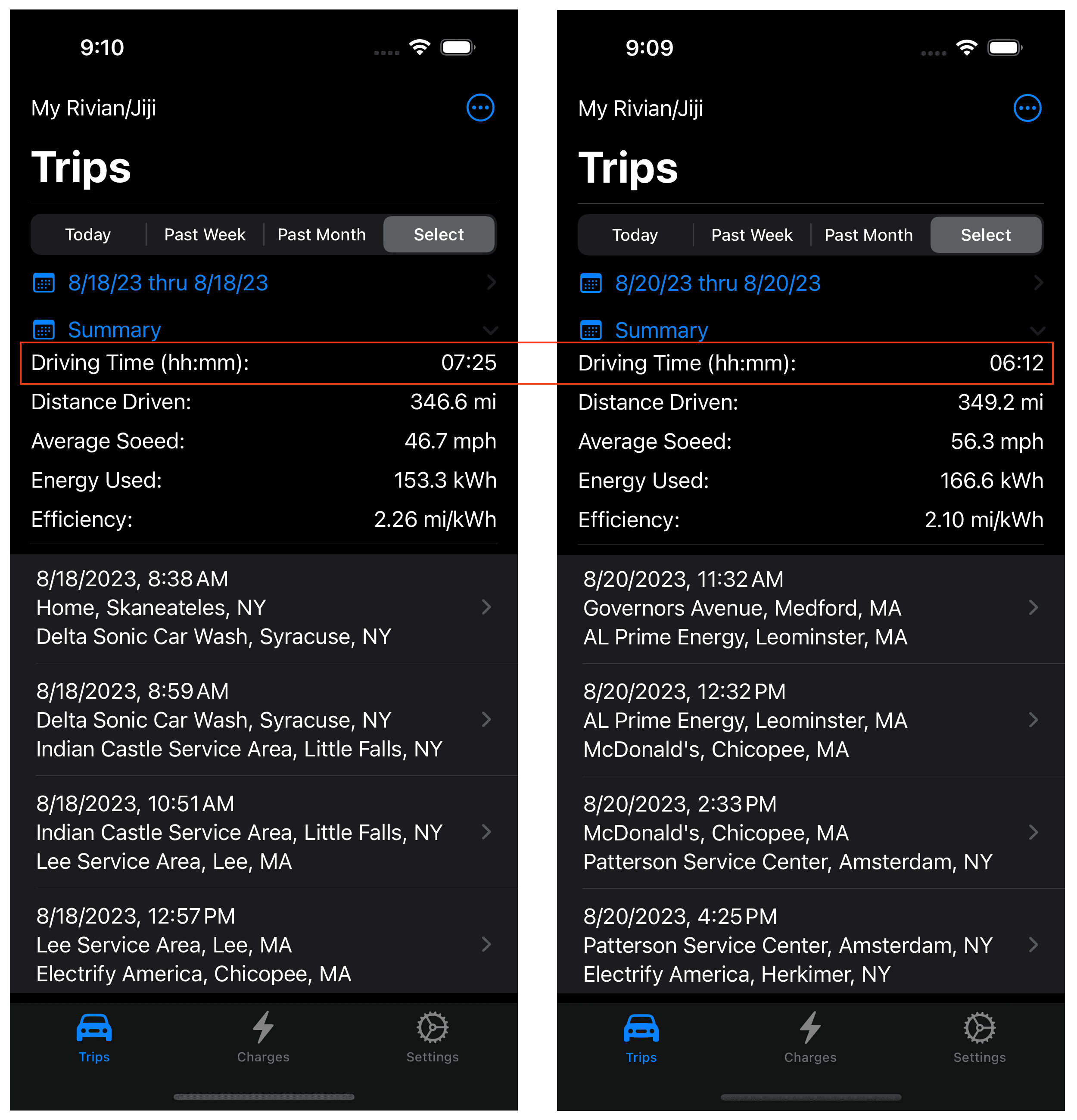

This past weekend I drove to Boston from Central NY and got to collect some data for my Rivian road-tripping, fast charging app. Here is a summary of the outbound and return legs as recorded by my iOS app:
Rivian R1T R1S Boston Road Trip in R1S 1692666693958
For some reason traffic was especially heavy in the Bay State and when the construction zones were present it really bogged down. On the return trip I avoided the Mass Pike in the Boston area and saved over an hour travel time and the much higher average speed is reflected in the energy consumed returning to NY.

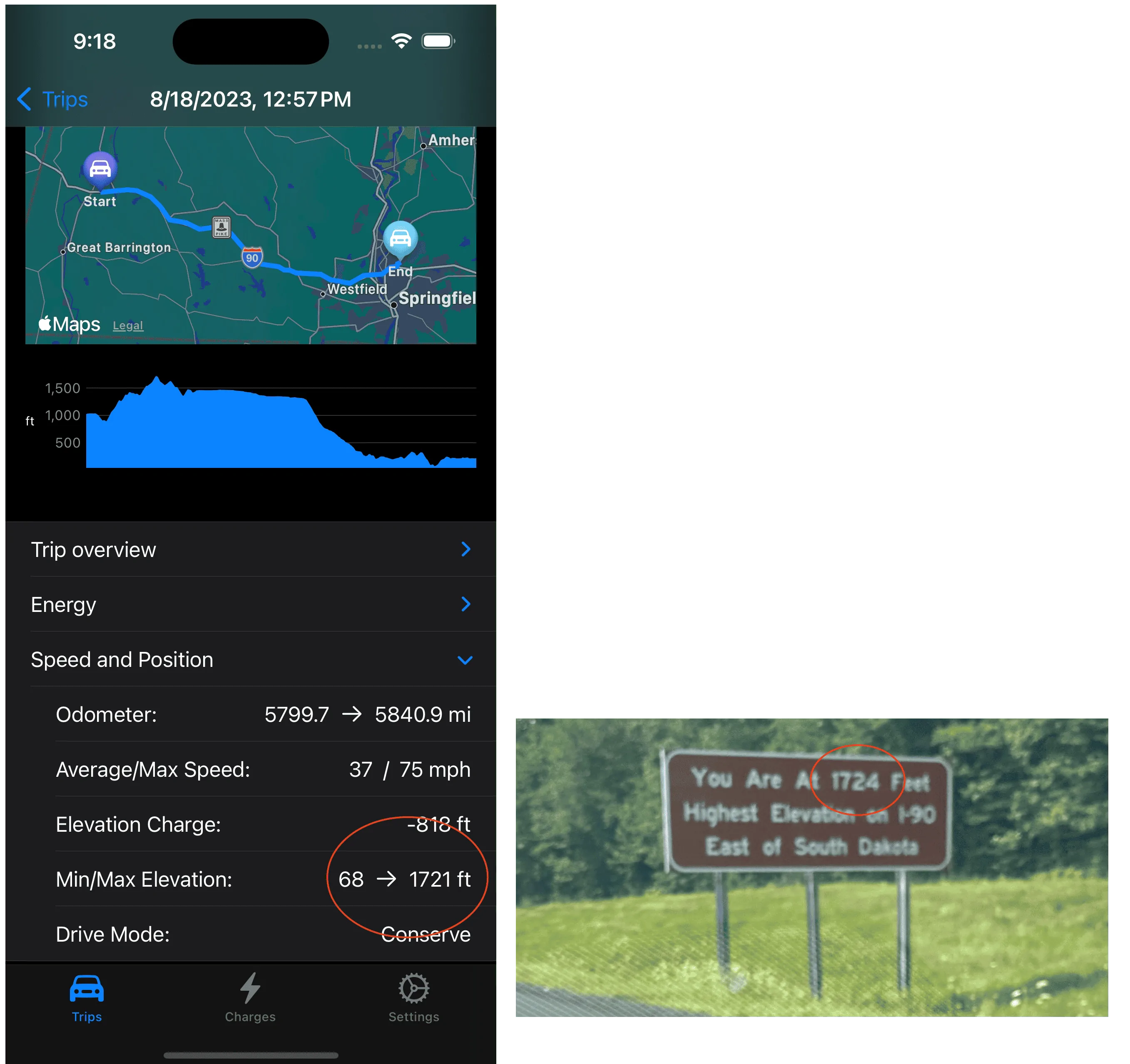

Here is a detailed view of the trip from the Lee Service Area to Electrify America in Chicopee, this leg includes the highest elevation on the trip (1724') and I wanted to capture it for software testing purposes, looks like I do OK using the iPhone for the GPS data with just a meter discrepancy:
Rivian R1T R1S Boston Road Trip in R1S 1692667470705
Oops, that is embarrassing but I just fixed that typo while proofreading the post. You see I record the drive mode and wish I could log the tire pressures but the Rivian API only reports "OK" and not an actual tire pressure.:(

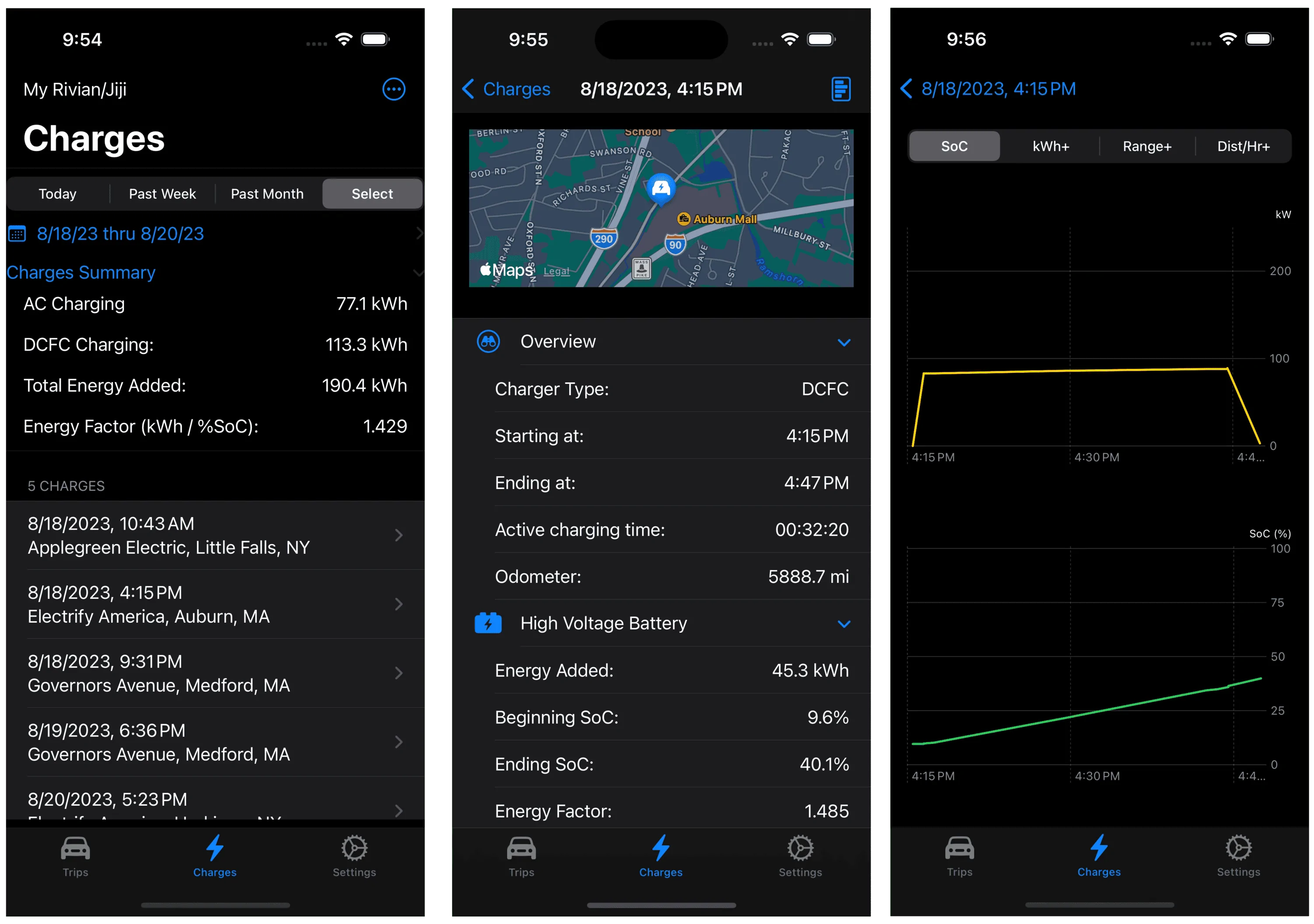

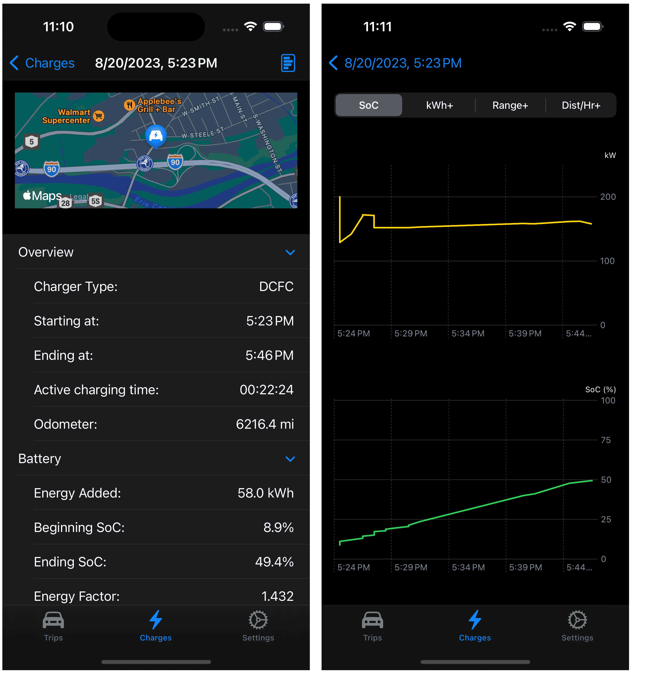

Of course it is nice to also keep track of the charging sessions during the weekend, luckily I had access to an L2 charger at the destination so just one stop each way to DCFC charge. As you can see in the charging curve on the right, EA didn't do me any favors even with arriving with less than 10% SoC but these were 150kW max and I only needed to add a few miles to get to our Boston destination:
Rivian R1T R1S Boston Road Trip in R1S 1692669429128
I'll hope you can figure out the summary and I'll explain the Energy Factor. This is the number of kWh per unit change in the State of Charge (SoC) and is how I estimate the efficiency. The Rivian API does not share the energy used but a charge session does and I can read the beginning and ending SoC and is "good enough". So on this weekend road trip, the Energy Factor was 1.429 kWh per SoC percentage, this would reflect 14.29 kWh for a 10% change in the SoC.
While not perfect is does include all energy replaced and includes any losses in the process (charging inefficiencies, preconditioing, etc) so I am happy with it until I can come up with a better estimate. I have tried using trip odometer and while the values for a single trip might be valid over the course of a few days the reported total energy used and efficiency diverge so who knows what is being included plus I don't have the time or desire to manually log the trip odometer every time I get in my Rivian.
So there you have it, 700+ miles over three days with lots of data to satisfy my need to see what the Rivian is up to.

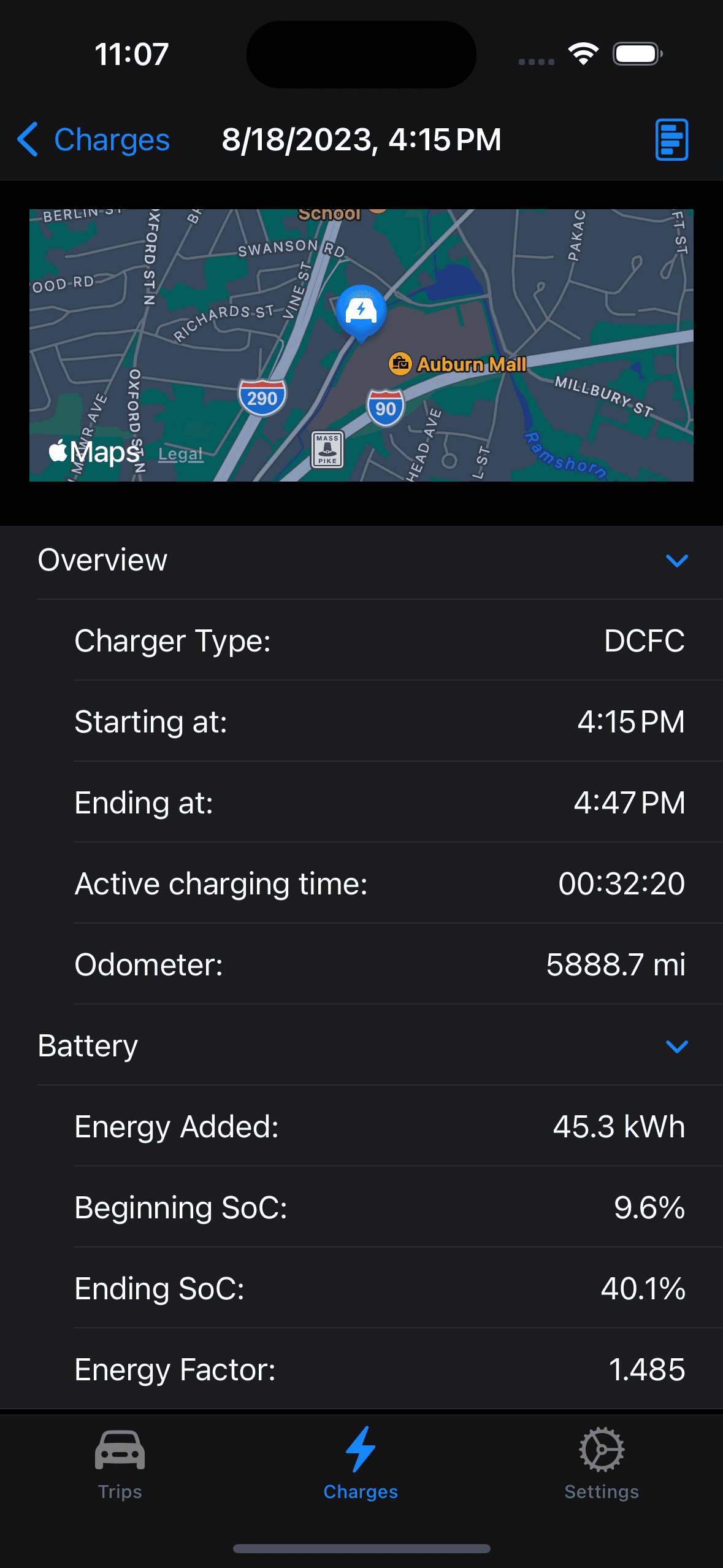

I charged once each way, stopped at EA in Chicopee (the last 350kW chargers in MA) but was 4th in line so left for the EA in Auburn and charged there for just over 30 minutes which added 45 kWh, more than enough to get to Medford.

Return trip is easier since there are many more charging options in NY including Tesla in Verona or the free 50kW chargers at the Mohawk Valley Welcome Center on the Thruway. I hit the EA in Herkimer to top up for the home stretch and got a charge error in the EA app but noticed the vehicle was charging so it ended up being free. If I didn't have two little kids in the car I would have stayed longer for the free kWh but they got some ice cream and we were out of there in just over 20 minutes.
