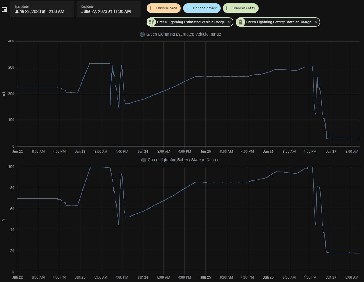

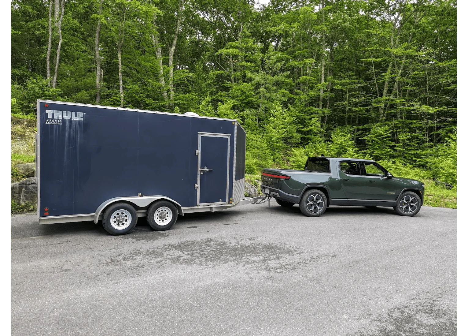

I tow to motorcycle race tracks a lot during the spring/summer/fall. The longest tow I make is to New York Safety Track in Jefferson NY near Oneonta NY from North Central MA, right on the NH border. This time, I had HA running capturing data from my trip.
Rivian R1T R1S Enclosed trailer towing with R1T -- two identical trips, one year apart Rivian_Trip_HA.PNG
Shows me going up over the Green Mountains in VT, then stopping in Albany to charge with 45% remaining. Last year, this same trip, same truck, same trailer, same loadout (approx 5-6klbs), I arrived at the charger with 19% remaining. Only difference was me not running AC this time, software updates, and a year old truck vs a week old truck. I charged at the track using a TTR-30 outlet with adaptor, waiting until the last day to go all the way to 100%. On the way home, was in torrential downpours the entire ride, so that likely ate up a ton of energy.

I did not have the newest ABRP enabled update on the truck for this trip. It would of been interesting to test out the live data aspect of it as well, but I still haven't had any luck getting my data from HA to ABRP.

Sorry my ignorance, what is HA and how does it work/connect to the truck for getting this data?

HA = Home Assistant, there is a thread on this forum about getting it working with the Rivian API to log/track your data. That part is easy, getting to ABRP is the hard part (for me).
