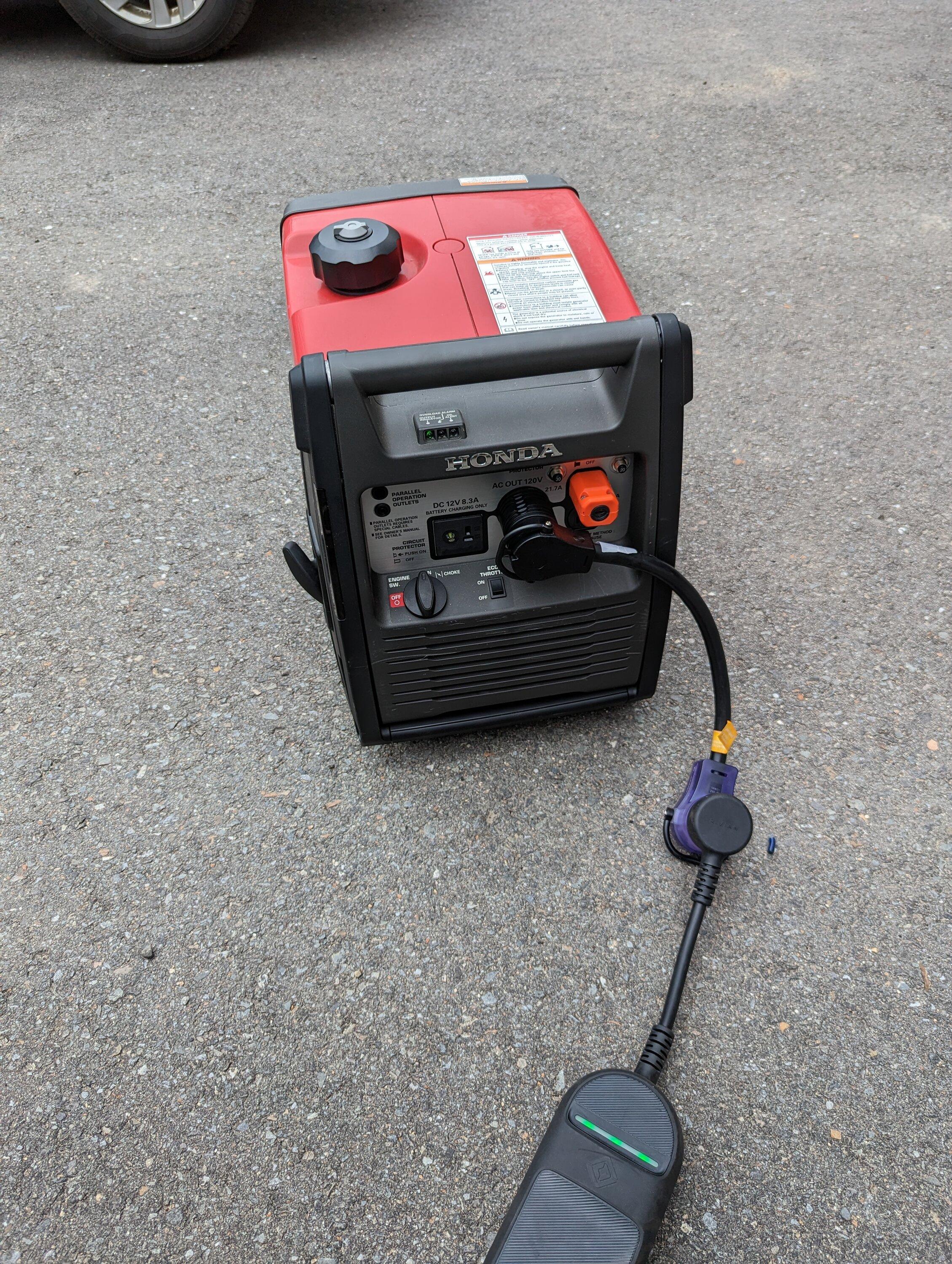

I had purchased all the necessary adaptors to get my Honda EU300i connected to my truck for charging, so I figured I'd try it out before I actually needed to use it.
Hooked up the NEMA L5-30P to TT-30R adaptor to the generator, then plugged that into the TT-30P to NEMA 14-50R adaptor, then plugged in the Rivian portable charger using the NEMA 14-50P connector.
Fired up the generator and eventually the lights on the Rivian charger started pulsing red, indicating an error. Assumed it was a ground issue. Tried making my own grounding cable which I staked into the ground and tied to the ground lug on the generator; still no love.
Found reference on this forum to a neutral-ground bonding plug. Sure enough, others say that my generator, along with a lot of inverter generators, use a floating ground. The solution is to use a neutral-ground bonding plug.
Looked up what that was and made one in about 1 minute. It's that easy. Just take a normal 120v/15a plug and jumper between the neutral leg and the ground. That's it. Can make one yourself from a cut electrical cord with the white/ground wire nutted together (hacky and potentially unsafe if you aren't confident in which wire is what, easily tested using a multimeter/test light though), or use a replacement plug that opens with screw/clamp style terminals like this with a 1" piece of 12ga wire jumpered between the neutral and ground. I opted for the second method since I had a 120v/15a plug on the end of a custom extension cord I wasn't using anymore.

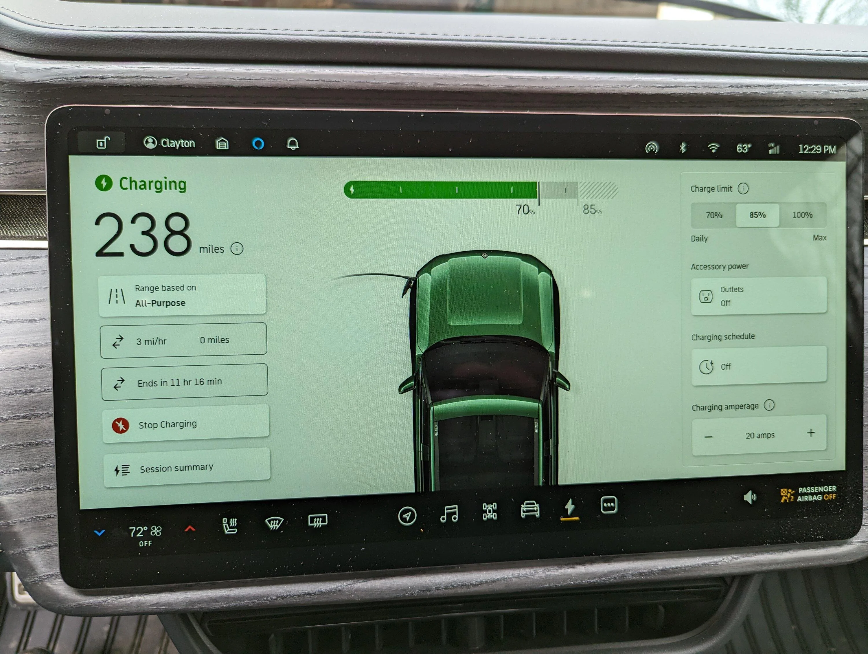

Plugged that in to one of the 15amp outlets on the generator, fired it up, and BOOM, white light on the Rivian charger. The bonding plug is the orange plug with no wire plugged into the generator in the photo. Plugged it into the truck, set the charging amps to 20 (max on my gen outlet is 21.7amps) and she was charging like a champ. I was able to sneak it up to 22 amps and nothing complained. I was teetering between 3 and 4 mi/hr of charging, 3kw, which is completely expected.
