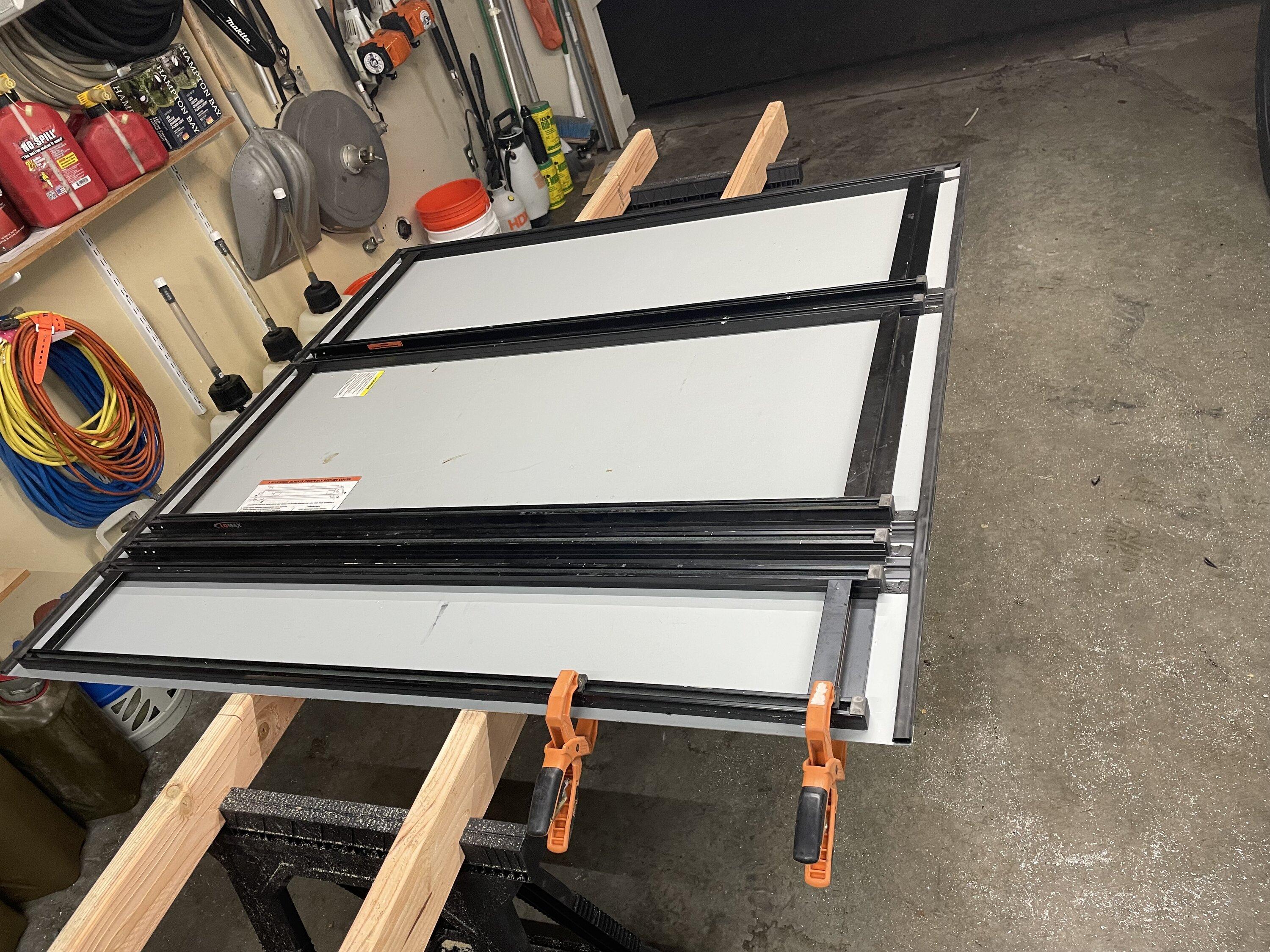

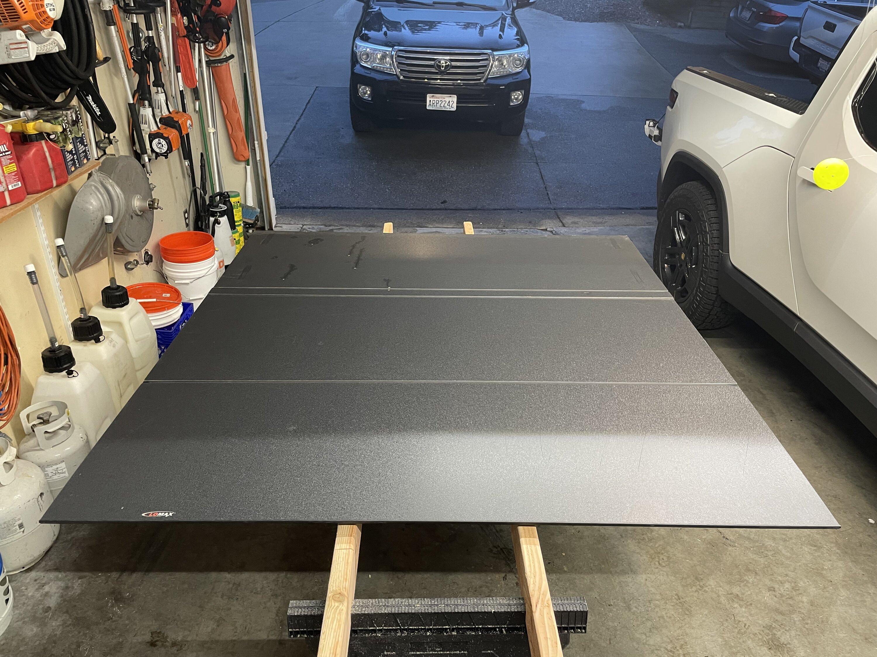

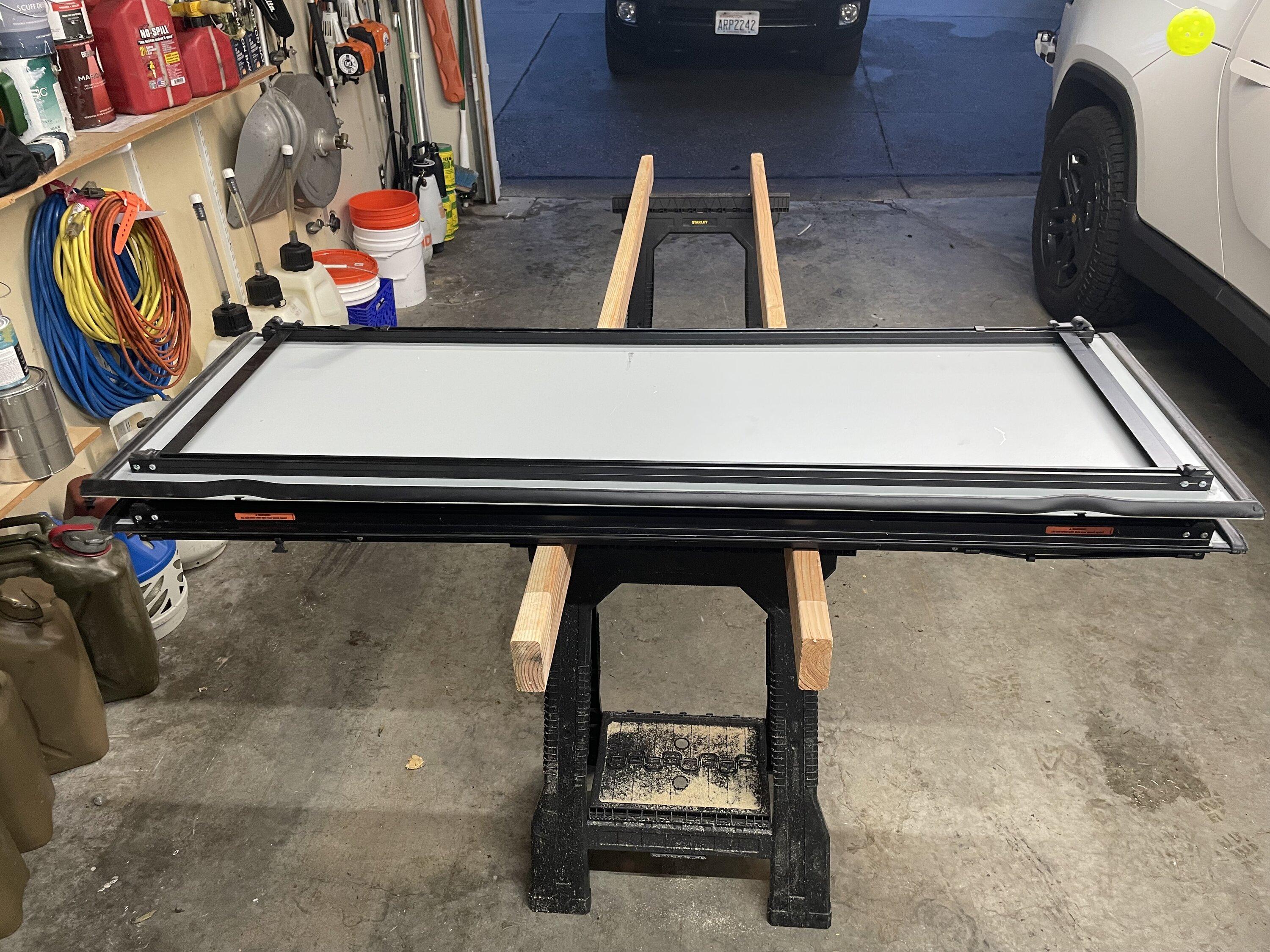

I thought I would share this for ideas even though it probably isn't useful to most owners because:
1. My R1T was delivered last month with NO tonneau cover.
2. I had a Lomax tri fold low profile tonneau from my 2019 Raptor that got totaled several years ago.
The cover was pretty scratched up and I figured that whatever it would fetch on Craigslist would probably be less than the Rivian manual one costs. When I originally ordered the manual Rivian cover I figured it was like the powered one but with no power. Pretty disappointed that it sounds like it is four individual pieces. Pretty archaic. This will hopefully get me by until there are some more options.

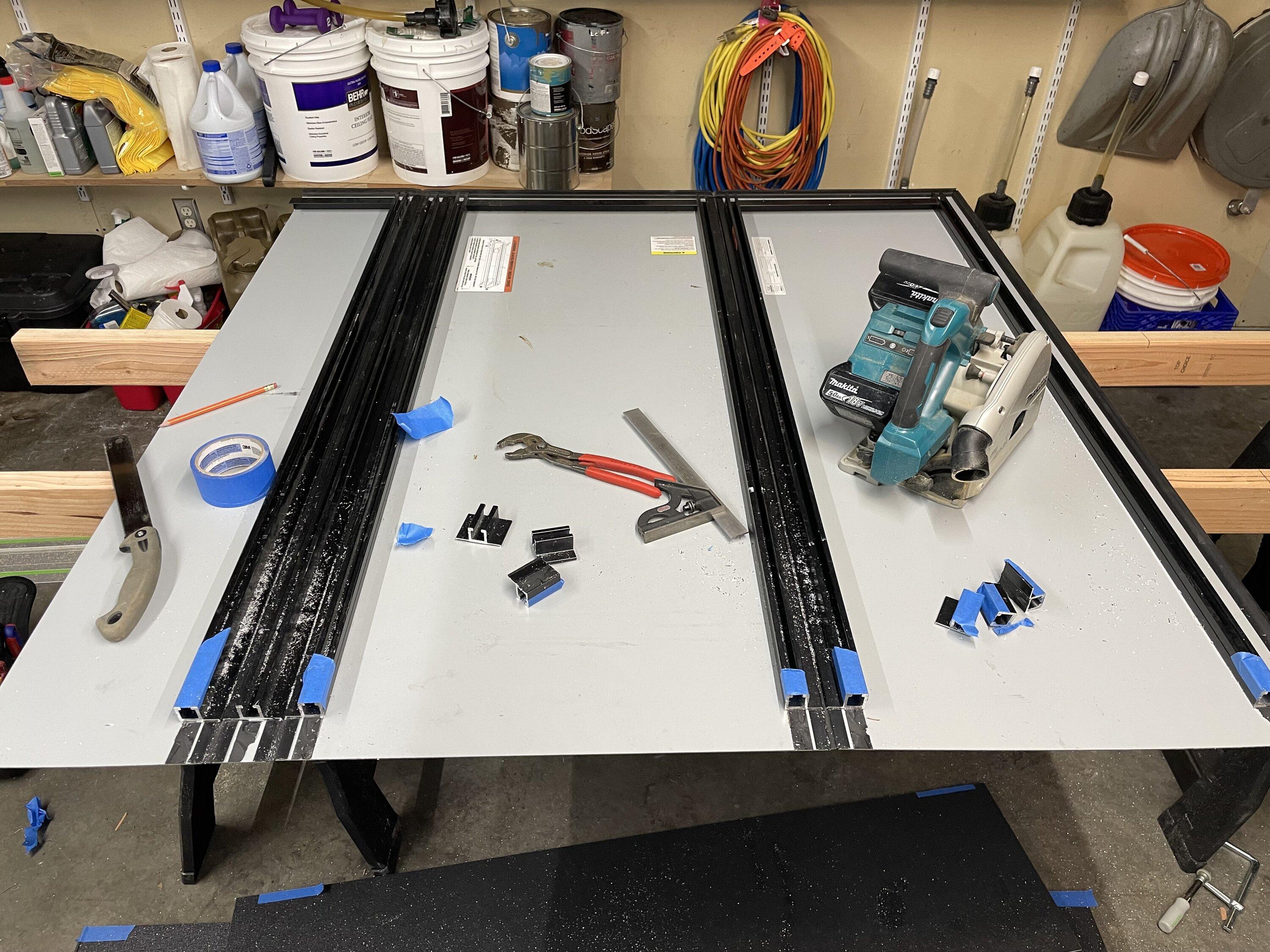

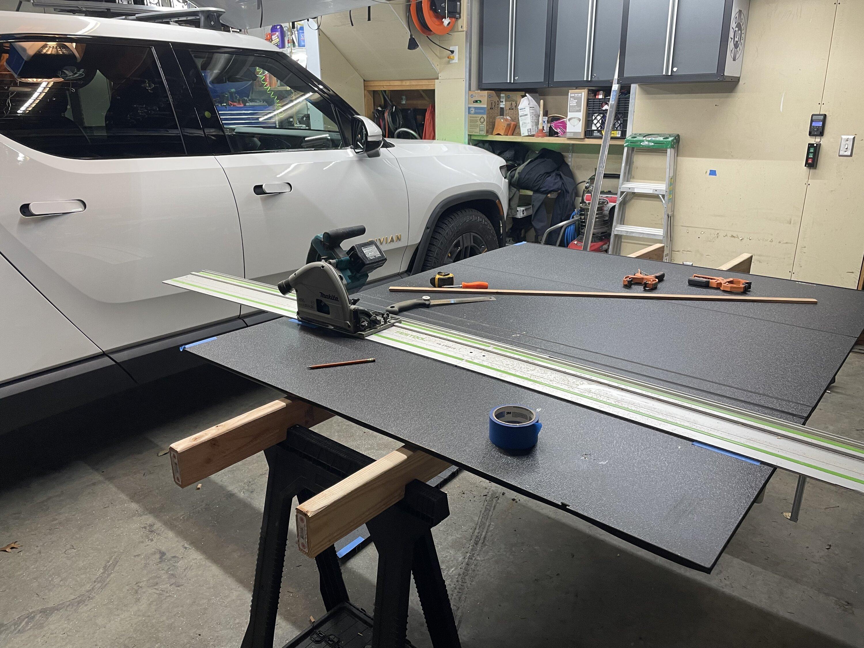

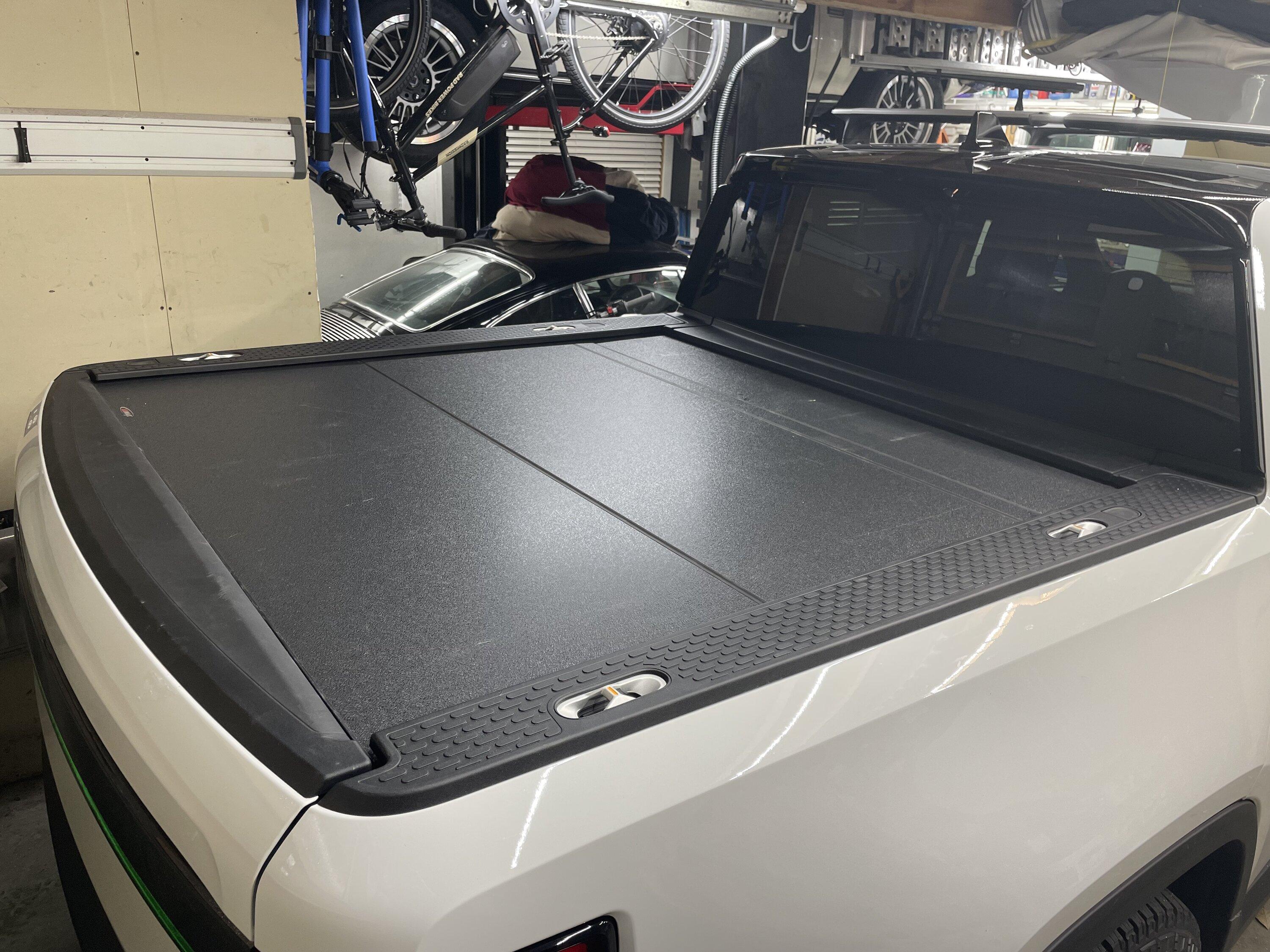

Basically I made the panels narrower and shortened the panel closest to the cab to shorten it from 5.5' to the 4.5'. The panels and bracing underneath are made of aluminum and joined with double stick tape.

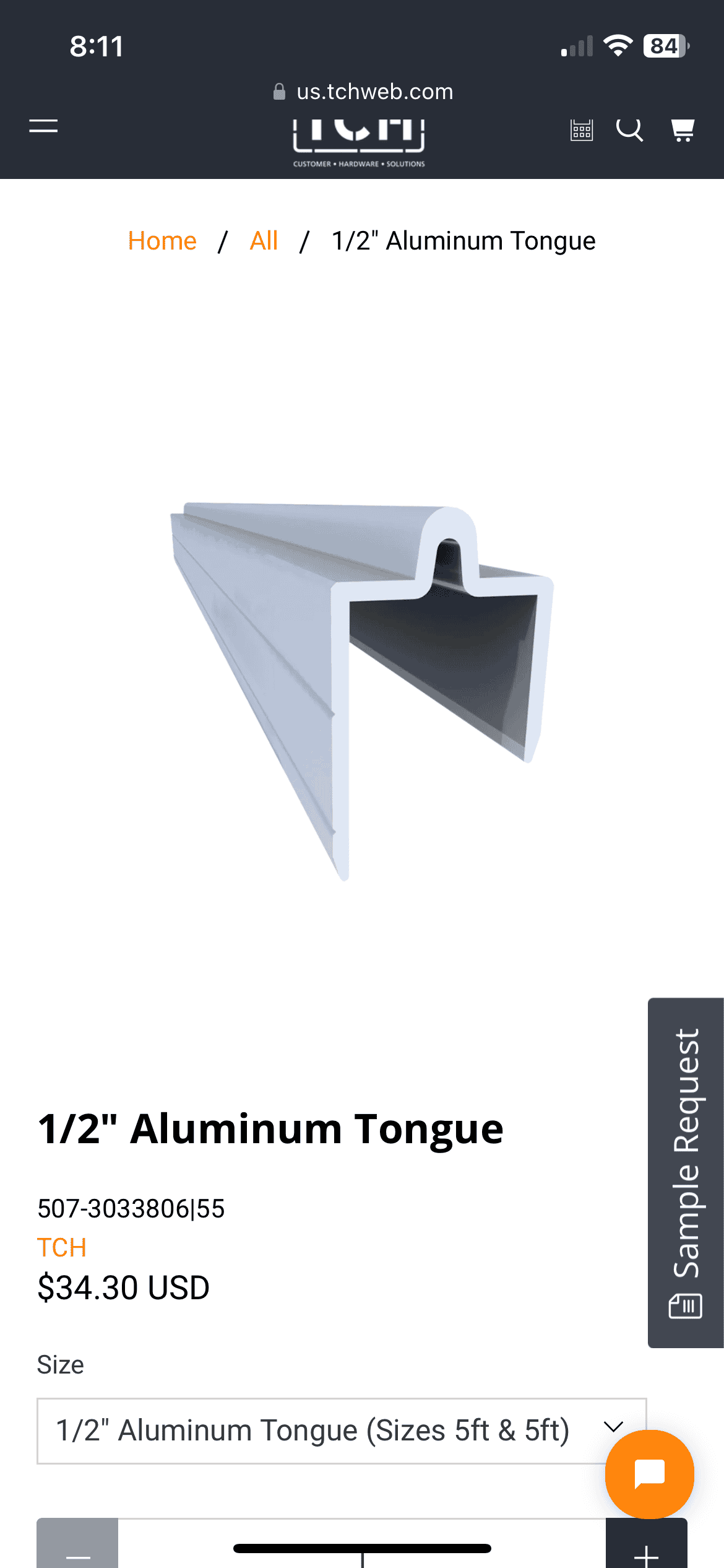

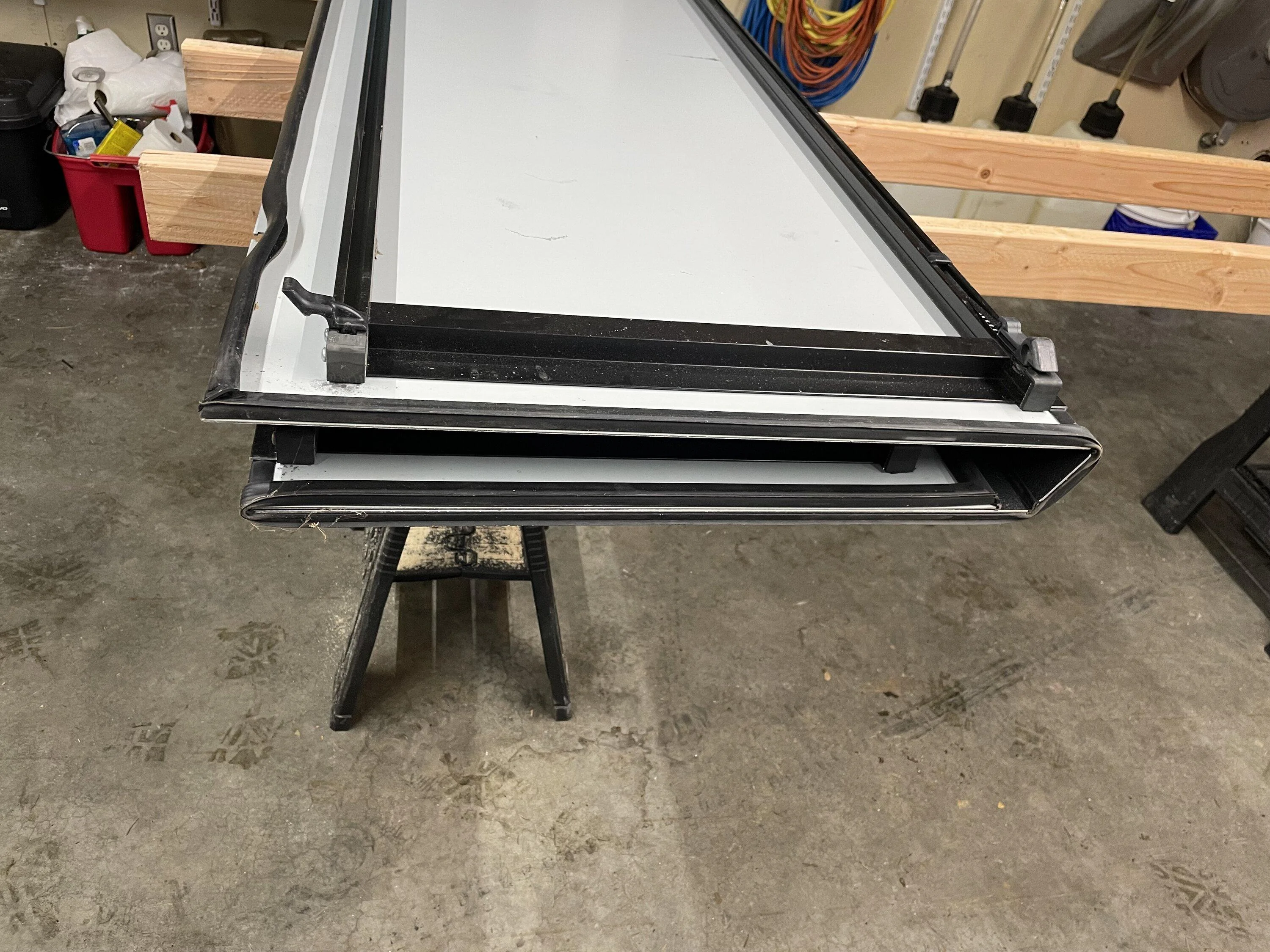

It turned out great and fits well. The seal on the old cover is on the bottom which keeps it from sliding very freely in the channel and the overall thickness of the cover and seal is a bit thinner than the track. I may put the seal on top of the cover and add some kind of HDPE strips to the bottom to shim it up and make it slide in easier.
Having the panels joined together should seal well but also makes it a bit more cumbersome to install than the Rivian design separate panels.

This looks good actually, if you can seal it enough I Do not see a reason for Rivian's Cover, the only idea behind the 4 separate panels are to store them in the Tunnel .... I would have used that the last few days where it was raining none stop in SoCal.. :)..
a side note, That table next to your Truck and the metal ruler is giving me a heart attack.. lol

Well done man. Did you apply anything to the cut edges or just dremel them down smooth?
broc
Nov 7, 2022
59
seattle
Thanks! Maverick one may fit without any modification if it was thin enough at the edges and had just the right dimensions. Unlikely but you never know. Bakflip mx4 look like the right design but it would have to be the perfect size. All of the hard tonneaus are about $1K so the rivian option probably makes more sense......if it ever arrives. Wish they would just do a tambour style cover. Those work great and it seems like there is enough room for the spool above the gear tunnel.

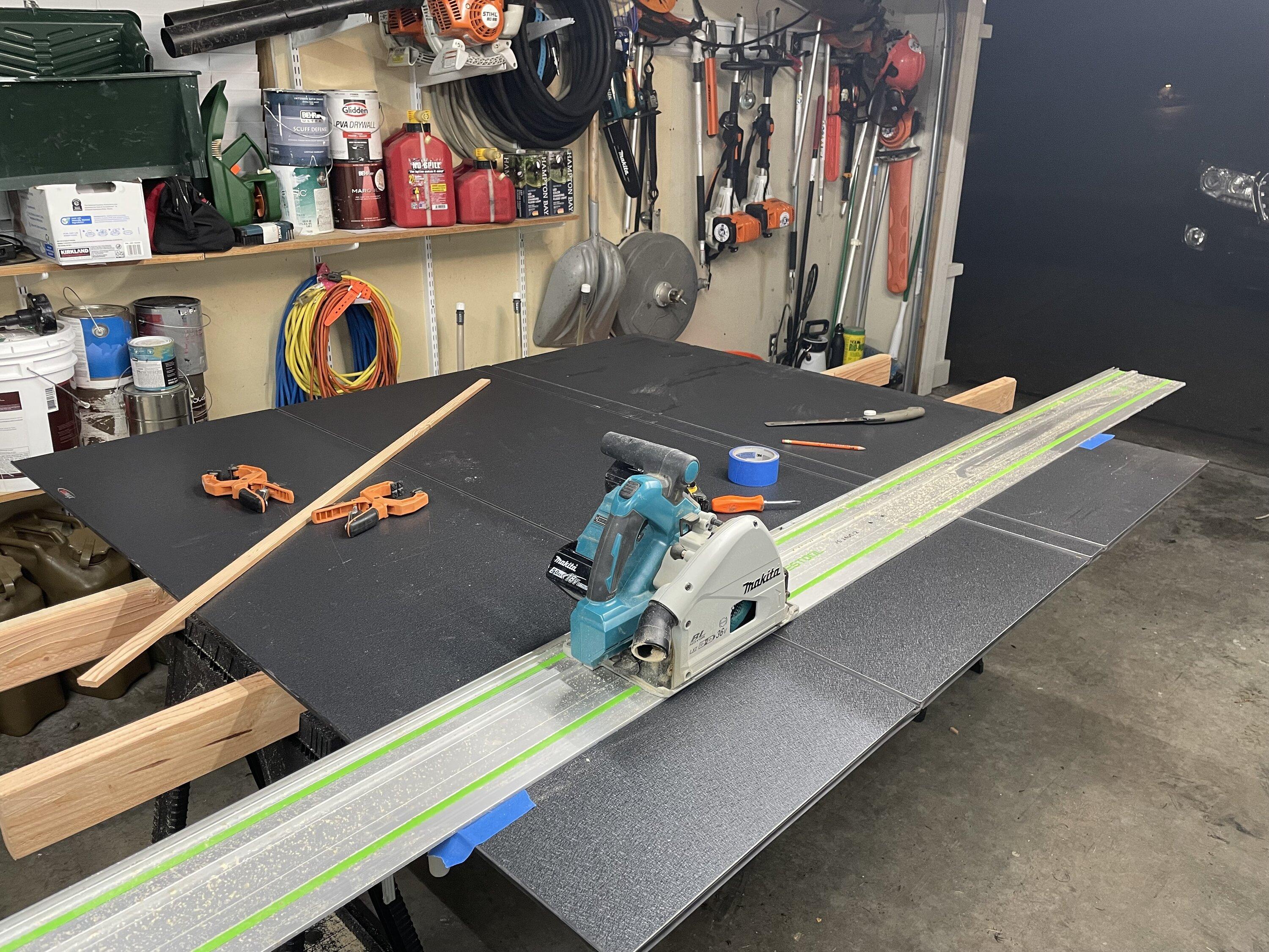

On cutting aluminum, no need to smooth edges. Track saws (Festool or Makita)cut so well they leave what looks like a machined edge. Awesome tool to have.

Looks OEM!!! Great job repurposing a used Lomax hard tonneau cover.
I had the exact same Lomax cover on my Tacoma and sold it before I got rid of the vehicle. It may have worked on my R1T with some modifications similar to yours.
I’m going to kick myself for selling it if the upcoming Rivian bed slats are $1800.

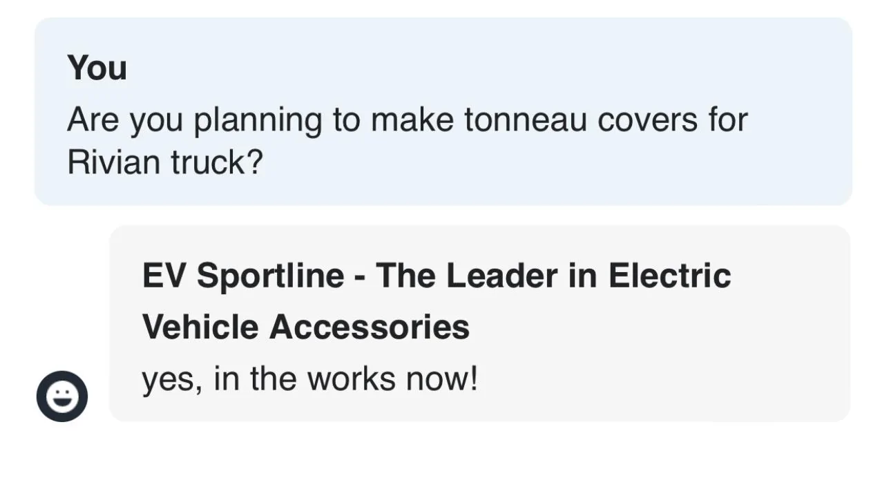

I sent this question to EV Sportline yesterday
