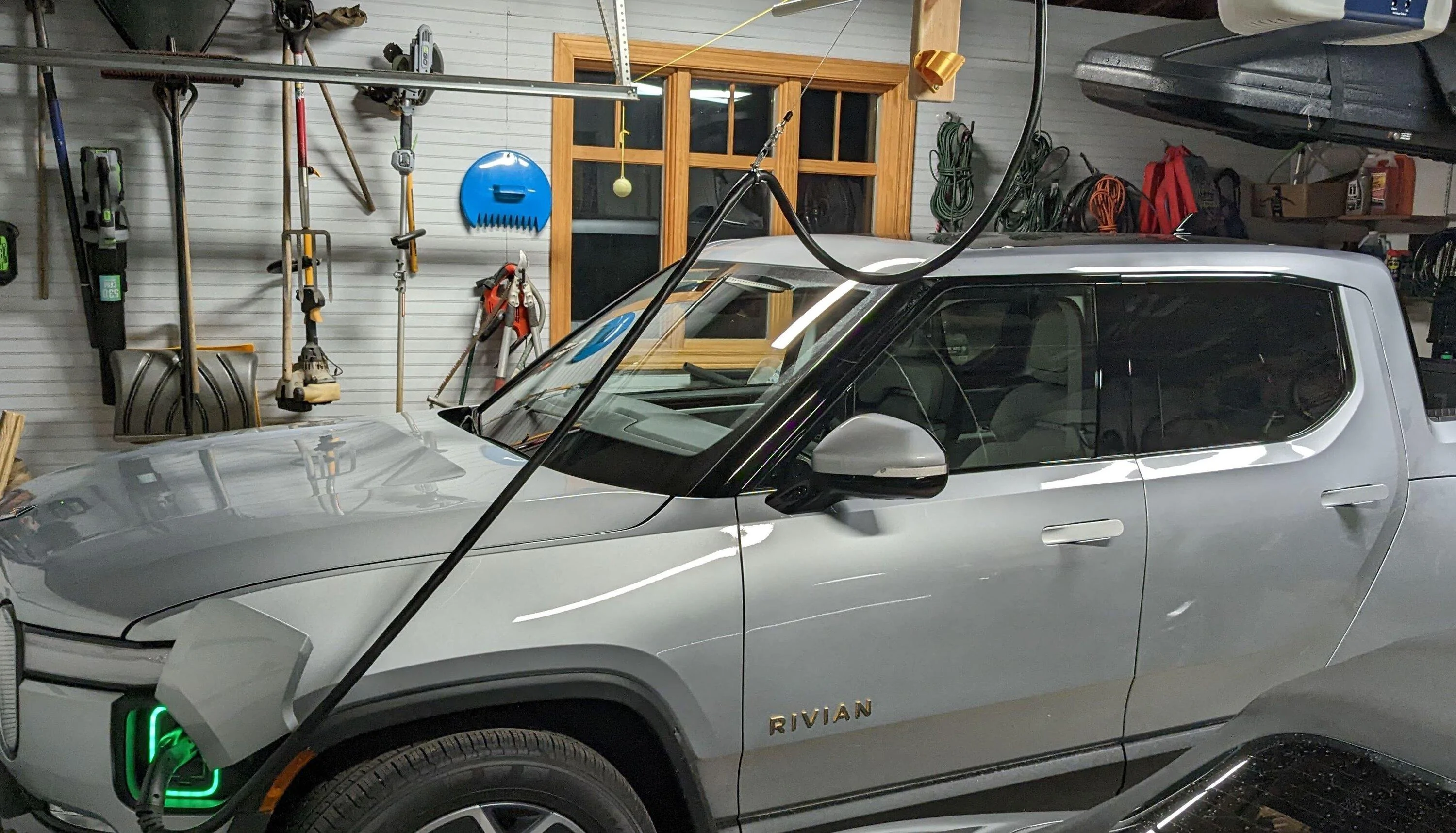

I hated the idea of a long cable running along my garage floor and it was compounded by the fact I wanted/needed to back my Rivian into the garage (charge port on front left). Came up with a solution where I had my Rivian Level 2 charger mounted in the ceiling and used a $55 Tool Balancer to let me pull it down and then back up to store it out of the way.
Everyone has a little different layout, but I made this video to offer the next person some ideas.

I might want to do that. Mine drags on the ground now and the truck brings in all sorts of dirt and rocks. I can see that messing up my cord over time.

I have the same problem as when I built my house I had my outlet installed where it would be setup for Tesla charging (left rear corner) but ended up with a Rivian. So now my cable drags along the floor and it a pain to manage with all my bicycles, etc.
Thanks for sharing your solution.

Yup, I thought about that too... new vehicle with different connector locations messes up the whole setup. That was another plus once I found a Tool balancer with a 6 ft cable, it allowed me to put the level 2 charger basically in the middle of my garage ceiling. I have some flexibility now to move to all 4 corners.

Did you look for a "tool balancer" that locks in place? Like window blinds that you pull down to lock in place and then pull again to retract?

If you are referring to air compressor hose style reels where you give a tug and they lock in place, I looked for that option but found none. The Level 2 cord is to heavy gauge to easily wind around a compressor style wheel. Tool Balancer with same type of behavior didn't seem to exist... at least not until you start spending $500, $1000 or even more for the really fancy stuff. I spent $55. If you find a cool alternative, absolutely post it. ?

From a earlier post; RF1918 was able to achieve a locking retractable charger setup using:
Tigon TW-1R Retractor, Spring/Tool Balancer (Load Capacity: 0.5-1.5 kg/1.1-3.3 lbs) Adjustable cable stopper
https://a.co/d/hO3nzY1
https://www.rivianforums.com/forum/...2-home-charger-installs-here.7940/post-199424
edit: maybe not locking, but adjusted to equilibrium with the charge handle. Doesn't look like there is any tension in the photo where its plugged in to the vehicle.
