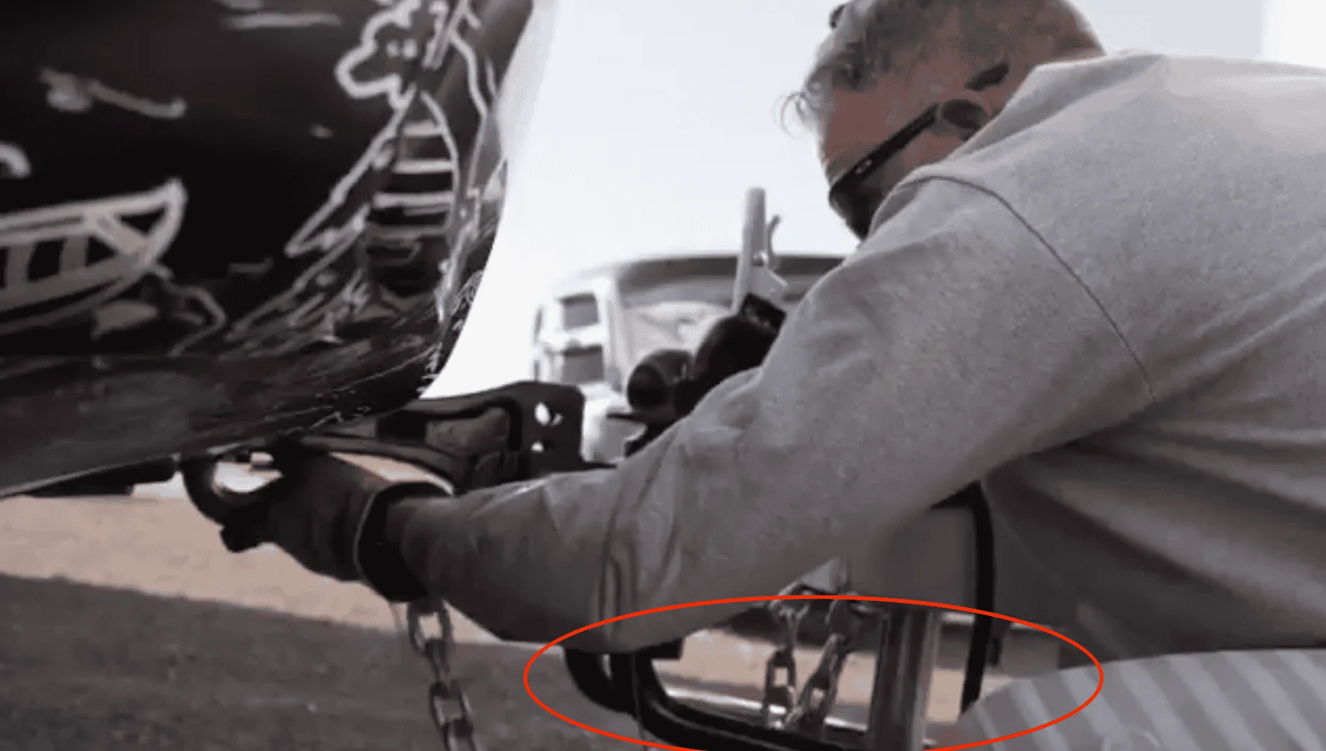

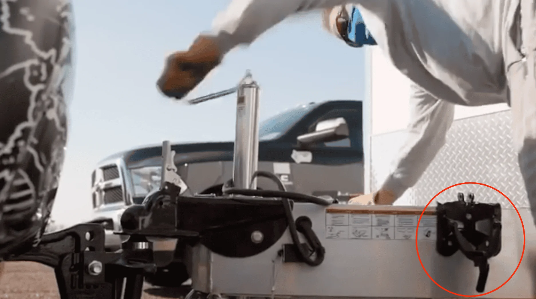

I downloaded the video (attached here) since Instagram doesn't seem to allow you to scrub. I was trying to scrub back and forth on the hitch section to see what kind of hitch they were using and whether they were using weight distribution. It appears they are using weight distribution bars, but the section showing that portion is short and filmed at a relatively tight angle.
I've circled what appear to be the bars and the connections on the trailer A-frame for the bars.

You might have had your audio off, but the first thing he says in the video is "I am attaching a weight distribution hitch."
A lot of people think you don't need a weight distribution hitch with leveling airbags, but that is not true at all. Leveling the vehicle does almost nothing for stability and steering control. A weight distribution hitch will both help to level the load and puts more weigh on the steer axle.
Personally, I am a big fan of Hensley style hitches. I have one on my travel travel I pull with a Transit van. It completely eliminates all sway.

Boy, I’d make the worst CSI detective!
“I see some possible DNA under the handle of this dresser!”
“Sir, the killer confessed a week ago.”
I totally agree on WD. And I also like the Hensley style hitches but they add a lot of tongue weight so I’ve towed with a friction sway solution to date.
It is about 70 pounds more than a friction hitch with bars. My Transit 250 van rides perfectly level ones I cinch up the bars.
My Model X tongue weight limit is 500 lbs, and I'm already close with my Airstream when it's loaded, plus the Equal-i-zer hitch. When/if I get my R1T, I'll likely join you in the Hensley/ProPride club.
