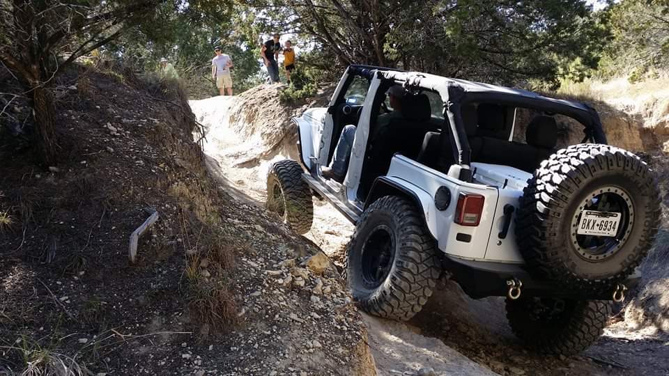

Does anybody here really think we believe you want serious off roading with a Rivian. Even a beautiful tricked out Jeep will never see rock climbing. Rock climbing in a beautiful Jeep with all of the bells and whistles of after market quality is NUTS!
skyote
2,725
5,647
Austin, TX
Rivian R1T R1S Rivian adjustable air suspension FB_IMG_1548825010562
Rivian R1T R1S Rivian adjustable air suspension FB_IMG_1548825003642
