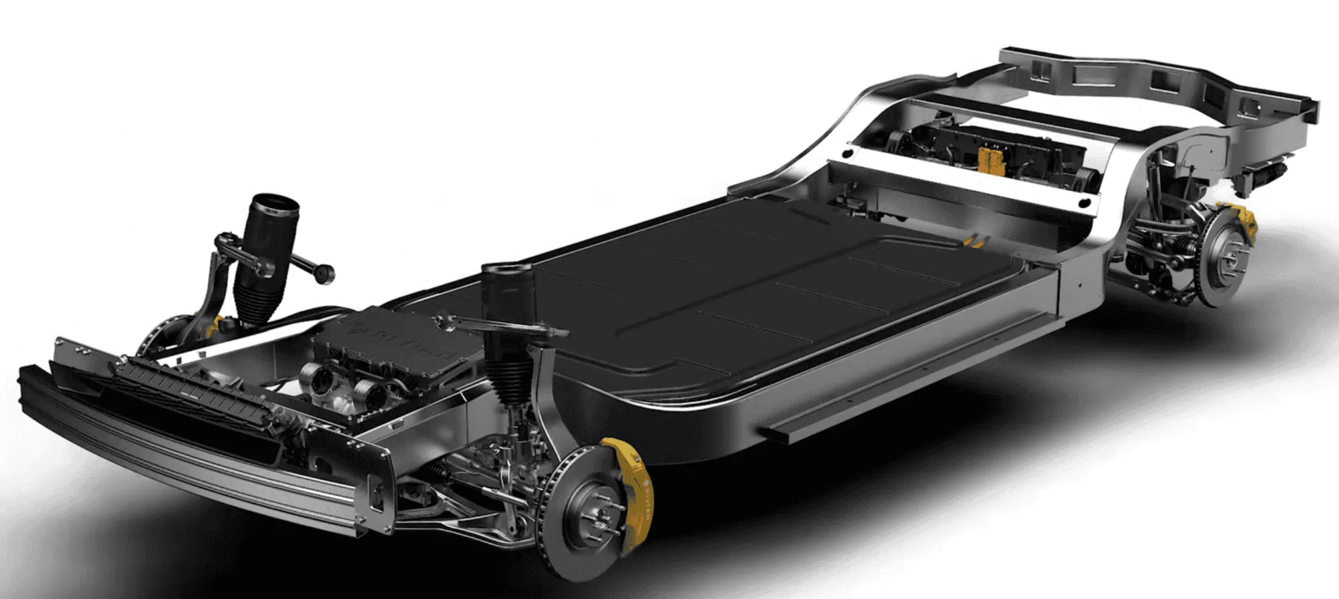

    There is no transfer case. Each of the four motors drives one wheel directly. No gears whatsoever. Regenerative braking would come from all four wheels.

    Actually, the Rivians do have single-gear transmissions on each motor. The motors do not drive the wheels directly but through a half shaft coming off a centrally-mounted transmission. The output shaft of each motor faces into a transmission case at the center of the vehicle, not into the wheel. (My Tesla -- and all other EV's of which I know -- use some type of transmission gearing. If I recall, the new Porsche Taycan is going to have a two-speed transmission.)
    Here is a passage from a Motor Trend article on the R1T:
    "Each [motor] drives one wheel through a centrally mounted single-speed transmission. To save weight, each pair of transmissions front and rear shares the same case but no moving parts. Putting the transmission outputs in the center of the vehicle allows for long halfshafts that Rivian says give the R1T greater wheel articulation."
    Different types of electric motors have different abilities to operate as generators. The Rivian is using permanent magnet motors, which are the least complicated to get to behave as generators. In many EV's, the ability of the motors to put energy back into the batteries during regenerative braking is limited not by the motor, but by the rate at which the battery can accept a charge. That is why Tesla is experimenting with adding capacitors to its energy pack, as capacitors can be charged almost instantaneously and would be ideal to store regenerative braking energy.

    In Aspen, I was told they were direct drive. No transmission at all.

    Here's a photo of the Rivian skateboard. It shows inboard motors rather than motors mounted at the wheels, and you can see the half shafts.

    I understand the principle of torque multiplication. I am just going by what I was told.
