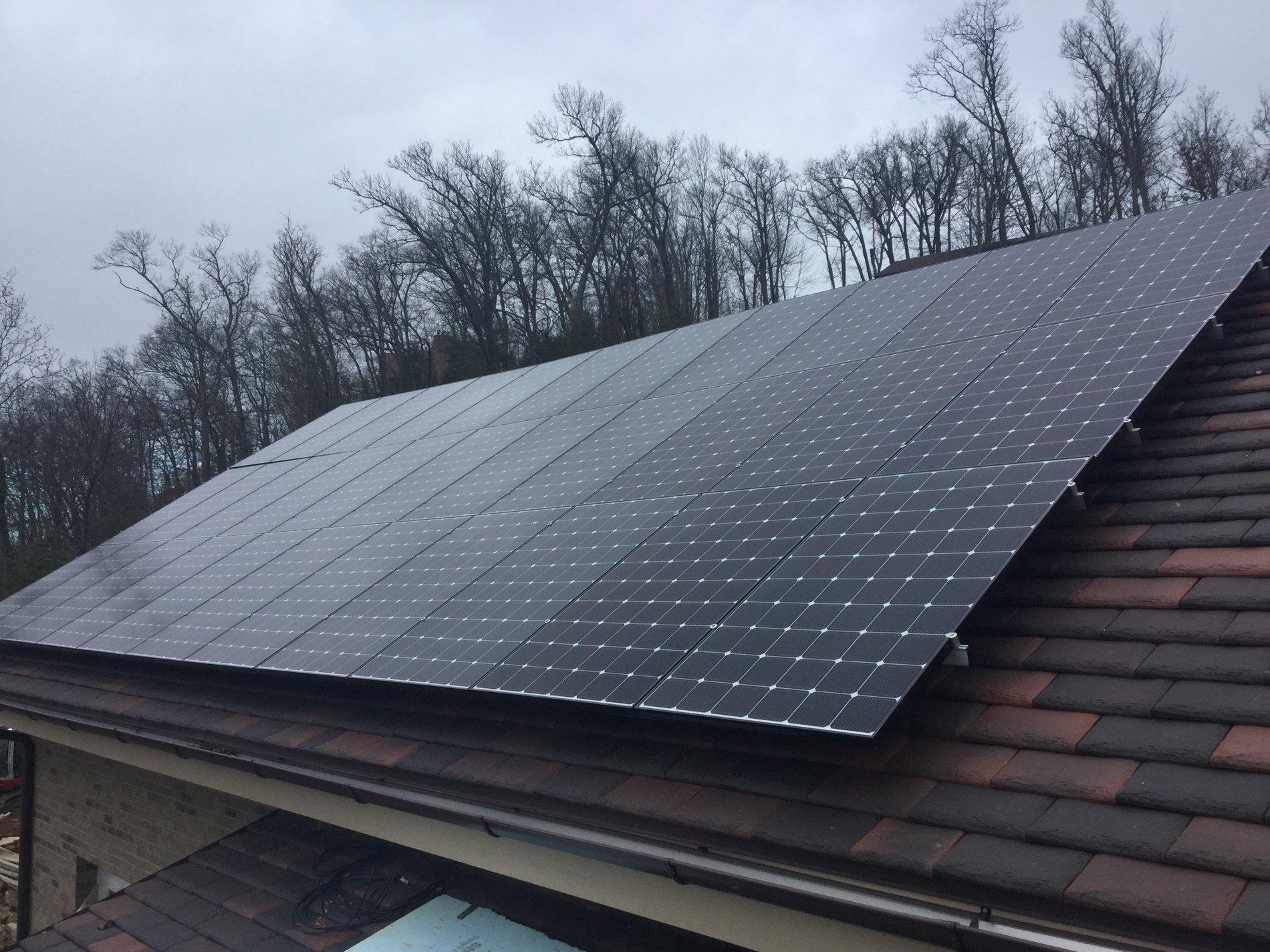

Jansen,
You will need lots of solar cells! I have a new system and have 45 cells to create a 15KW system, which would take days to fill the biggest 180KW size battery on Rivian R1T.

It takes 33 kWh of energy to add 100 miles of range to a 2018 Tesla Model S. Using as a comparison the range a Tesla gets from its 100 kWh battery (315 miles) and the range a Rivian gets from its 105 kWh battery (240 miles) -- due to the greater weight and lower aerodynamic efficiency of the Rivian -- it would take a bit over 41 kWh hours of energy to put 100 miles of range on a Rivian. It typically takes four panels one hour to produce one kilowatt of electricity in ideal conditions. That's either a LOT of hours or a LOT of solar panels to put 100 miles of range on a Rivian. And that's assuming weather conditions are optimal for solar generation. If you live somewhere with a lower solar factor than Las Vegas, the numbers just go higher.

You can do rough calculations as follows:
A Rivian has a probable range of 400 mi and a 180 kWh battery. Thus range is about 2 mi per kWh. A panel will produce about 1/4 kW AC in full sunshine. Thus a 10 kW (AC) system is about 40 panels. There are are about 5 hours of equivalent full sunshine in the temperate zone in the summer and about 3 in the winter. Thus, on average you can charge about 5*10*2 = 100 miles per day in the summer with a 40 panel system and 3*10*2 = 60 miles per day in the winter.
