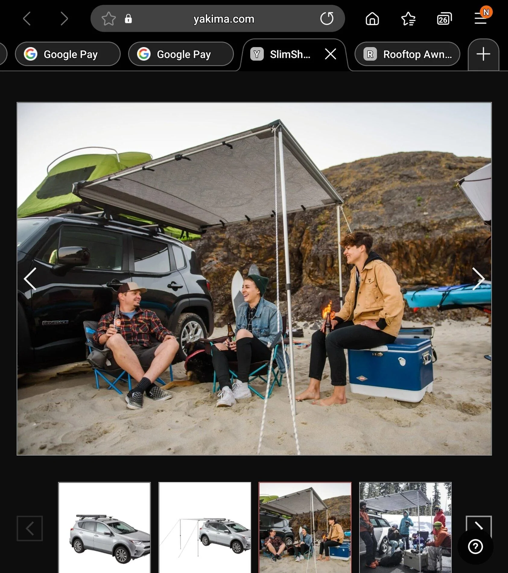

The Yakima SlimShaddy 8 will work for this setup. You can adjust the tent to the far left, and install the SlimShaddy to the right edge with no problem.
Rivian R1T R1S Yakima Slim Shady Awning questions Screenshot_20210905-131649_Samsung Internet

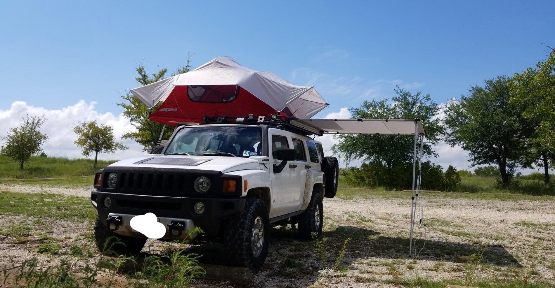

Just noticed this thread and have some input that could be helpful. I have the 3person Yakima RTT and the SlimShady mounted to my H3 for camping and overlanding. We have no issues opening passenger doors when the RTT is deployed and I don't suspect an R1T would be any different.
The awning does require about 4-6in behind the actual awning to let the mounting jaws to bite. Also the awning mounts can slide along the axis of the unit to give you fore/after control of what you want to shade. Don't take that as its adjustable on the fly but if you plan ahead you can mount it as to give the camp kitchen some coverage. There are alternatives mounts that will save you space up there but on my H3 the real estate gets tight from side to side.
Only pic I have on phone but can take a few later this evening.
Rivian R1T R1S Yakima Slim Shady Awning questions received_666893180339318
