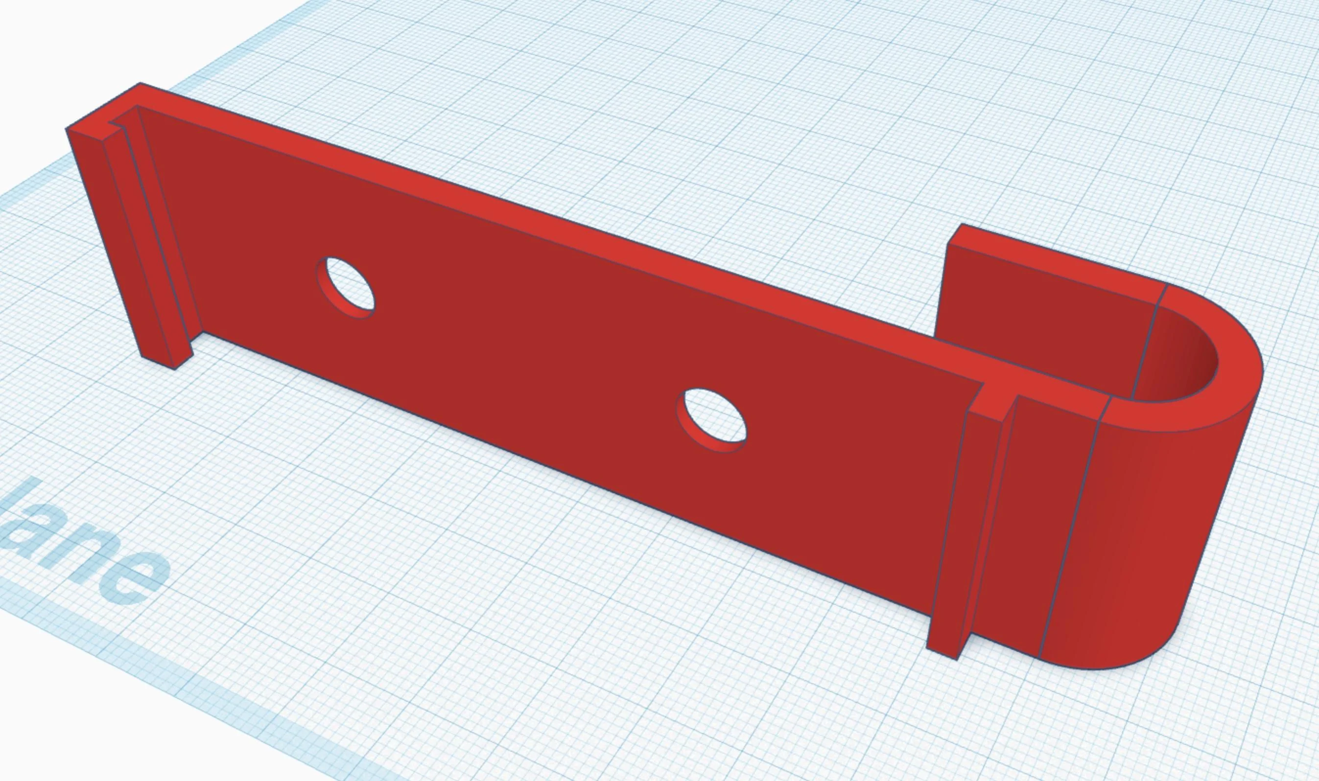

This was the easy part, until it wasn't. The concept is simple - a hanger that goes over something which the cup holder hangs on. Realistically though, it has to be both strong AND thin as we don't the cup holder sticking out tremendously far from whatever we hang it off of. I also want it to be easy to print for whomever wants to. This is the current design:
Rivian R1T R1S Work In Progress - Auxiliary Cup Holders (Removable - Collapsible - Adjustable) Screen Shot 2022-08-16 at 11.47.05 PM
It's very not right currently. The top is rounded and it shouldn't be in addition to it being on the wrong side. 😆 The dimensions need a bit of validation too. The back has indentations for a very shallow T bolt that spreads the load. You would need two of these per cup holder.

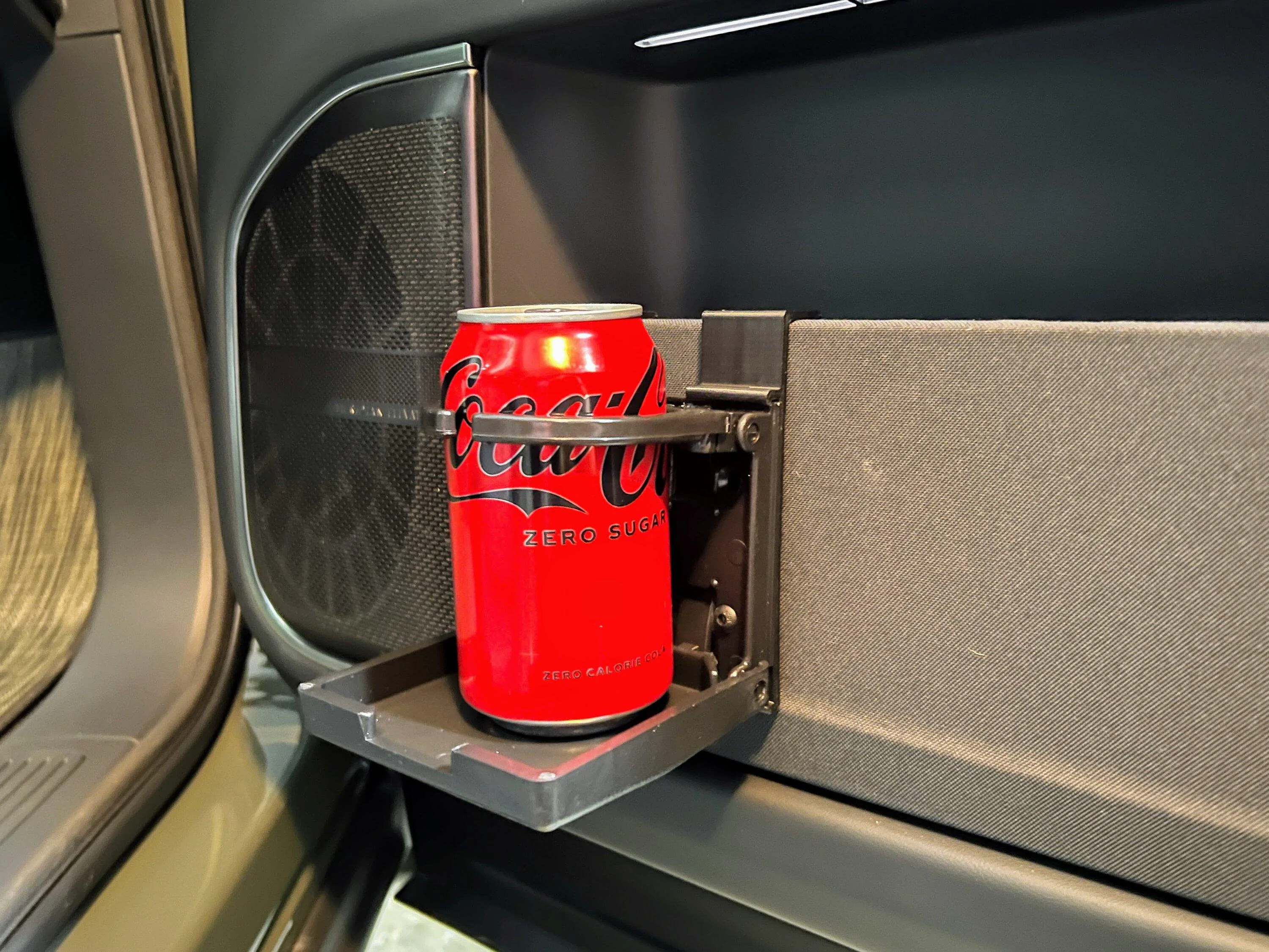

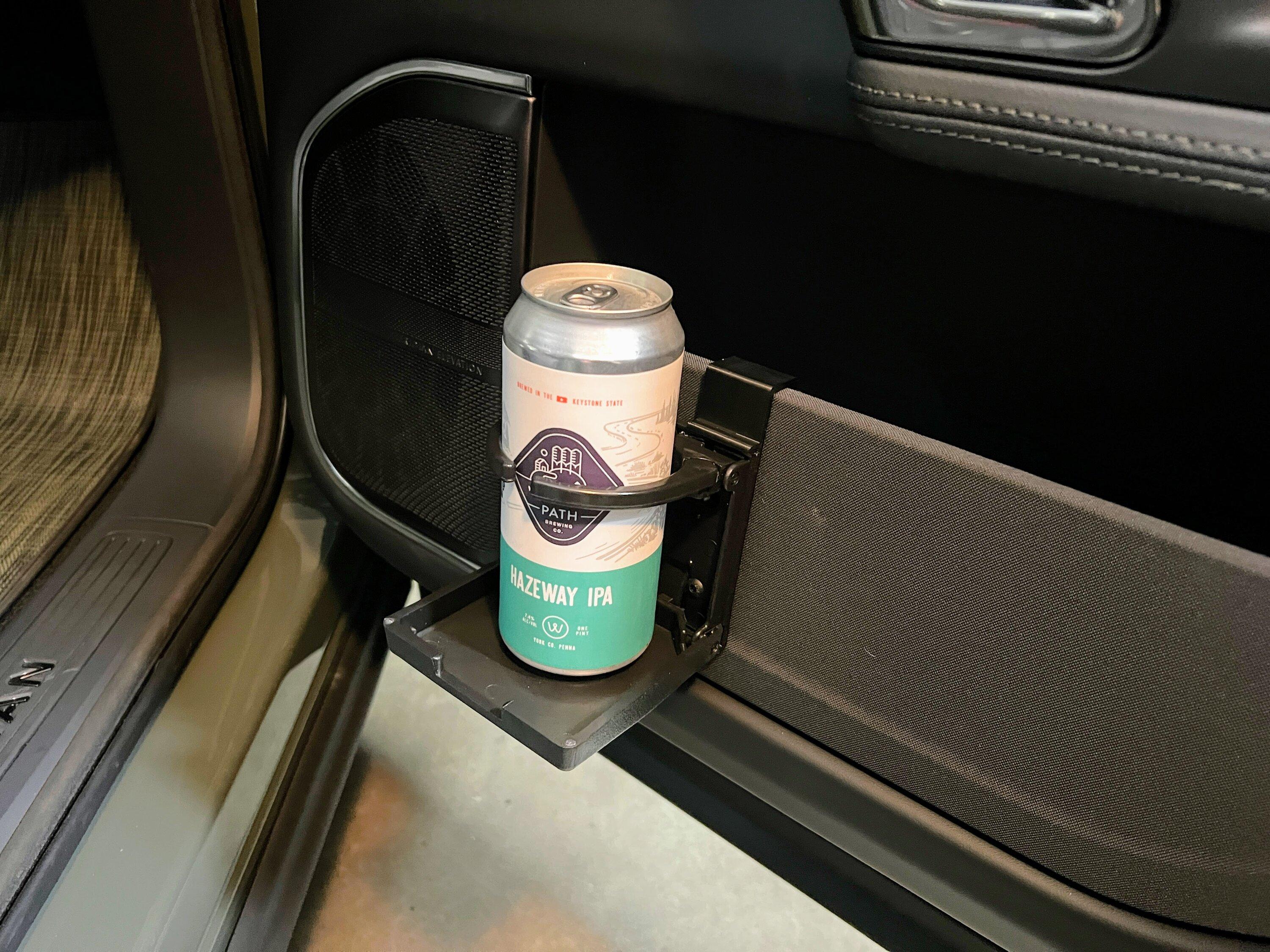

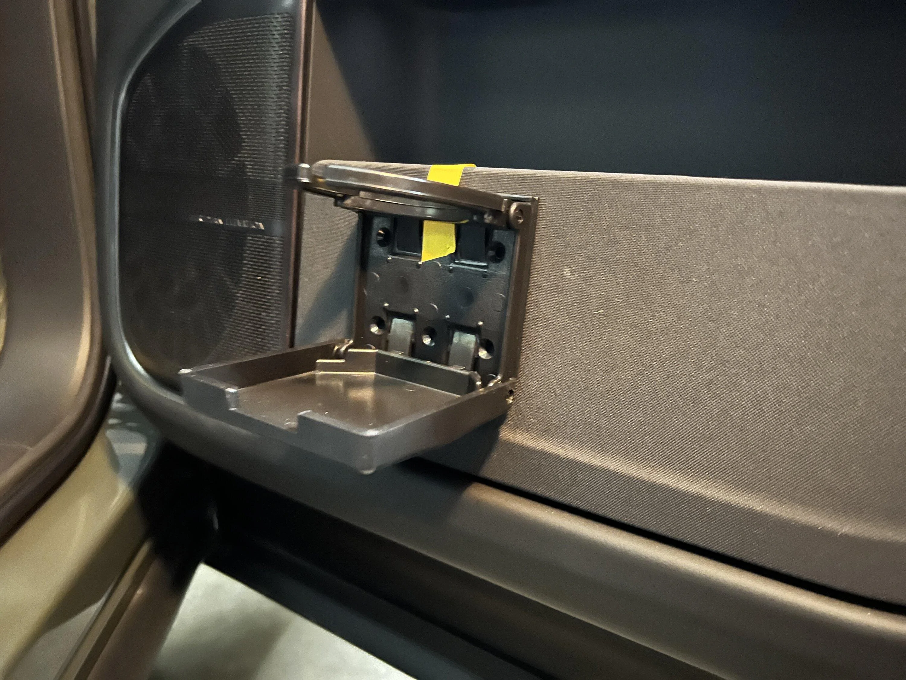

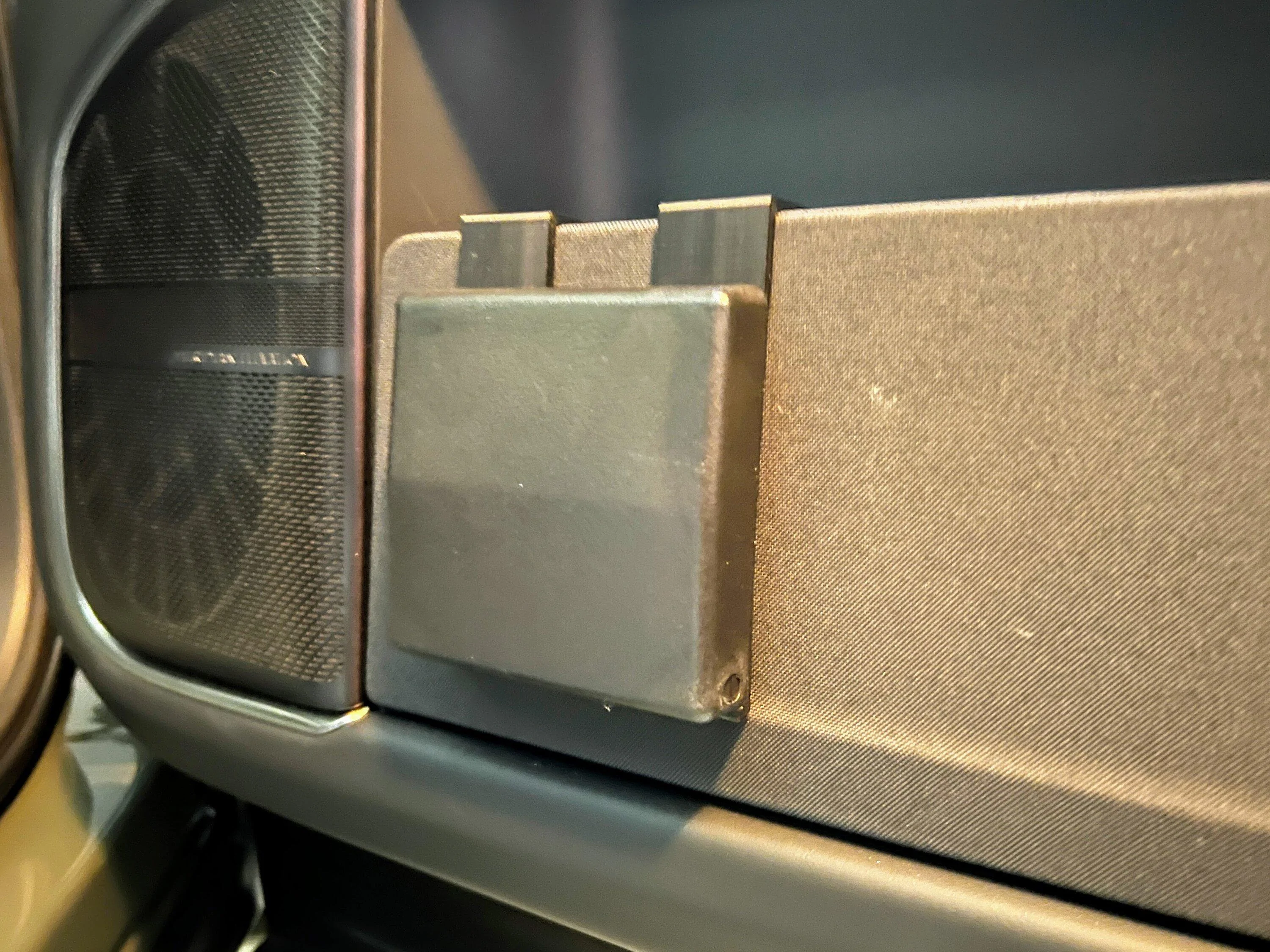

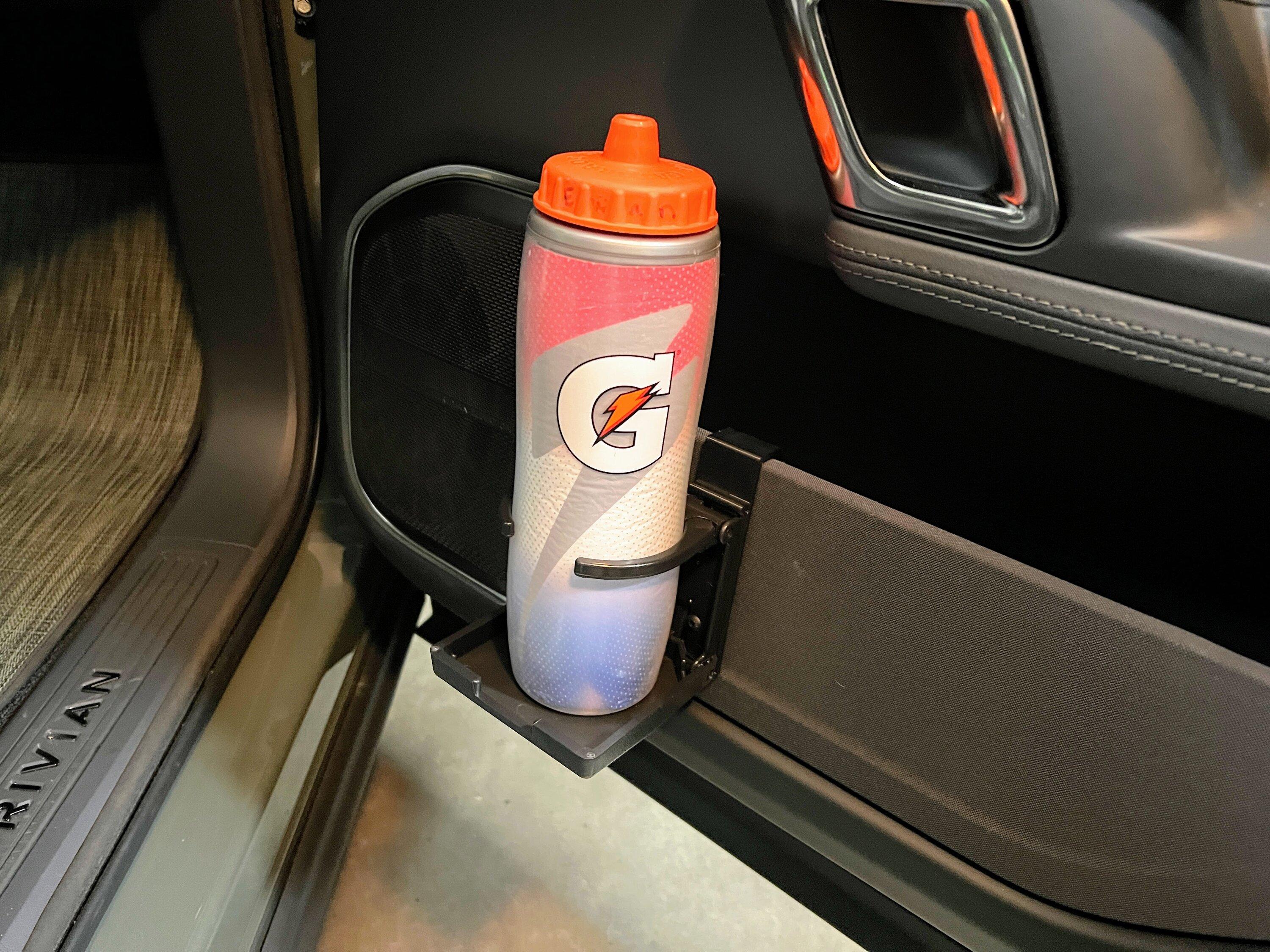

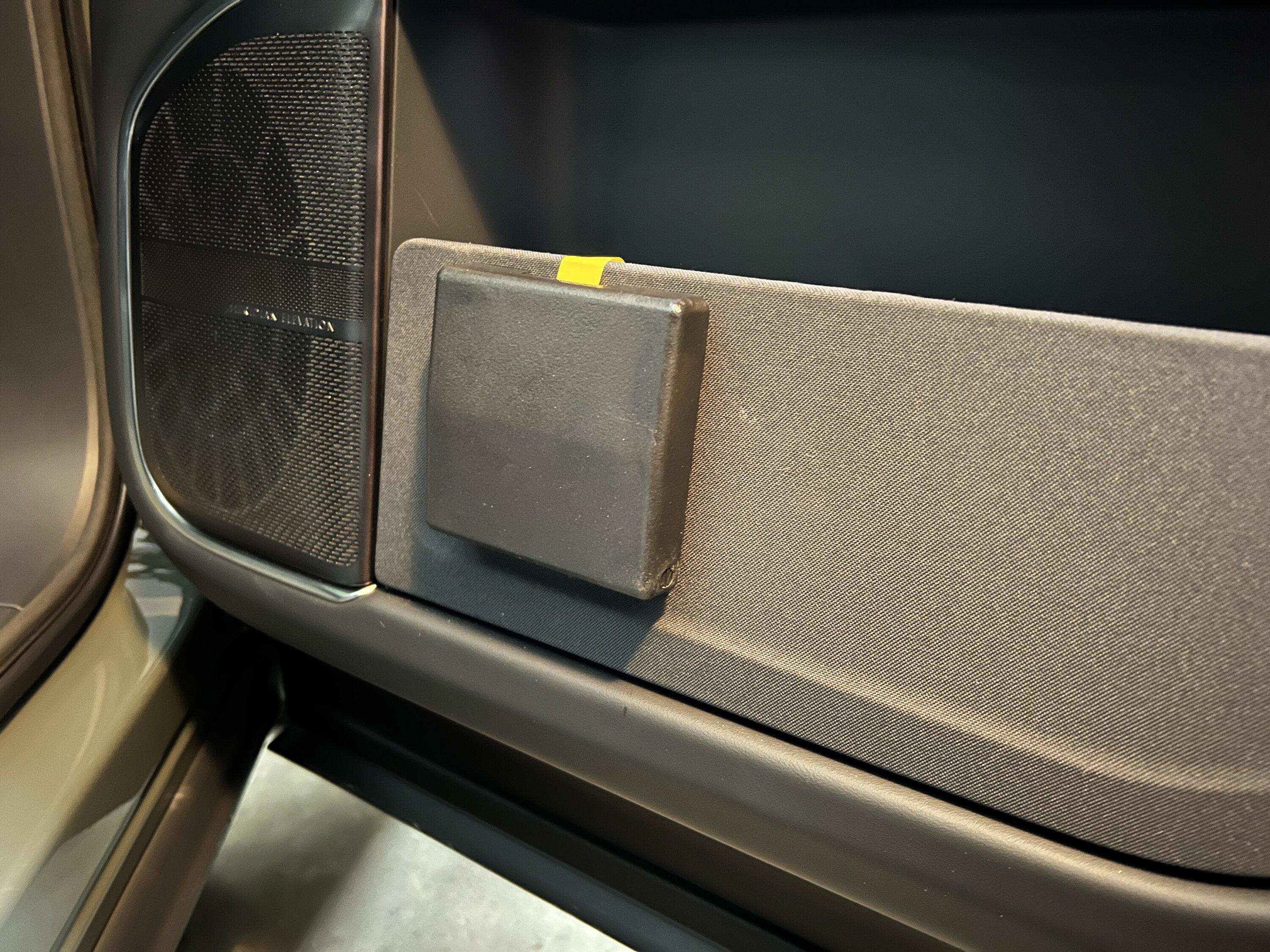

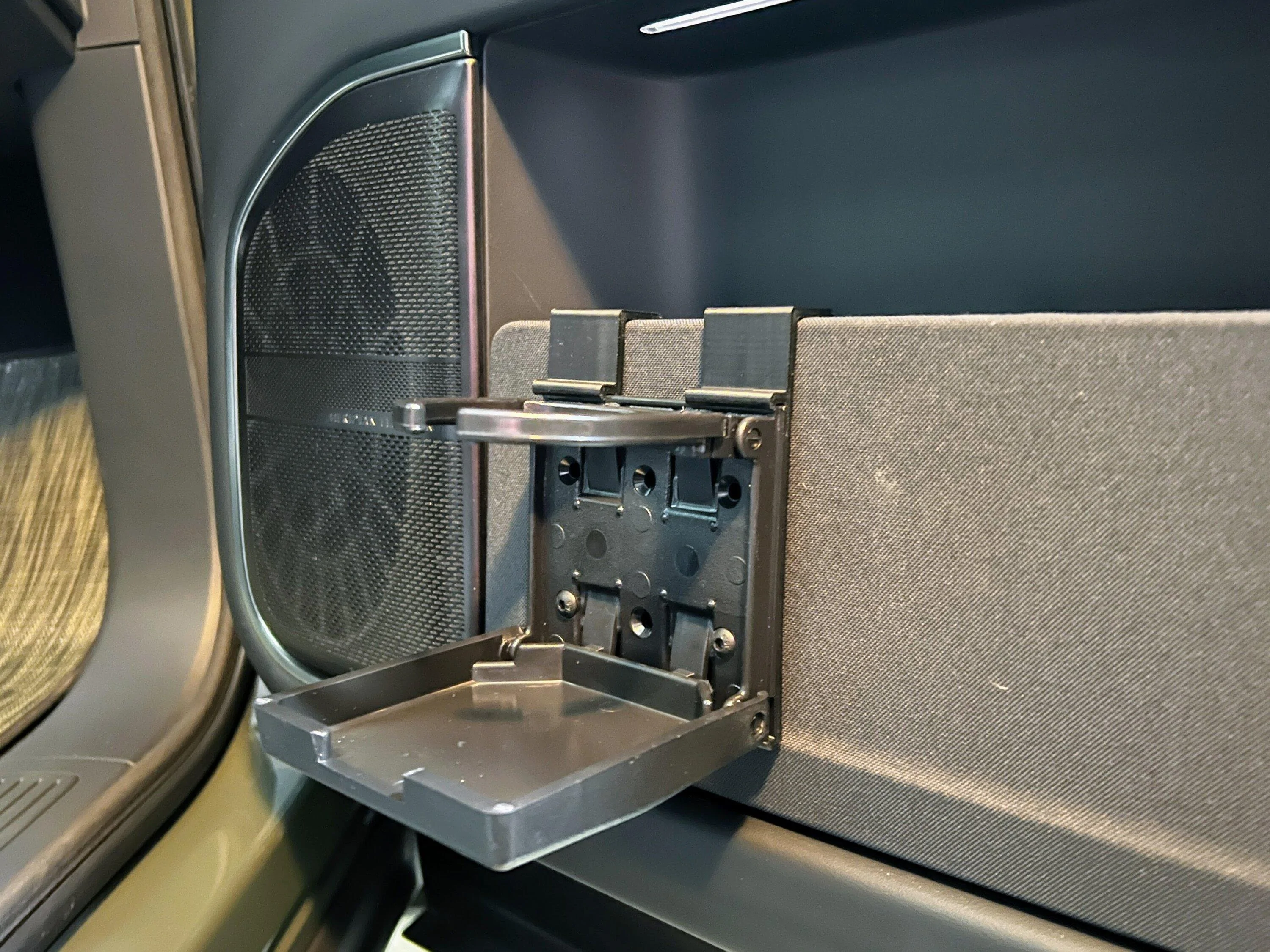

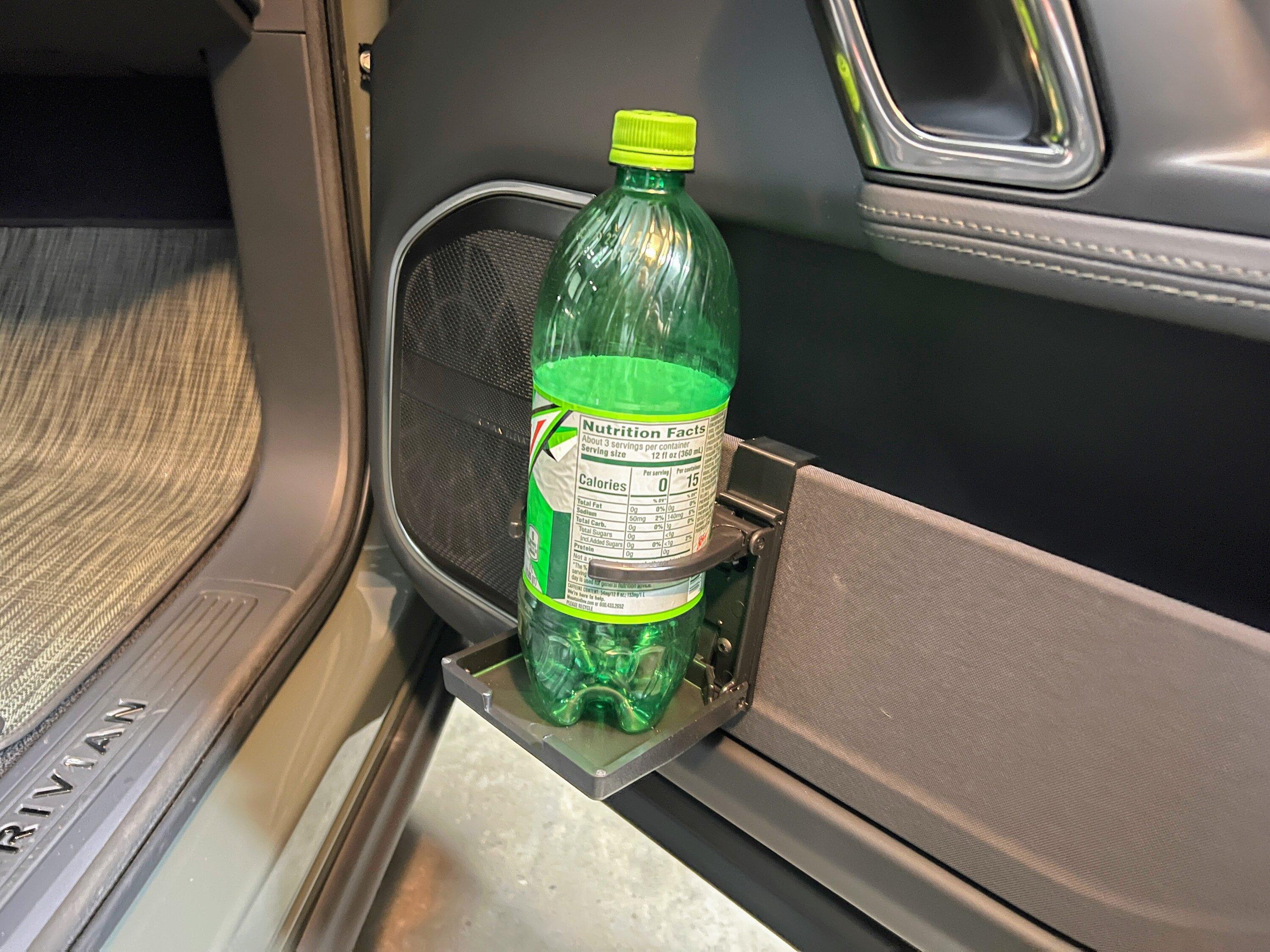

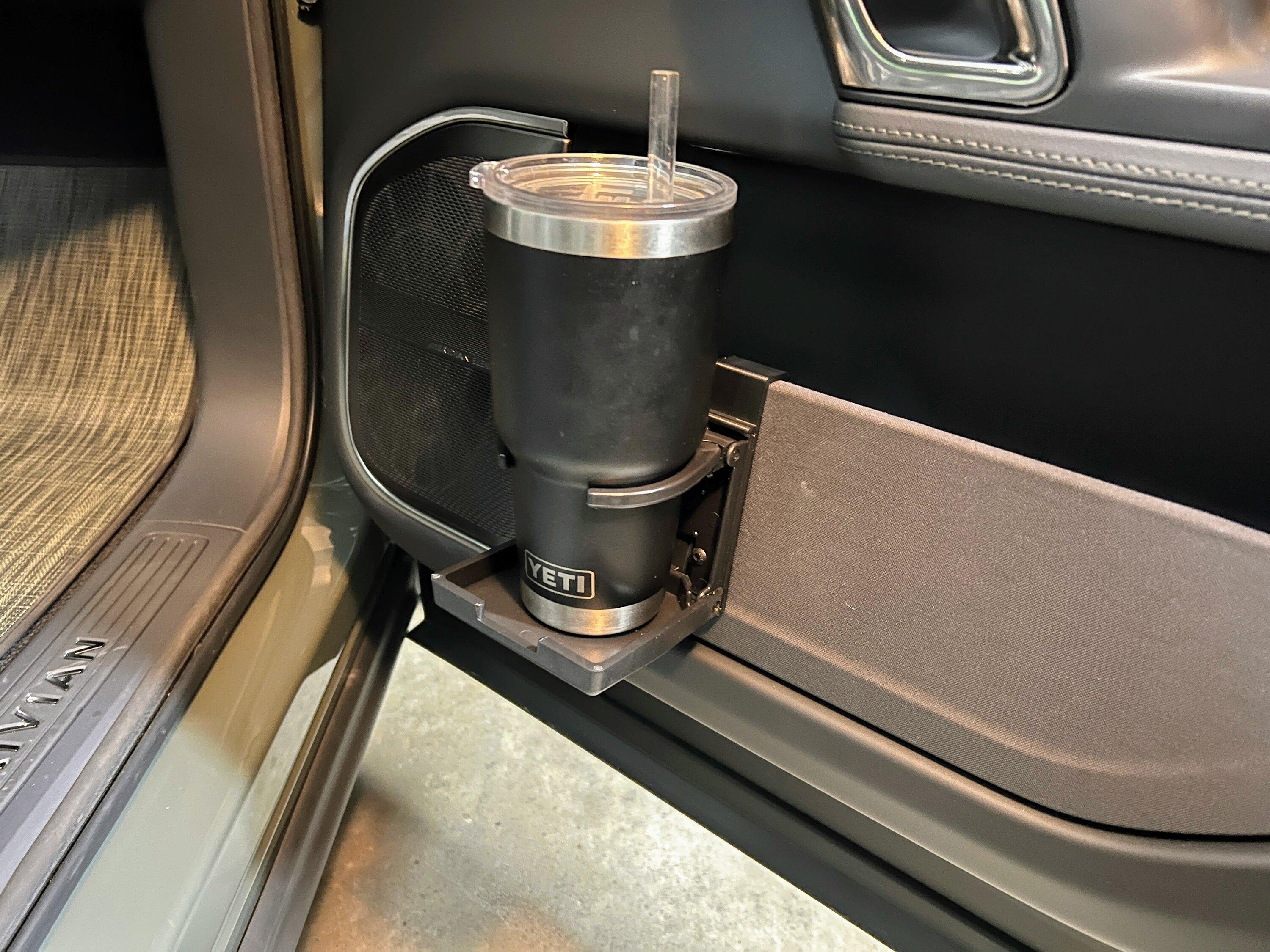

There are two locations that I believe this can mount easily and functionally while still being out of the way. First is on the door pocket, front or back. Here is what it would look like:
Rivian R1T R1S Work In Progress - Auxiliary Cup Holders (Removable - Collapsible - Adjustable) IMG_0731.JPG
Rivian R1T R1S Work In Progress - Auxiliary Cup Holders (Removable - Collapsible - Adjustable) IMG_0730.JPG
Ignoring that fact that it's held up by some Compass Yellow electrical tape, I think it actually looks great. The hard construction of the pocket would seemingly work well too. When not needed, it could be lifted off and tossed in the pocket itself.

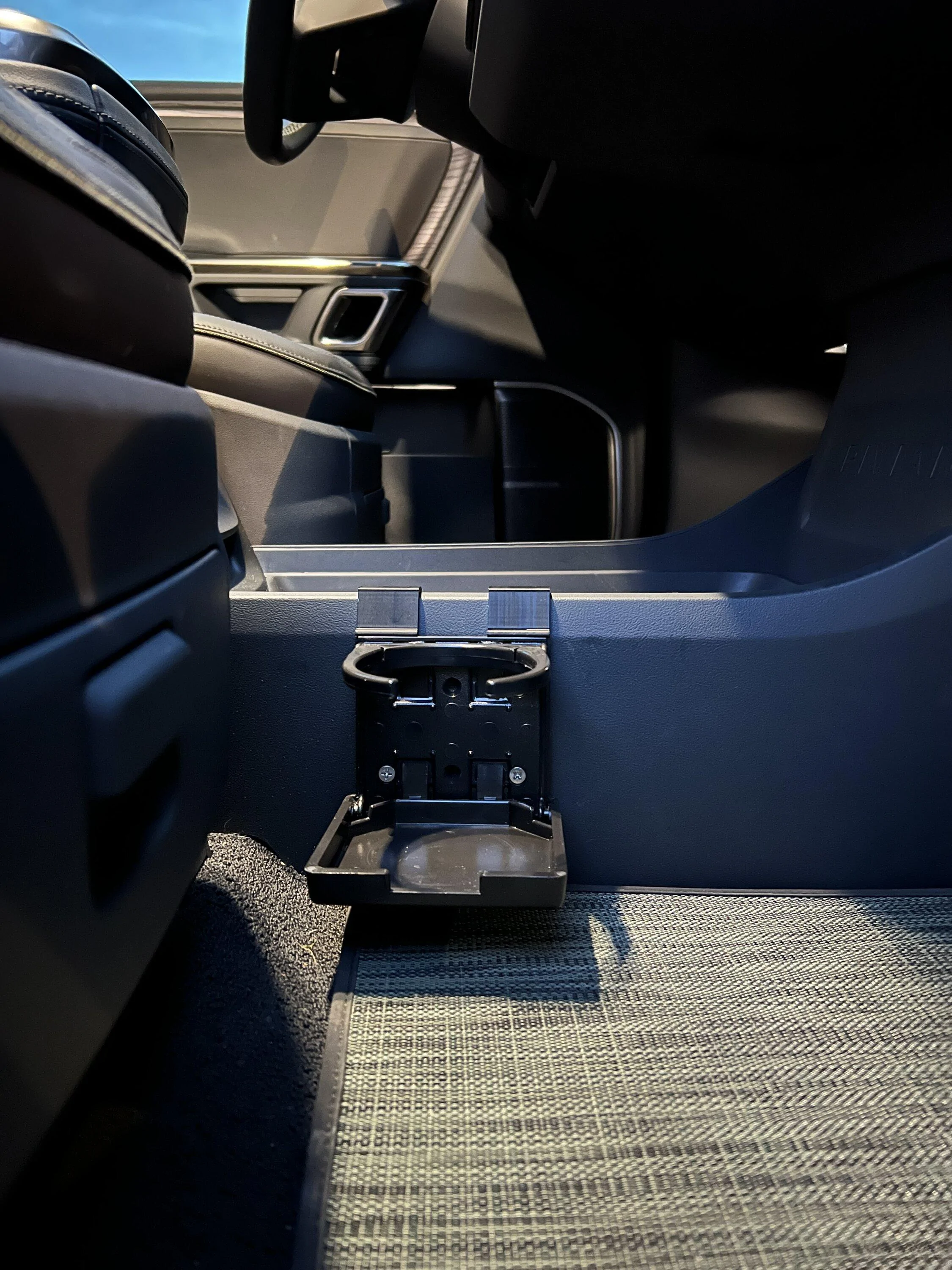

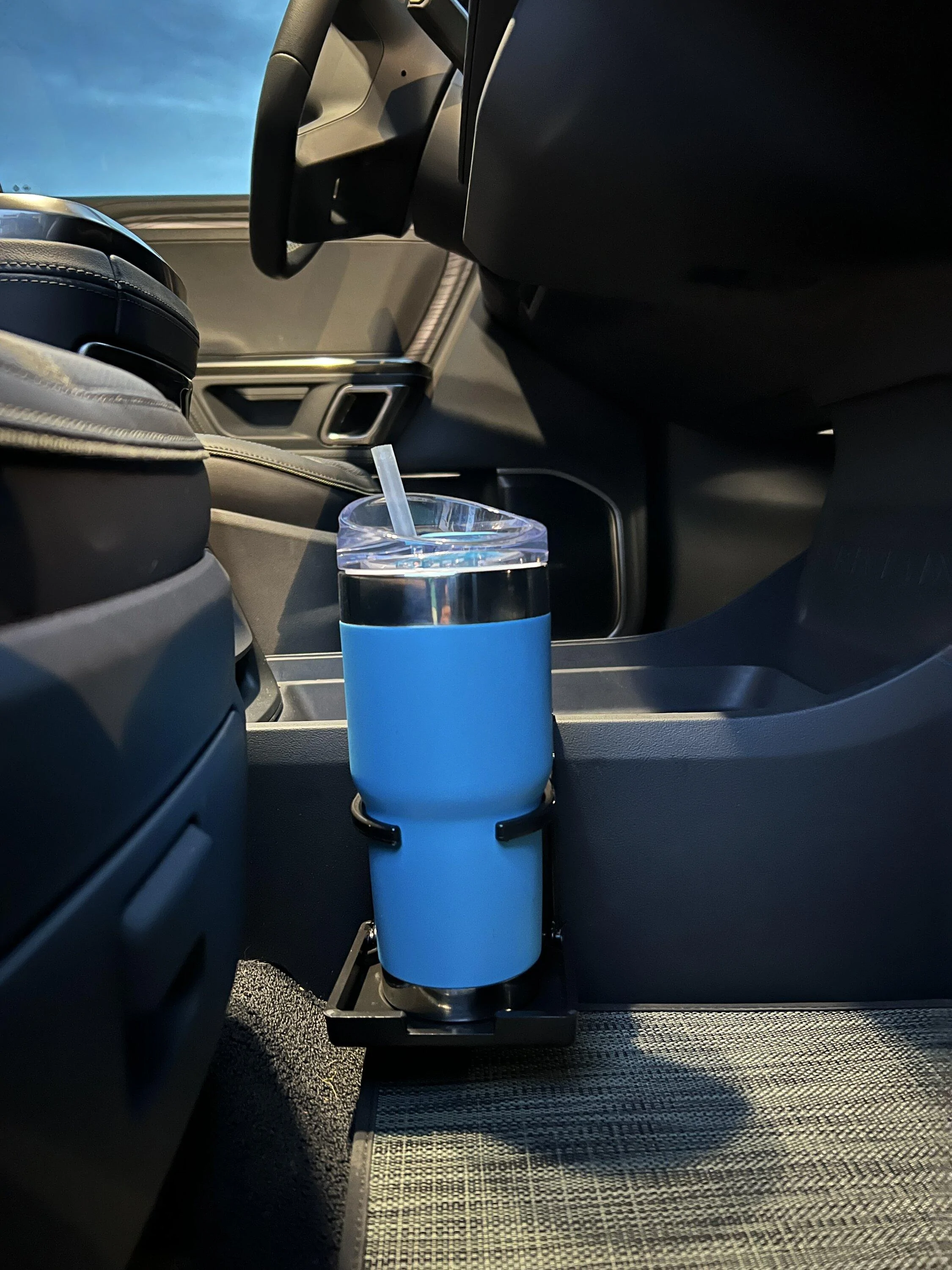

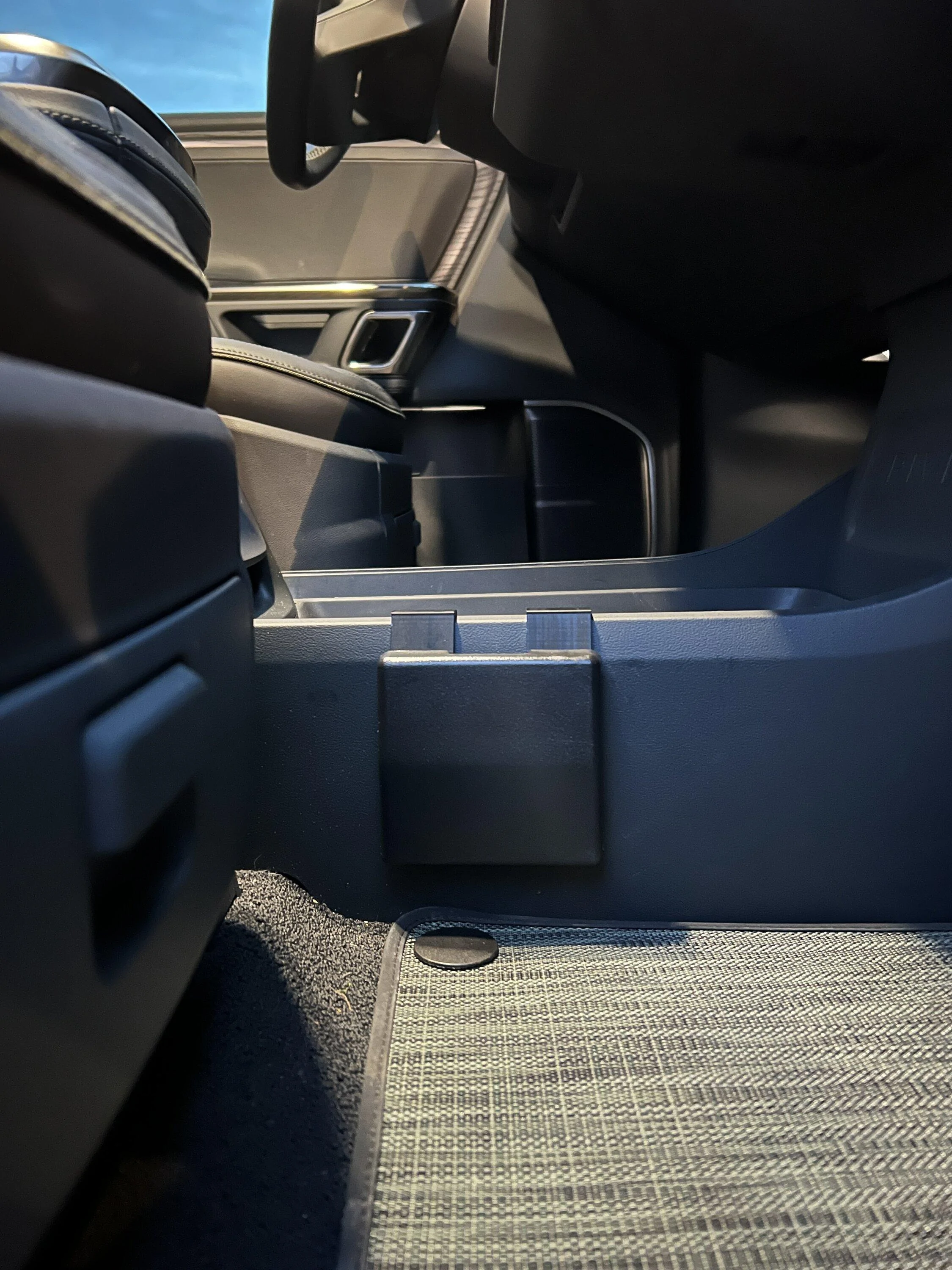

I believe I have a production-intent version of the Aux Cupholder complete. There will be two options in this initial version - one that installs on either of the front door pockets, and a second version that installs on passenger side of the center console storage area rail.

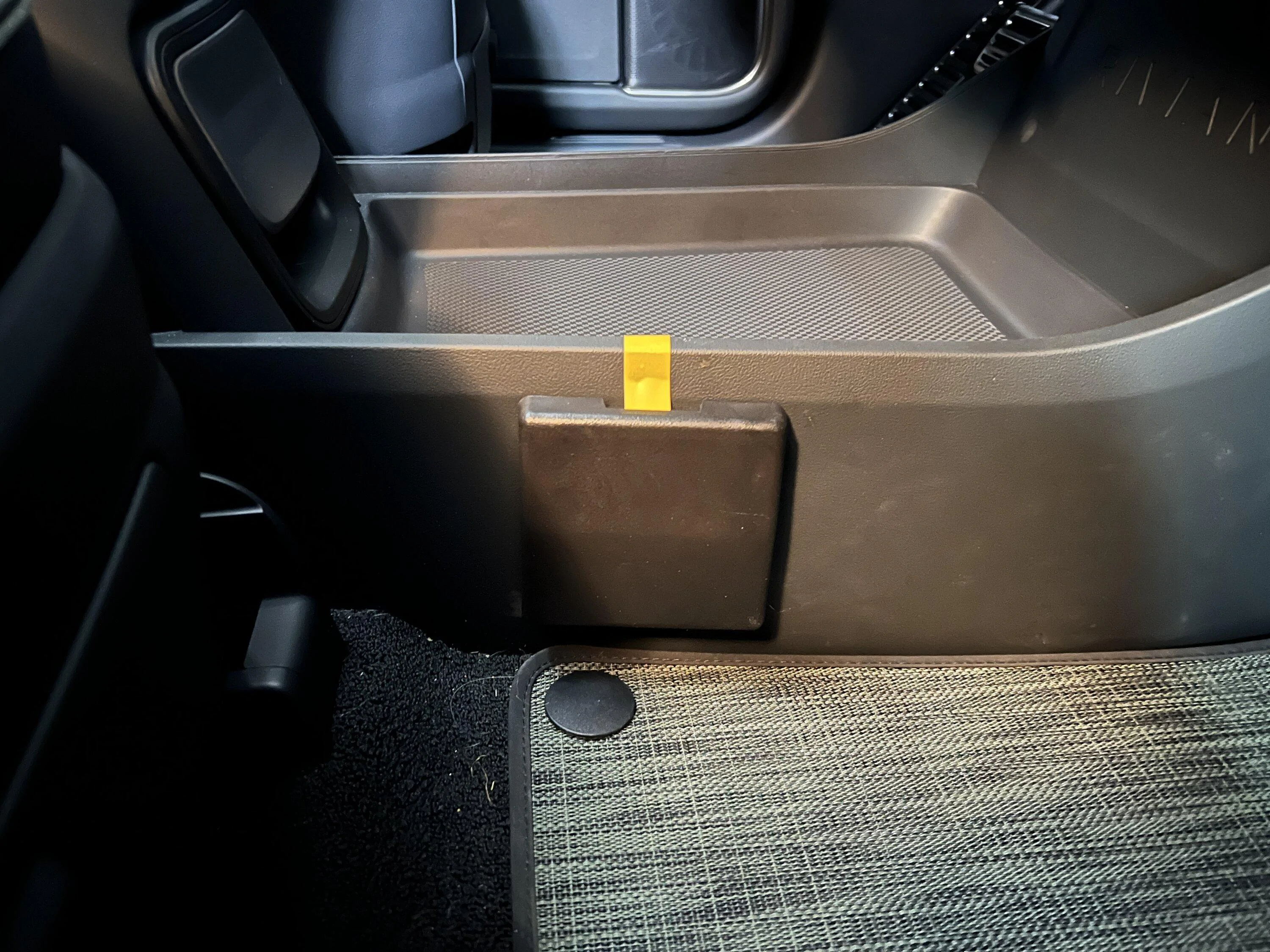

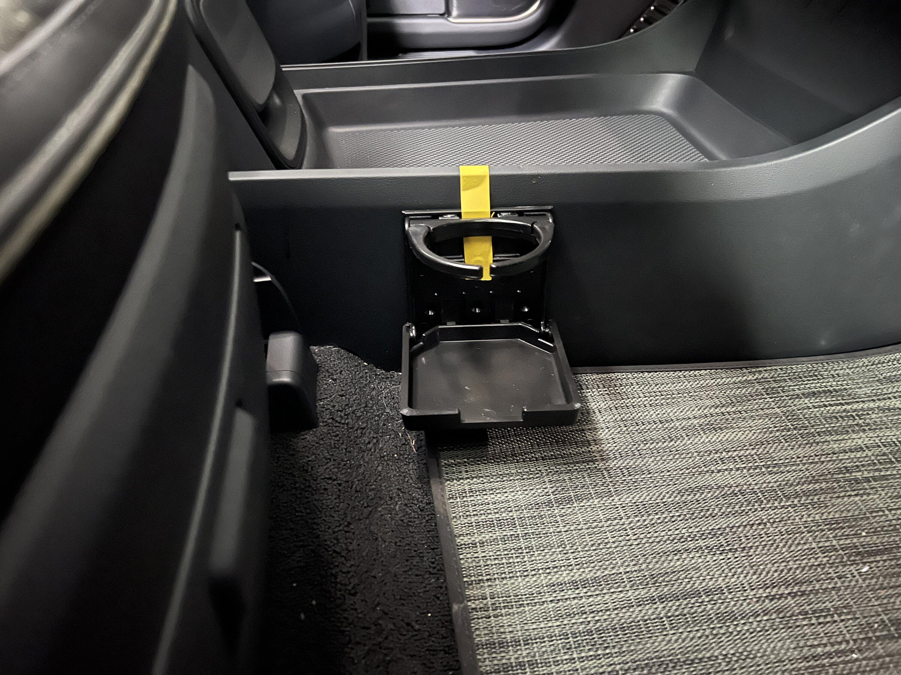

Pictures in the prior post are accurate for the door version. Here is what the center console rail looks like:
Rivian R1T R1S Work In Progress - Auxiliary Cup Holders (Removable - Collapsible - Adjustable) IMG_0758.JPG
Rivian R1T R1S Work In Progress - Auxiliary Cup Holders (Removable - Collapsible - Adjustable) IMG_0759.JPG
Rivian R1T R1S Work In Progress - Auxiliary Cup Holders (Removable - Collapsible - Adjustable) IMG_0760.JPG

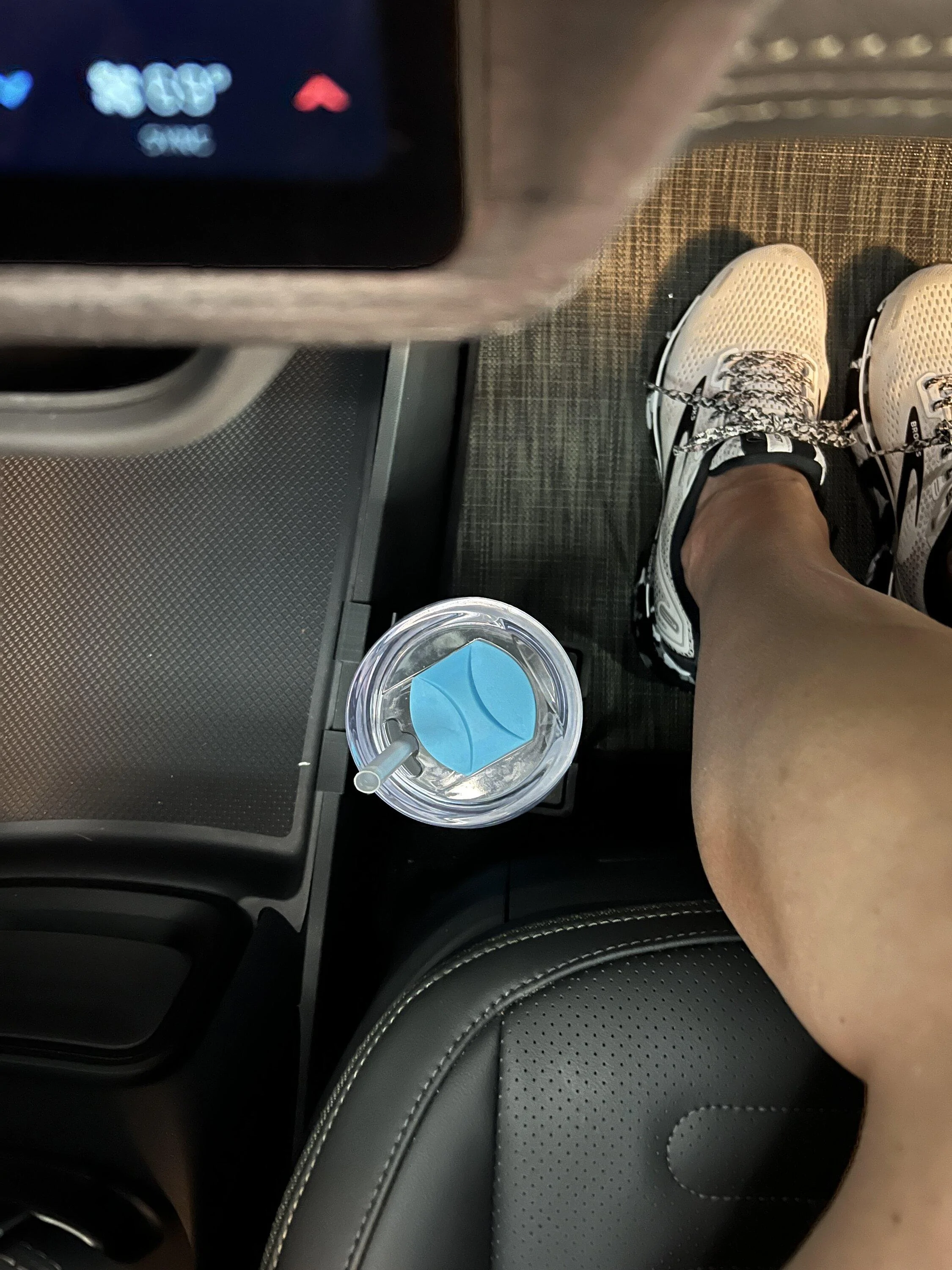

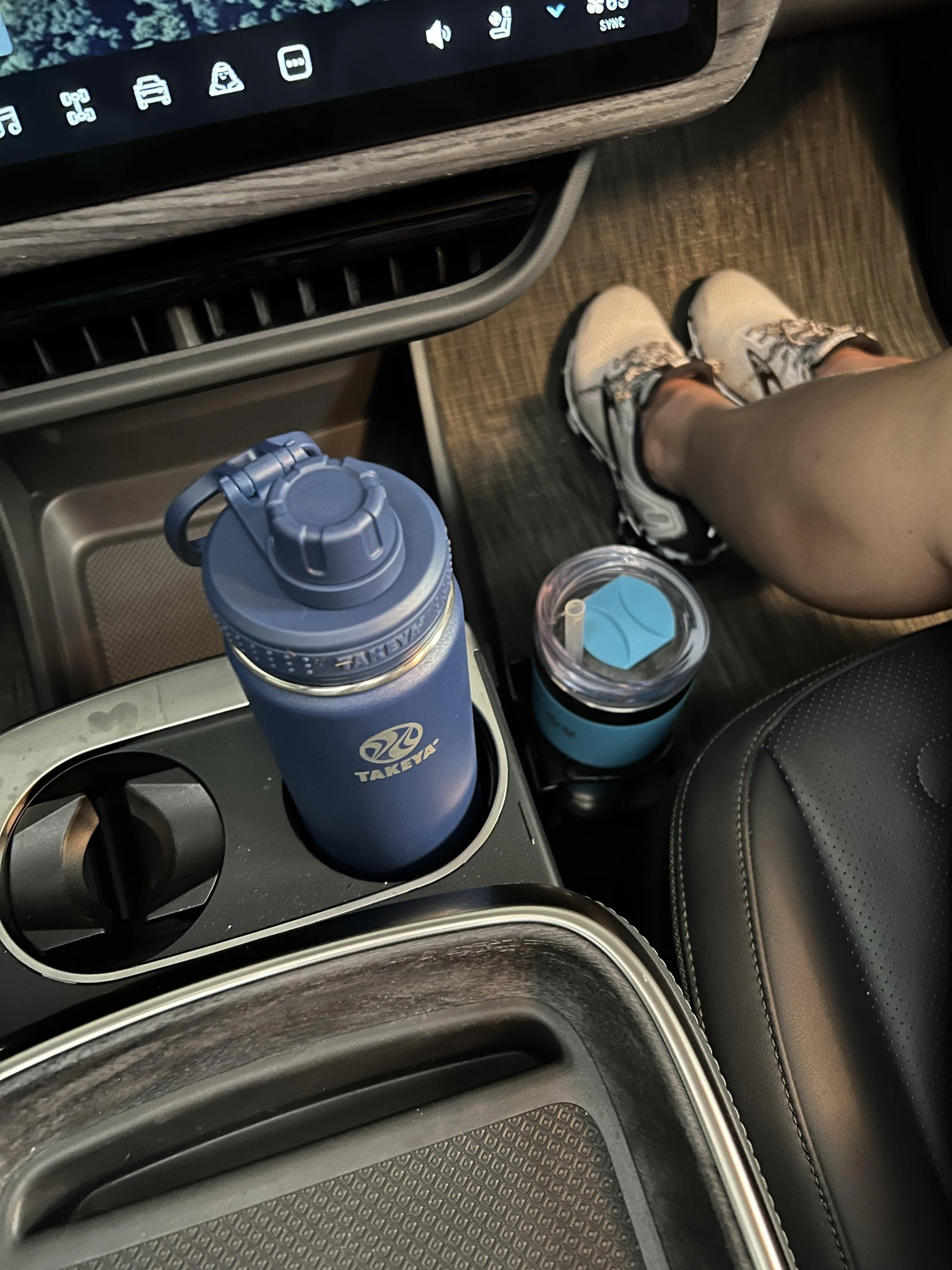

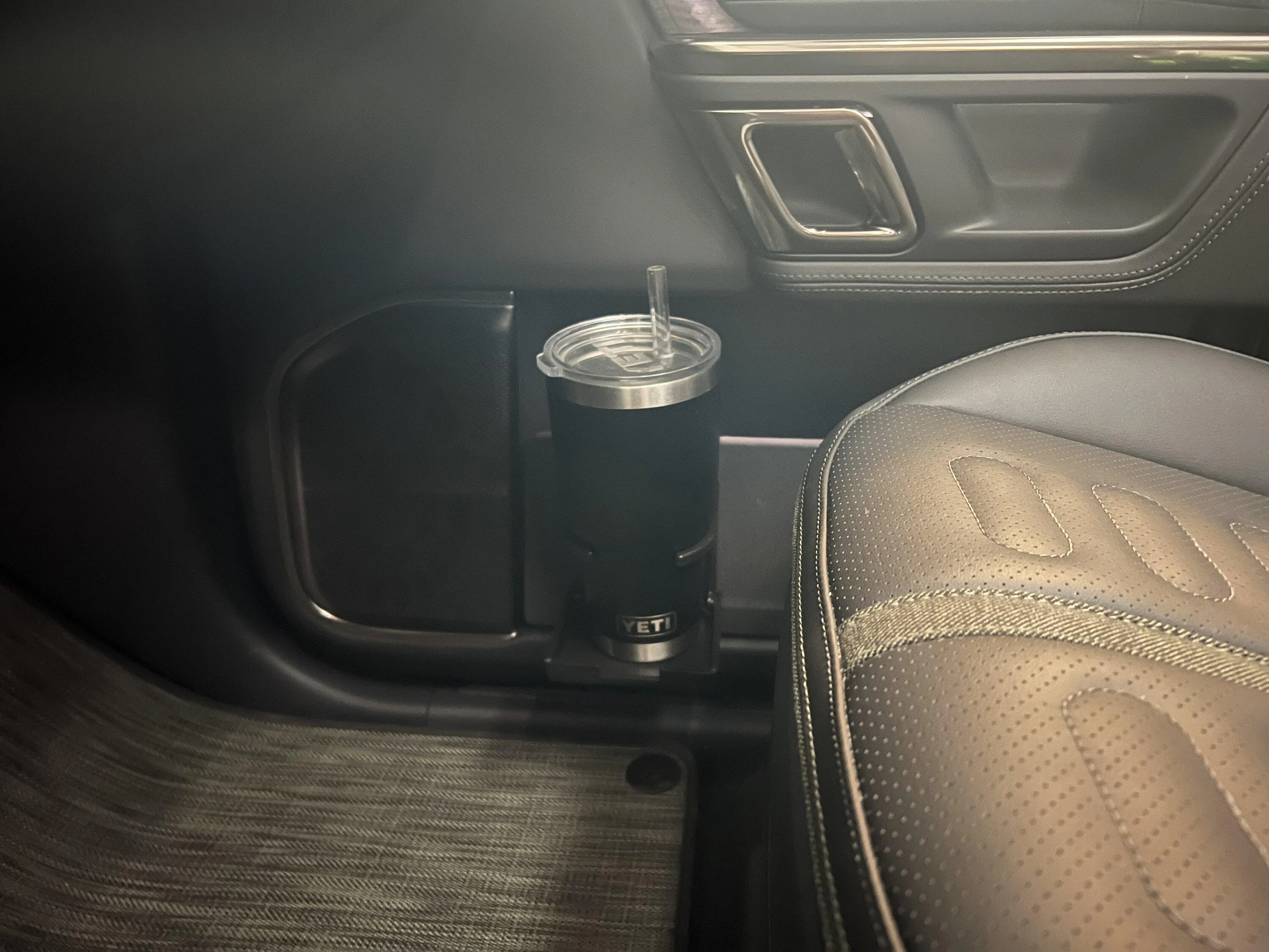

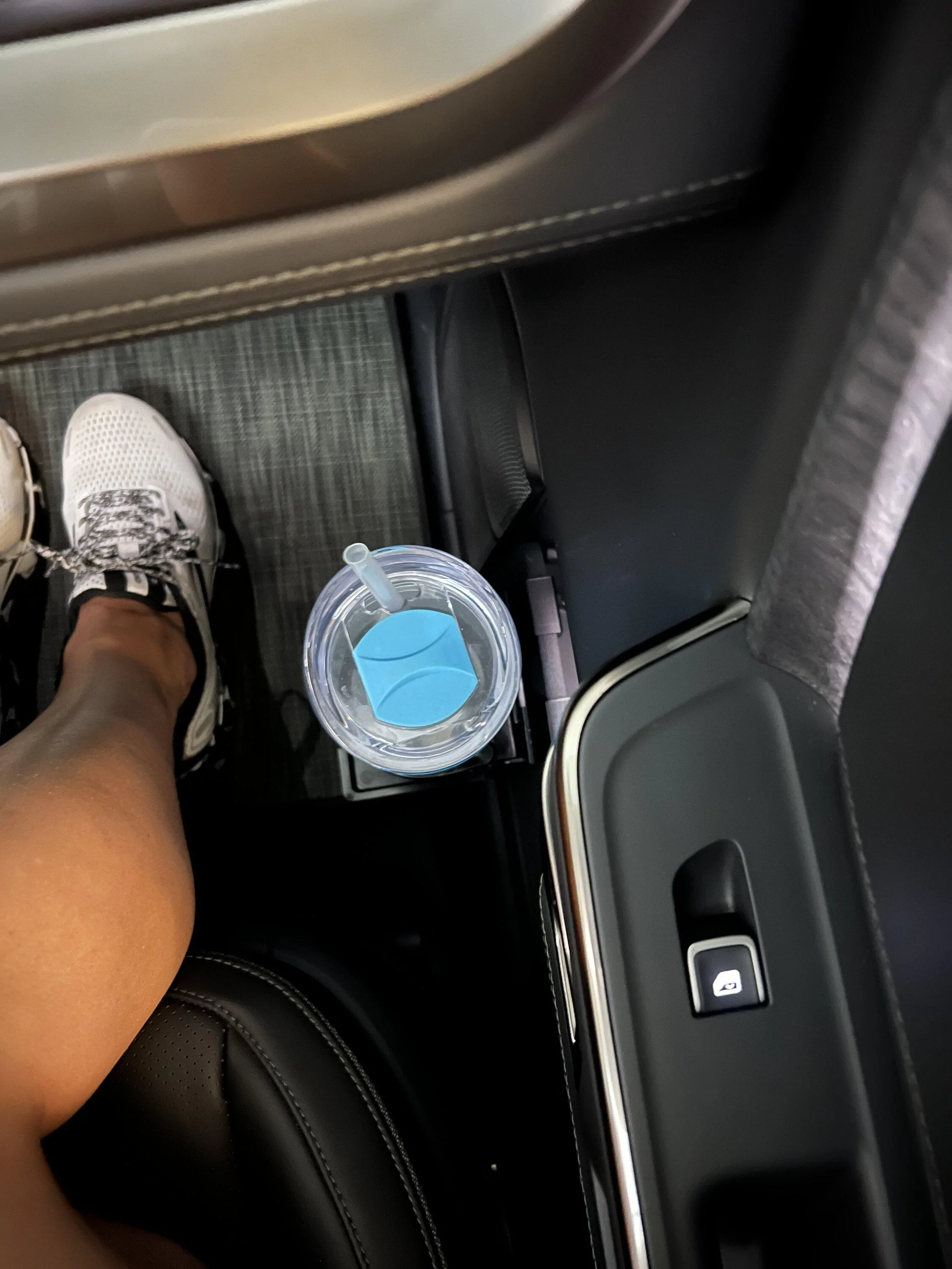

When not in use, they basically just sit there, folded up, blended into the truck like they aren't even there. When in use, here is what they look like with someone sitting in the seat:
Rivian R1T R1S Work In Progress - Auxiliary Cup Holders (Removable - Collapsible - Adjustable) IMG_0748.JPG
Rivian R1T R1S Work In Progress - Auxiliary Cup Holders (Removable - Collapsible - Adjustable) IMG_0752.JPG
Rivian R1T R1S Work In Progress - Auxiliary Cup Holders (Removable - Collapsible - Adjustable) IMG_0753.JPG
