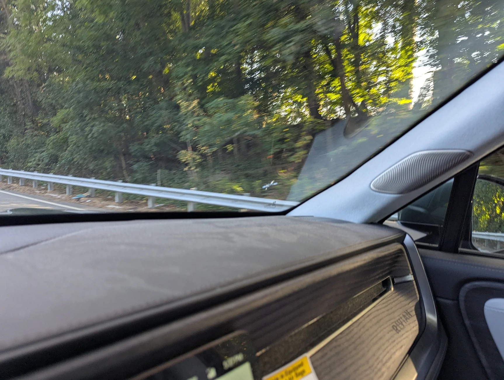

Just got back from Safelite in St. James, NY. As they were prepping the replacement glass, they discovered that the clip that holds one of the cameras was defective and they had to pick up a new windshield from the warehouse. They asked if I would prefer to wait or reschedule for another day. I said since I was already there and had set the day aside for this, I would go ahead and wait. It added another 50 minutes to the 2 hour appointment window but aside from that, everything else went without a hitch. The ADAS didn't complain about needing a recalibration and everything seems to be working fine. I didn't notice any wind noise or anything of the sort on local roads but I'll test that and Driver+ highway assist later this week after I give it some time to properly cure and settle. Alignment is perfect, but so was my factory windshield.
The Safelite team was friendly, respectful, and kept me informed of everything before, during, and after the procedure. Everyone I saw there seemed to be in good spirits and enjoyed the work they were doing. I watched them perform a few installs while I was waiting and each one appeared to be done professionally.
For anyone in the NYC/LI area in need of glass, I recommend these guys as an option to consider.
I'll put in a request for a Rivian SC camera recalibration in Brooklyn, but I know they're pretty backed up so I'm not holding my breath for that being done quickly.
EDIT: Looks like Brooklyn SC isn't as backed up as it used to be - I can get in as early as mid next week.
