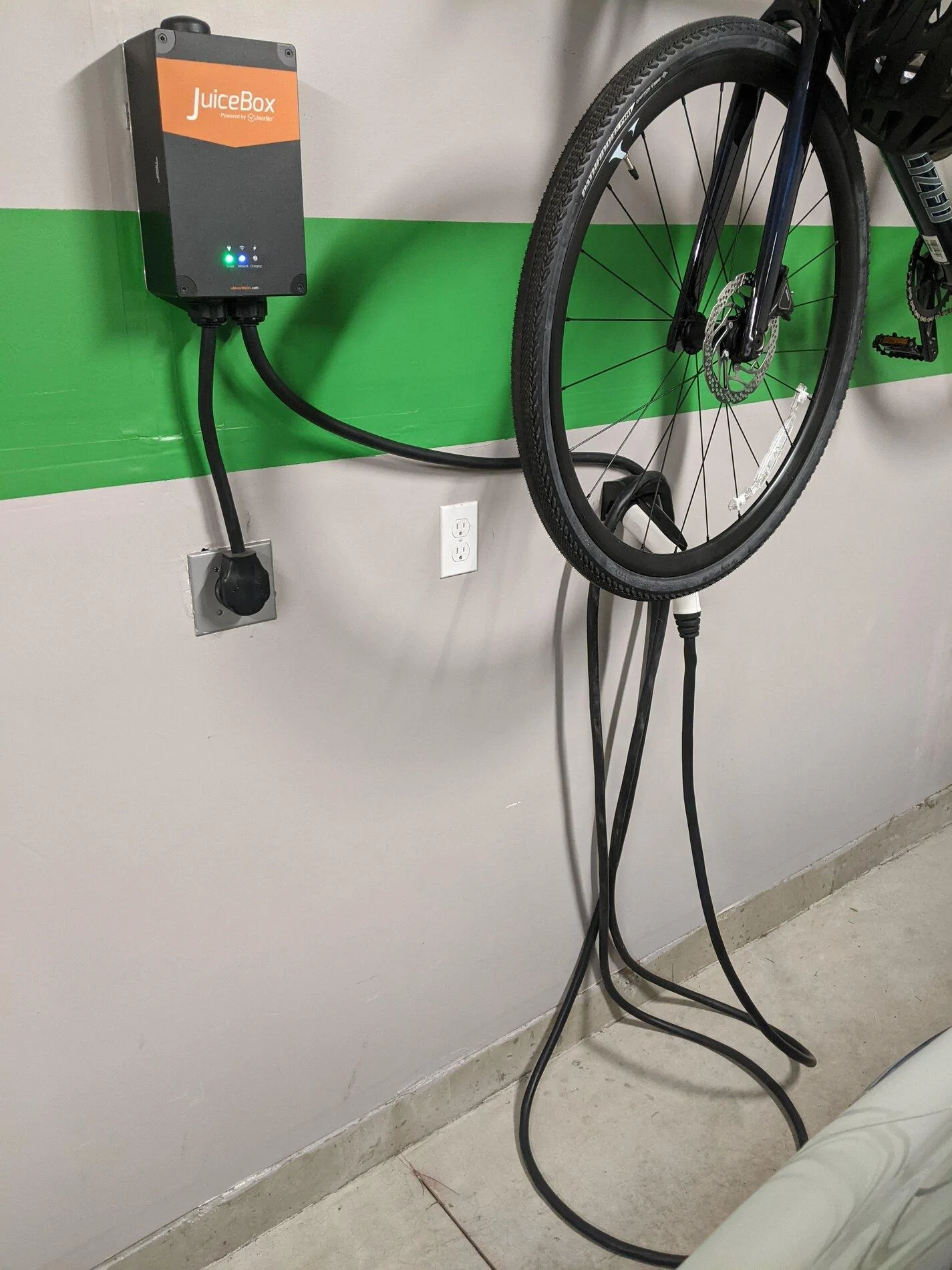

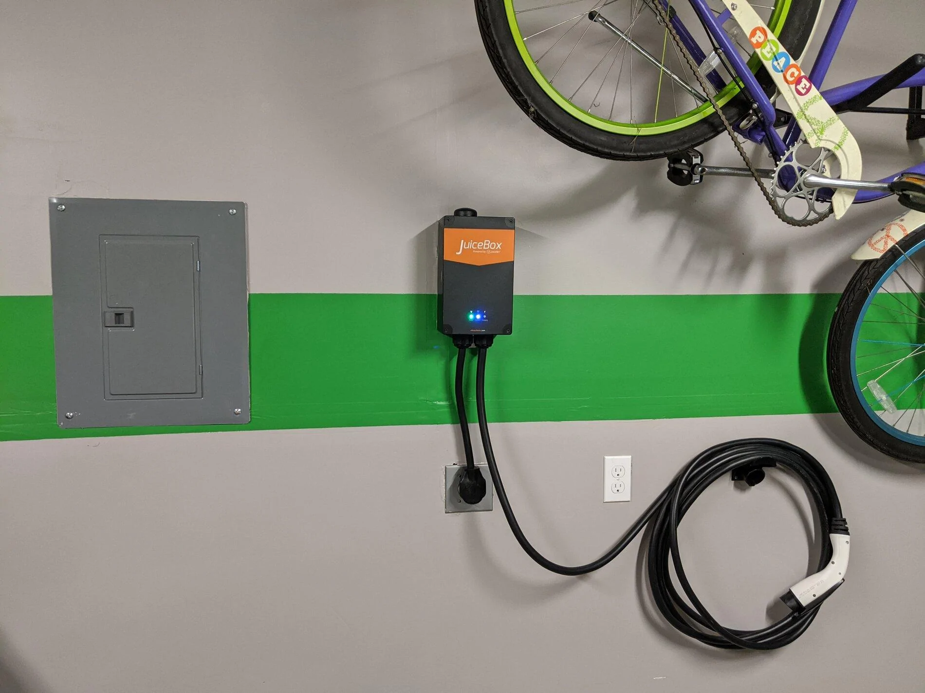

FWIW, I've been using the JuiceBox Pro40 (with 14-50r plug) on a 50A circuit for just over a year with Bumble. Around then they were bought by EnelX and have a newly rebranded model that got a modern facelift with improved cable management.
Rivian R1T R1S Will Rivian offer a home charging system? IMG_20191130_063353
*Note* -photo taken 11/30/19. That cable is nowhere near as neat now. ?
After 10k miles and 12 months of juice...

For all intents and purposes it works great. Some hiccups here and there but the App has satisfied my tech-geek needs living with a nine year old battery with 32% degradation, no active cooling/heat pump, and an unheated garage. The Nissan Leaf App is decent until your phone updates. This is something I'm super excited for...a Rivian Phone App that actually works, all the time. If it ends up being as reliable as I've heard Tesla's is we're in good shape.
Lastly, I'm excited to see what Amperage we will be allowed to pump into these ginormous packs for L2/Home charging. Bumble is capped at about 16A yielding 3.3kW so it'll be interesting if I can throw the whole enchilada at the Rivian. If it's about ~15kW getting about 25 miles of range/hour that should be decent enough, so for me it's gonna seem like going from Dial-up to Broadband, but then again....the battery capacity is what...180/24...carry the 2... it's like waaaay bigger...so could end up being a wash. ;)
The Rivian will take 48A, which requires a hardwired EVSE on a 60A circuit. Your Juicebox will provide 40A, or about 9.6 kW (will vary a bit +/- based on the actual line voltage that will likely stray a bit from the nominal 240).
