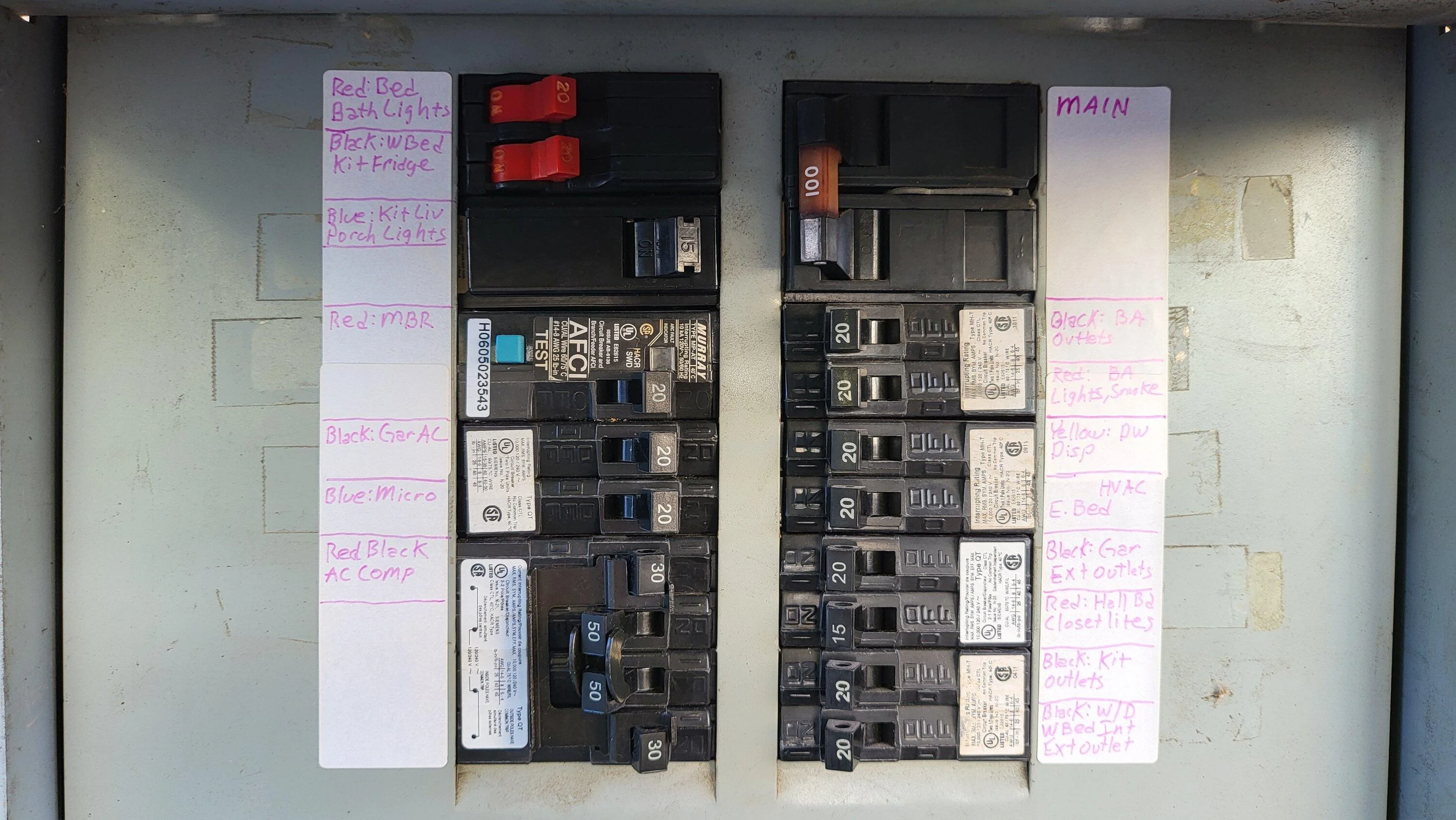

I have a grizzl-e duo at work. And I have to turn it off at the breaker inside. So I plug in my R1 and go inside and then flip breaker on just like power being restored. It works perfect.
Keep in mind that breakers are not intended or designed to used as a switch. They do not have the longevity or duty cycle like a light switch.
HaveBlue
Nov 22, 2022
1,239
919
91107
Does anyone know if the R1 vehicles will automatically accept charge from an EVSE when power is restored after an outage? For example the EnelX Juicebox or ChargePoint HomeFlex will automatically restart and try to send charge to the connected vehicle after power is restored after an outage. Some vehicles will accept this restart, but some do not. I’m asking about this in particular because I have an old house and limited to 100 Amps. Upgrading the power line to my house to 200 or 250A would cost about $45K which is outrageous so I’ve decided to install a DCC-12 instead. This device monitors the power consumption of the entire house and cuts the EVSE of load exceeds 80% and reinstates it once below that threshold for a period of time. However, I’d like to know if this is a workable solution for the R1 vehicles. Thanks.
You can likely do a 50A breaker/40A draw setup unless you have an electric dryer and or electric stove along with Central Air. Many 100A panels have just 12 slots so you have to be creative with twins or quads.
https://ask-the-electrician.com/residential-electrical-load-calculation.html
