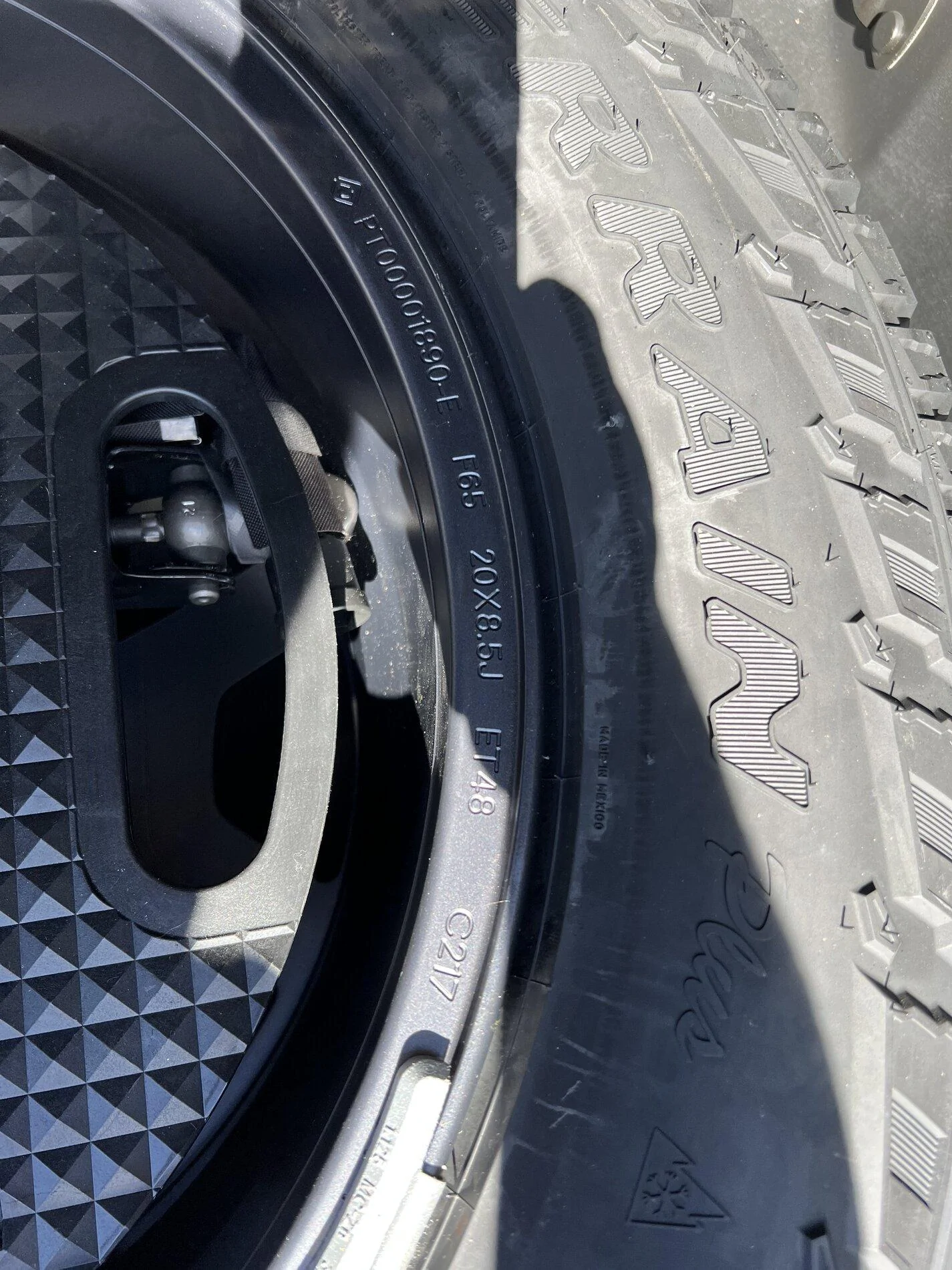

From the hub at Venice. 20x8.5 et 48
Bolt pattern 5x5.5”
I don’t know the center bore
ram wheels do come in 20 and 22 with this bolt pattern but et closer to 28, so might work but wheel will stick out and widen the track

I don’t know. The rep at the Venice Hub, had the bolt pattern specs, but did not know the offset until we looked at it.
If you want the 20s and need range, I’d change the tire to an all season in 275/60/20 this is about 33” tall, same as the 21 and 22. The all terrain 275/65/20 is 34” tall,

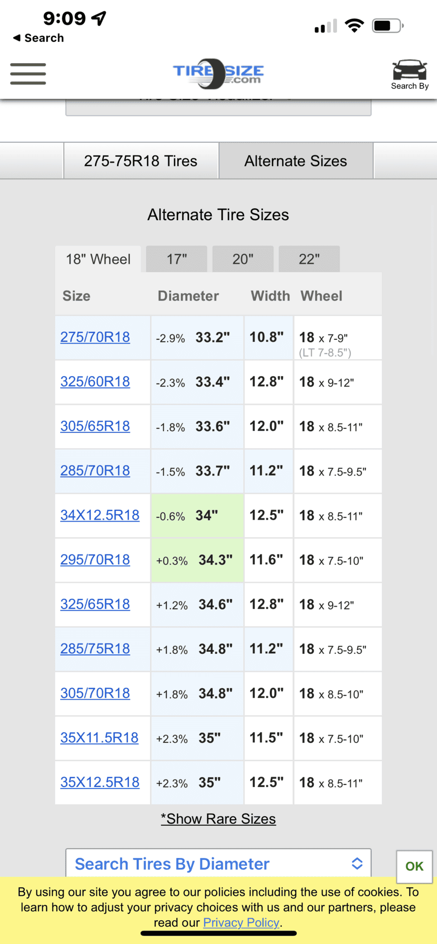

if an 18” fits, the tire would be 275/75/18 to be about 34” tall. But that size does not exist. 285/70/18 could be a good fit.
