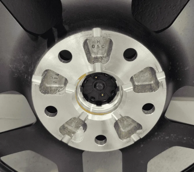

I found a picture of the back of the 20" and surprisingly there is a cut out right where the stock studs would stick though so we might even be able to do something like a 1" or 1.5" spacer even if the studs are slightly longer than that.

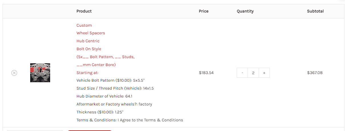

I like the idea of using a hubcentric spacer though and no one seems to make ones that are the right fit 5x5.5 m14x1.5mm 64.1 center bore but I did find this website that you can customize the spacer but they are expensive so I would want to get it right.
(Stock 275/65/20"
a 1" spacer would be +23 offset (out 25mm) and from what I have read should not rub
a 1.25"spacer would be +16 offset (out 32mm) might rub a little. this is what im thinking of trying.
a 1.5" spacer would be +10 offset (out 38mm) and will probably rub a little on low.
https://www.uswheeladapters.com/shop/5-lug-custom-wheel-spacers-hcez/
(Stock 275/65/20"
