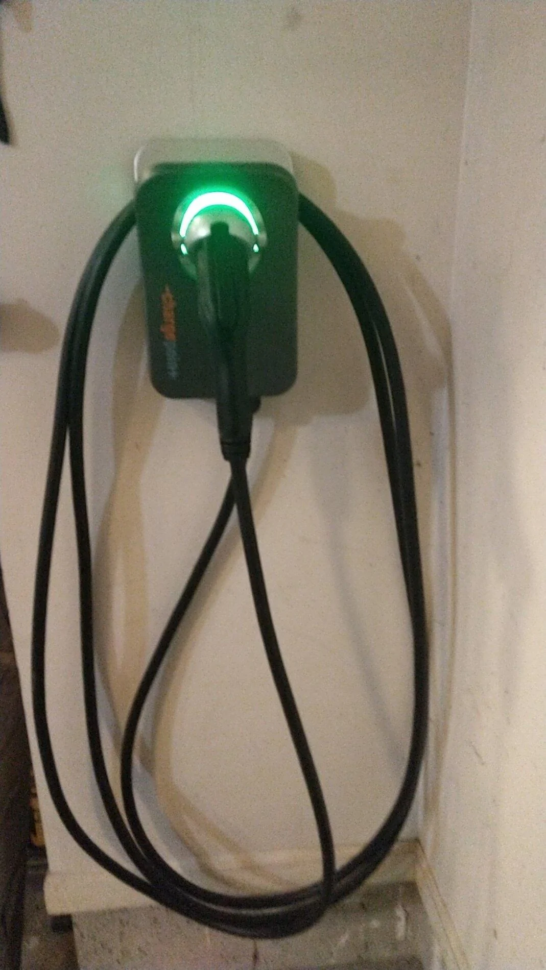

Just installed Charge Point+, Hardwired on 60Amp Circuit so I can run at 48Amps
I have this but athe 32amp version. I doubt I can upgrade due to eletrical panel limits so Ill just be sticking with this and have a slow trickle charge :)
