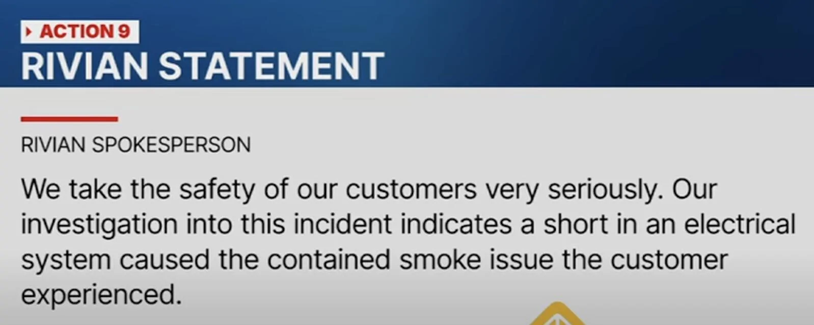

WFTV Video - In a nutshell, she was driving, the R1S bricked on the road and smoke came out of the vents. Rivian or Roadside Assist told her to call 911. She could not get out of the vehicle for 45 minutes until someone discovered there is a manual emergency door release.
She was on the phone with "Rivian Support" - not sure if it was truly Rivian or the Roadside Assistance. But why did they not tell her about the release? Isn't that a basic responsibility for Roadside Assistance even if it is a 3rd party provider? It should be.
This should serve as a PSA for everyone to remember/check out the Emergency Release access panels in our RIvians AND tell our family members about it.
Rivian said it was an electrical short. They offered $1k as goodwill compensation, but the owner didn't trust the vehicle and Rivian took it back.

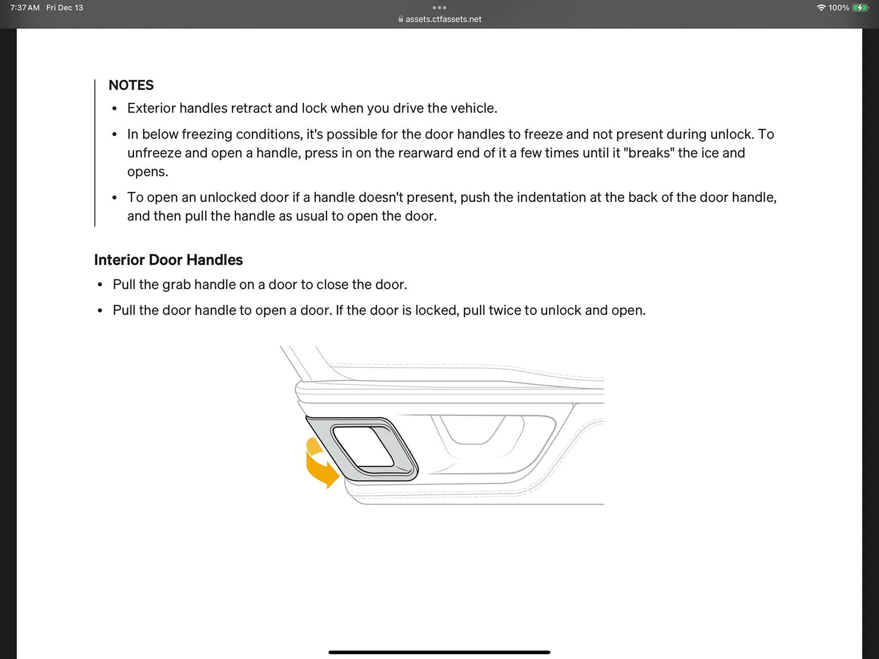

A couple of thoughts:
My Gen1 R1S has the double pull function for locked doors, like our BMWs have had for decades. If the door is locked, you pull twice. In the BMW it's a mechanical system. In the R1S it sounds like a mechanical system, so I wonder why she could not get out, unless it was broken, or does it need power. ?‍♂
I just searched through the manual. The emergency release is not documented. Rivian needs to fix that!

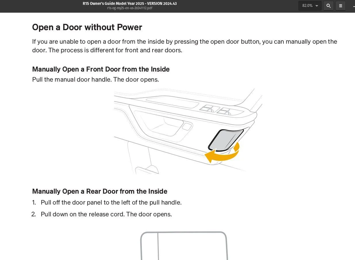

Gen1 uses a fully mechanical door handle, so not dependent on vehicle power but does require a double pull as commonly used on ICE vehicles for decades. Assuming the story is about a Gen2 vehicle.
Sorry, but emergency release for Gen2 is clearly documented in the User's Manual (note: there are different versions of the manual by model year). And for the front door, the manual release is in plain site - not even hidden behind a panel as in the 2nd row or in a Tesla.

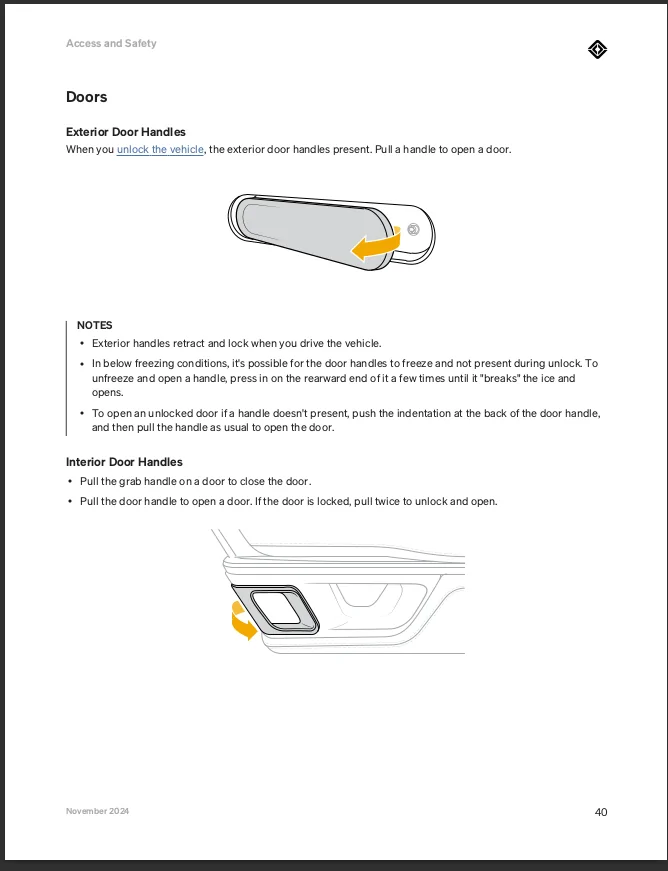

In the Gen 1 manual it doesn’t specifically note it for emergency purposes but this is what the manual says about doors.

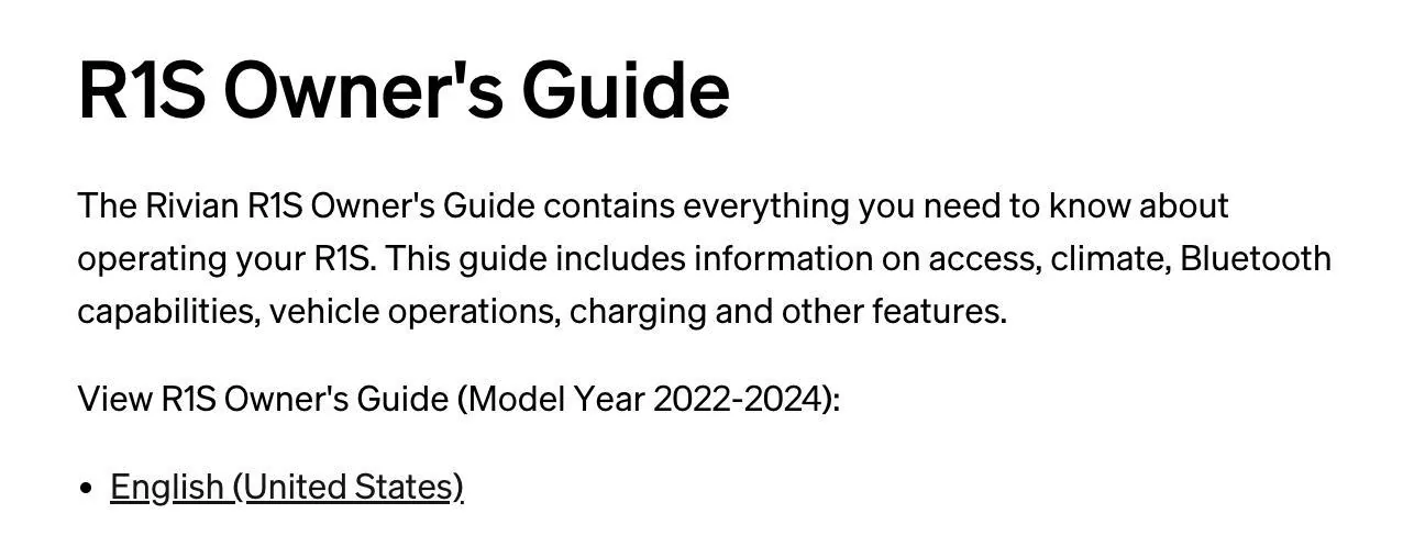

I searched the 2022-24 owners manual as linked on the Rivian web site here . Text searching for either DOOR or MANUAL, that page does not exist.

Apparently you need to brush up on your search skills because the info is in the manual:
