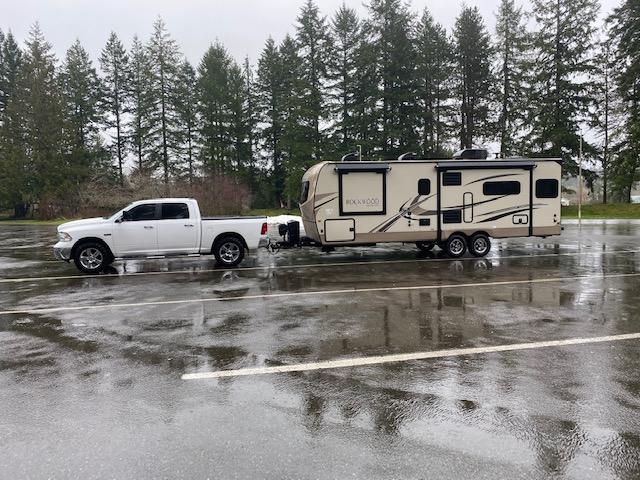

I use the Reese Steadi Flex. I like the built in "brake pad" sway material and the hitch lets me lower my tailgate with the trailer hooked up. Very happy with it. . Many people use the Anderson and swear by it!
RAM 1500 Crew cab Eco diesel towing 6800 lbs Rockwood 2612
