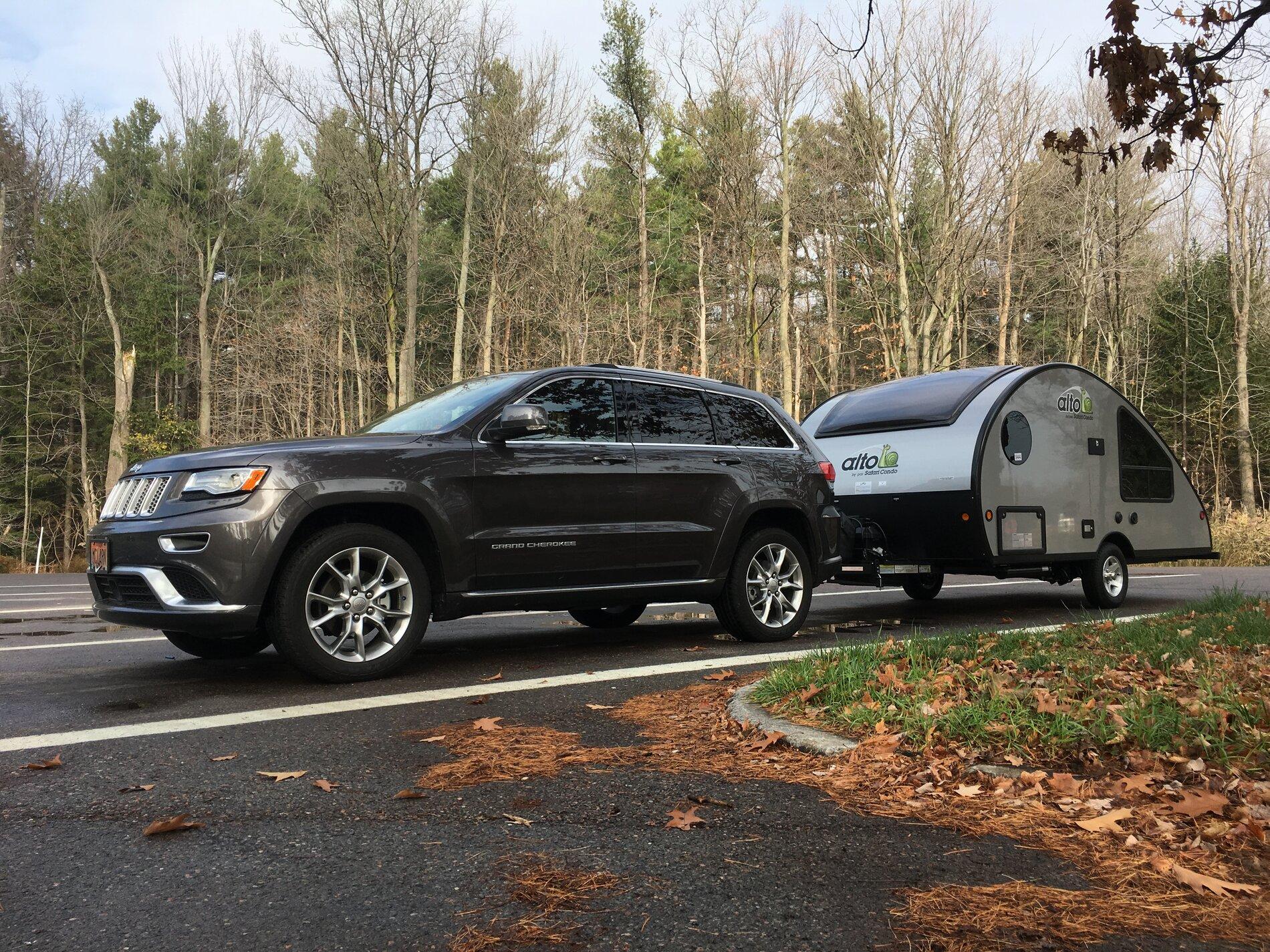

While I can't speak to which weight distribution hitch is right for your rig, I strongly believe it's a vital safety requirement. I tow a very light camper (2000lb) and I can really feel the difference when I don't have the bars installed. If you plan to take a a trip of modest to long distance, you'll absolutely want it. Especially on open roads with crosswinds. I recommend working with your Airstream rep to get the right system. Installation is critical as well.
