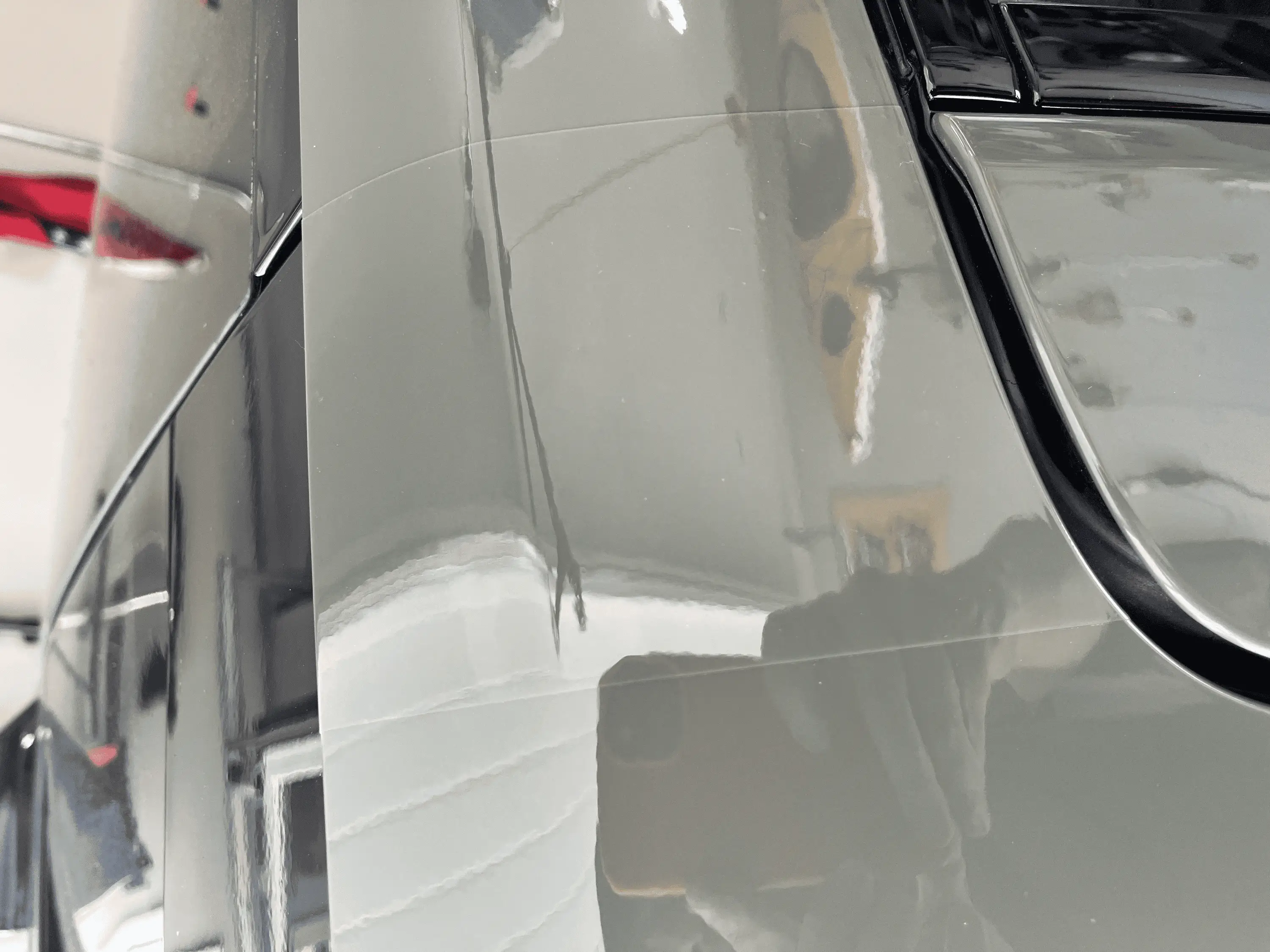

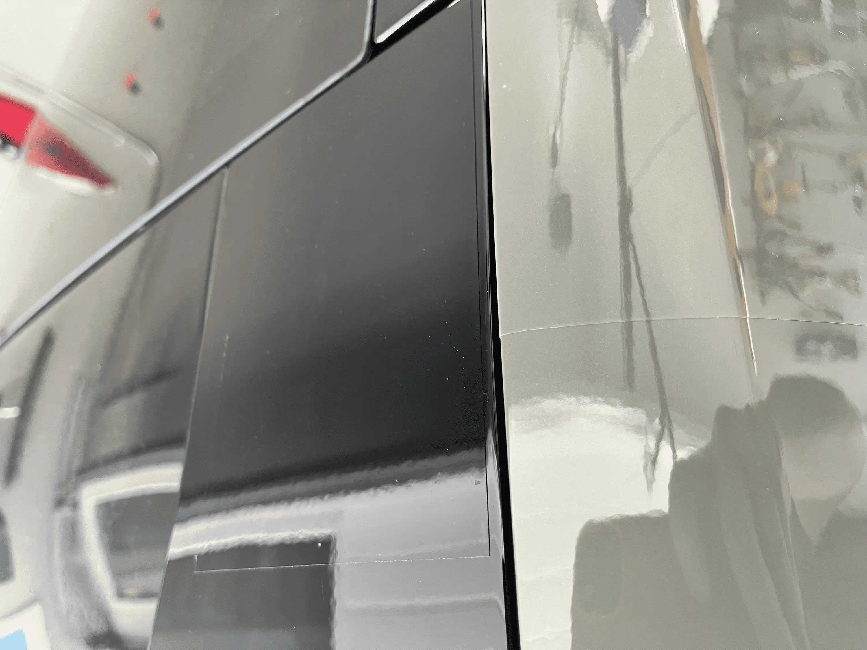

I am going to attempt to install my weboost (rear passenger side near back of truck)this week after I get ceramic don't on the truck. since the roof is not steel, I attached a small piece of xpel on the part of the roof I will attach the exterior antenna with double sided tape and the side of the truck that the wire will be in contact . with. I plan on putting the amplifier in the gear tunnel and will route the wires through the center armrest and tuck the exterior wire in the back window and headliner gap. The inside antenna will try to follow the back window and rear door gap to the carpet finally to the center armrest. Hope to complete the install next weekend.

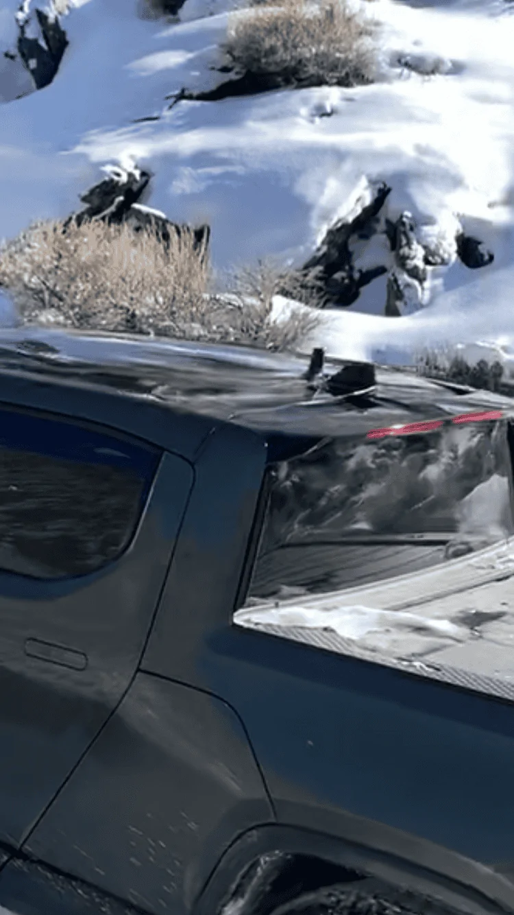

I actually had this thought as well. keep it stowed and bust it out when needed
Yeah I just run it through the back door. Only have it put on long trips so it’s what eves for a weekend.
