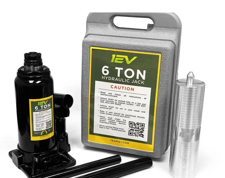

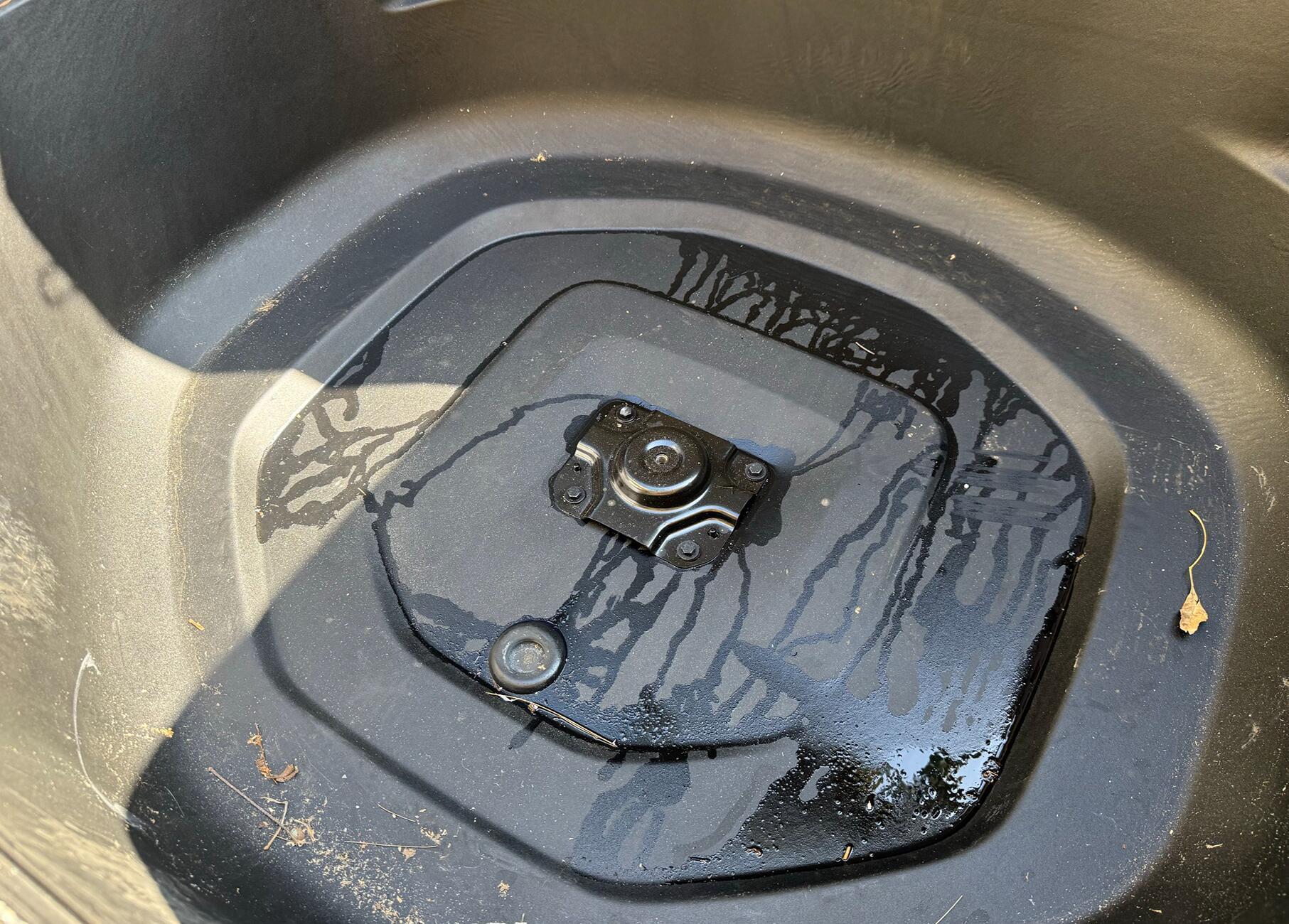

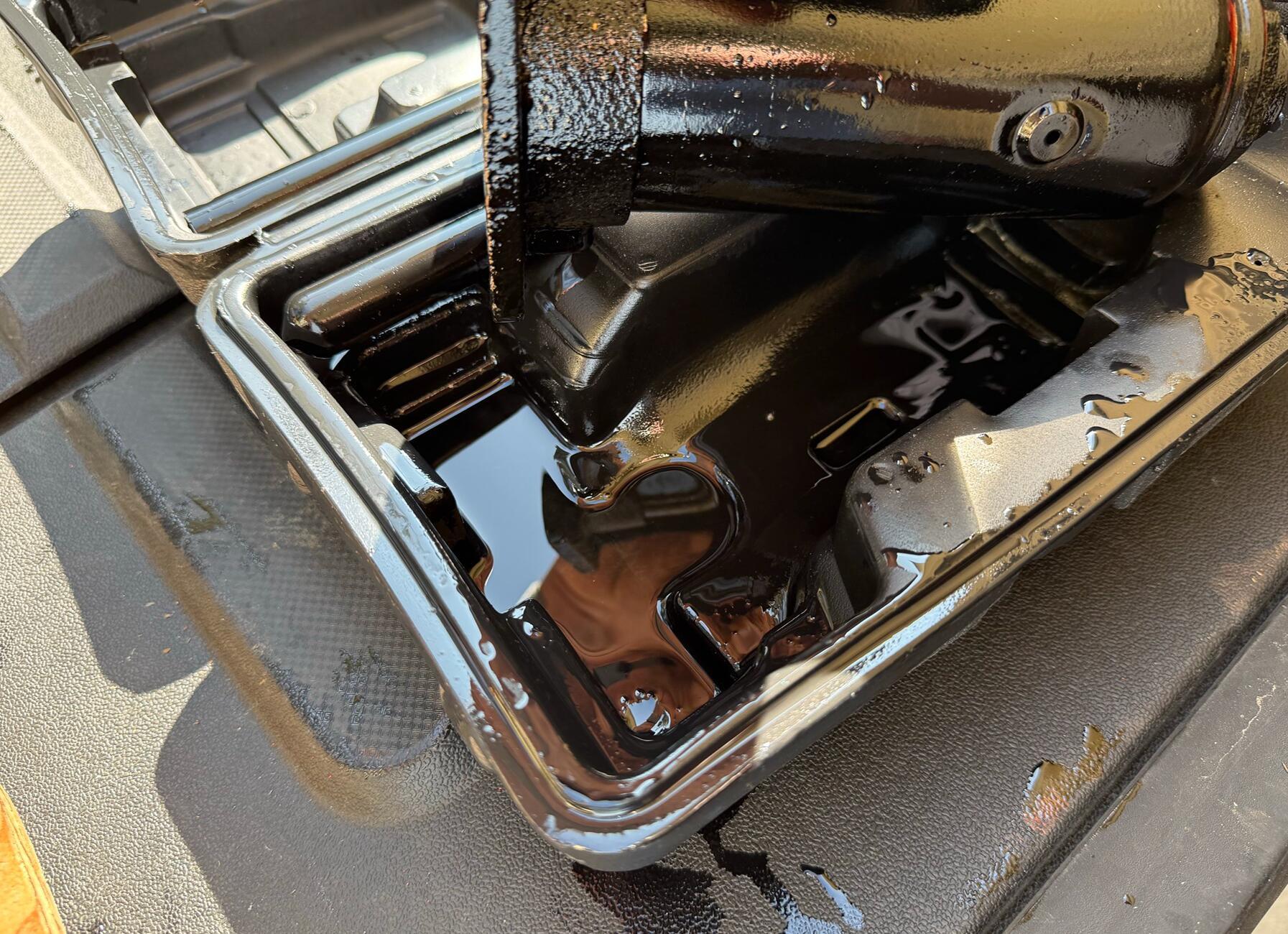

Warning for anyone who bought the @EV Sportline Rivian specific 6-ton bottle jack...go check on it.
I bought the EV Sportline jack March of 2023. Rivian wasn't selling spare kits at the time so I built my own. Never used the jack once, but put it in my R1T spare compartment in case I needed it. Well, I needed it. Went to change a flat tire and instead of finding my nice unused kit waiting for me I found a mess of hydraulic fluid everywhere. I needed to call AAA to come change the tire for me. Store it and forget it emergency gear can't fail like this.
Also, it might be a bit nitpicky but the rubber gasket on the jack puck had broken apart. The spare gasket was still good.
Needless to say, I won't be using EV Sportline products for anything critical.
I thank you for your post. I have never owned a bottle jack but I never would have thought that you can’t store them on their sides or else they’ll leak oil everywhere.
Is this really true for all bottle jacks or just some designs? I could imagine a “premium” design that has check valves of some sort, but it’s going to cost a few more dollars to manufacture.
I own a floor jack and store it in the case every which way except vertical. Never had a leak by storing it. Never had to read the instructions either.

1. if storing it flat leads to failure, it would seem like a good idea to print it and include it in the instructions. How many people scan a QR code on a jack to read the instructions online when they are included printed in the product. This is a CYA situation so you can modify the instructions after you've shipped the product to customers.
2. It clearly states "recommended" and not required. As a Rivian specific jack it can't be stored how you recommend in the R1T spare compartment like I'm sure 99% of R1T buyers are storing it. Even if "recommended" was printed on the box most R1T customers are going to lay it down when it doesn't fit standing up.

To the OP, thanks for the PSA however, storing any bottle jack upright is SoP as those seals can and do leak (not always, but it's not uncommon).
EV Sportline has gone way above the call of duty here by offering a replacement jack for what is ultimately user error.
