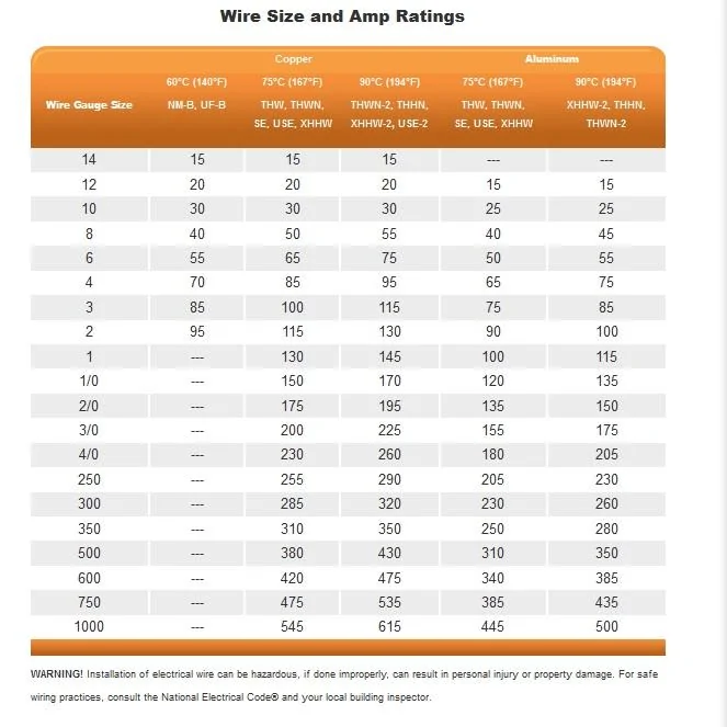

For reference...
Rivian R1T R1S Wall charger installation at home - suggestions and recommendations? ⚡️⚡️ Ampacity Chart

I see a lot of posts mentioning installing a 60amp breaker for No. 6 THHN wire which is derated to 48amps under continuous load.
The No. 6 THHN is derated to keep heat down under the full 48amp EVSE load, but using a 60amp breaker will allow that circuit to run up to 60amps if things go sideways and could heat up to an unacceptable level.
Wouldn't a 50amp breaker be better protection for wire that's max rated (again at continuous load) at 48amps? The whole idea is you want to protect the wire from carrying a continuous load of over 48 amps for safety reasons.
THHN 6AWG is rated for 75A at 90 degrees C. Using a 60A breaker is fine.

^ thanks @CommodoreAmiga ... I was looking at the wrong column on my own chart! o_O
I see No. 6 THHN is rated for 75amps regular duty and 60amps for continuous duty.. so the 60amp breaker could be used for the Rivian EVSE setup.

THHN 6AWG is rated for 95A at 90 degrees C. Using a 60A breaker is fine.
Please cite your source for this, I’ve never seen THHN listed for over 75A at any temp rating.
Breakers are not as precise as most people think. They will trip for going overcurrent, but this can take much longer than you'd expect. For example, at double the rated current (100A on a 50A breaker), 10 seconds would be a reasonable expectation. What's more, a very-long-running 48A load on a 50A breaker could actually cause nuisance tripping from the heat since that breaker would only be rated to service a 40A continuous load.
THHN has 90C insulation, and you can use the 90C column as the starting point to derate for ambient temperature or multiple circuits in the same conduit. But breaker terminals are generally only 75C. If you are not running multiple circuits in your conduit (and if you don't have to de-rate for ambient temperatures), you should just go straight to the 75C column when sizing your wire (unless you're working with Romex or UF, both of which require use of the 60C column).
