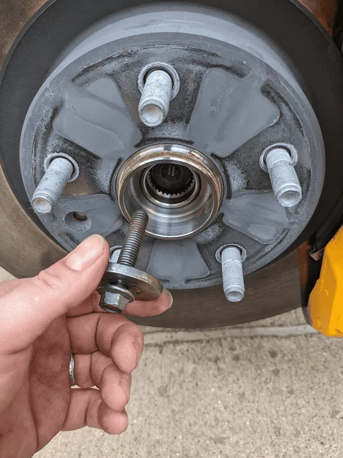

Also, front hub bolts loosening and pushing out the center wheel cap.

@mini2nut @NY_Rob Are those issues your tracking/seeing on 10,000+ VINs or earlier VIN’s?
10,000+ VIN's are just being delivered now so not much time for new owners to discover some of the issues yet. But, in that list... most of those issues are still happening even with the newest vehicles.
Take em' one at a time..
-Steering wheel wobbles above 60mph.. still a problem w/no 100% known fix yet (Rivian has mentioned updating to a heavier steering wheel, but that hasn't happened yet).
-Pulling to the right.. out of spec alignment right from the factory- fix requires SC visit
-Glass roof breaking.. still a problem, same thin glass- not fixed
-Tonneau cover failing.. lol.. redesign in progress- no fix available at this time
-12v Batts going bad.. still happening on the newest of trucks- Rivian replaces the two 12V batts as fix
-Seat belt recall... only applied to a limited set of VINs
-CV joint failures.. still happening- replace axle half shaft
-Loose underbody bolts... notices are being sent out to new owners every day- requires SC visit
-Wet spots under driver floor mat.. still happening, cause not yet known- not fixed
-Excess cabin wind noise... still happening- varied "fixes" required depending on cause
-Creaking sounds when accelerating... still happening- known fix is available at the SC
-Passenger side lower than driver side.. still happening- cause unknown so far- not fixed
As far as we know, no major redesigns have been applied to the R1T yet.
