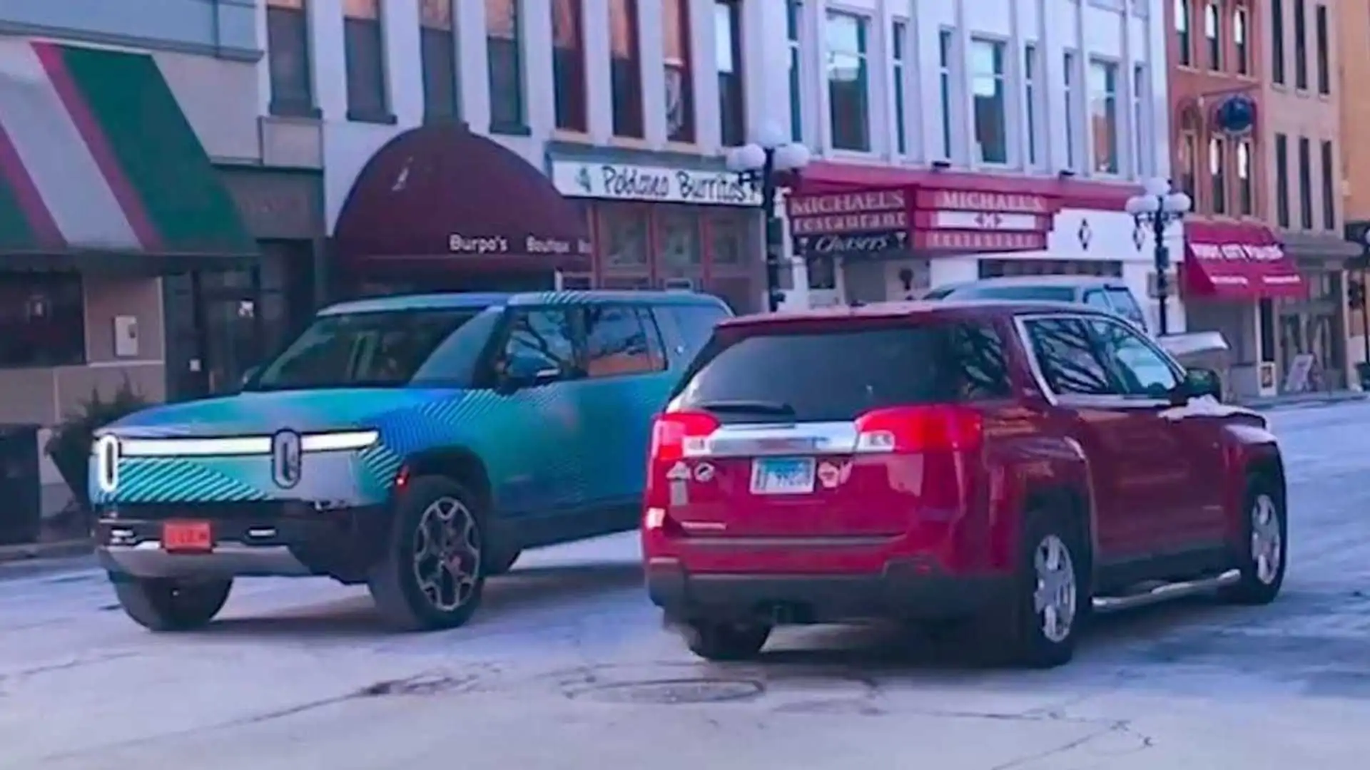

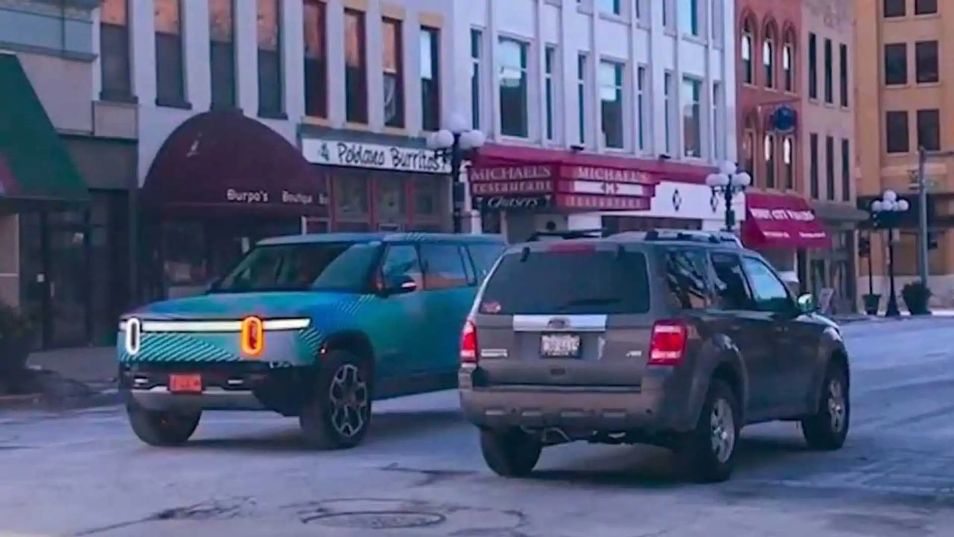

From a video shot in downtown Bloomington. Not side by side unfortunately, so have to keep in mind the different distances/perspectives of the vehicles.
Screenshots
Hmm, that turn indicator again surrounding the stadium light shows up again, hoping it makes its way back to the end caps of the light bar.

Second observation after breaking away from the trance inducing wrap... I notice that the headlights double as the turn signal (which look awesome). However, I believe in the states that there is a requirement that a portion of it be visible from the side. I thought that the light on the wheel well would also blink so that this requirement would be met but from the video that is not the case. I guess the light on the mirror serves that purpose? This makes me wonder what the purpose of those wheel well lights are...

Not a fan of the change to the stadium light being the turn signal. I thought it looked better the other way.

Personally, I wish they kept that outer portion of the main LED light bar as the flashing turn-signal. Having that last foot or so flash yellow would be much more likely viewed or noticeable from the side turning into. Flashing the stadium lamp will not be visible at all from the sides.

I like the stadium lamp flashing. It looks more quirky.
In the prototypes they didn't have a side light on the fender, so they HAD to flash that part of the light bar to comply with DOT restrictions. Since they've now added a side light on the fender, they will likely use that as part of the turn signal.

While I would prefer this approach, there are turn signals in the mirrors which handle the side view.
