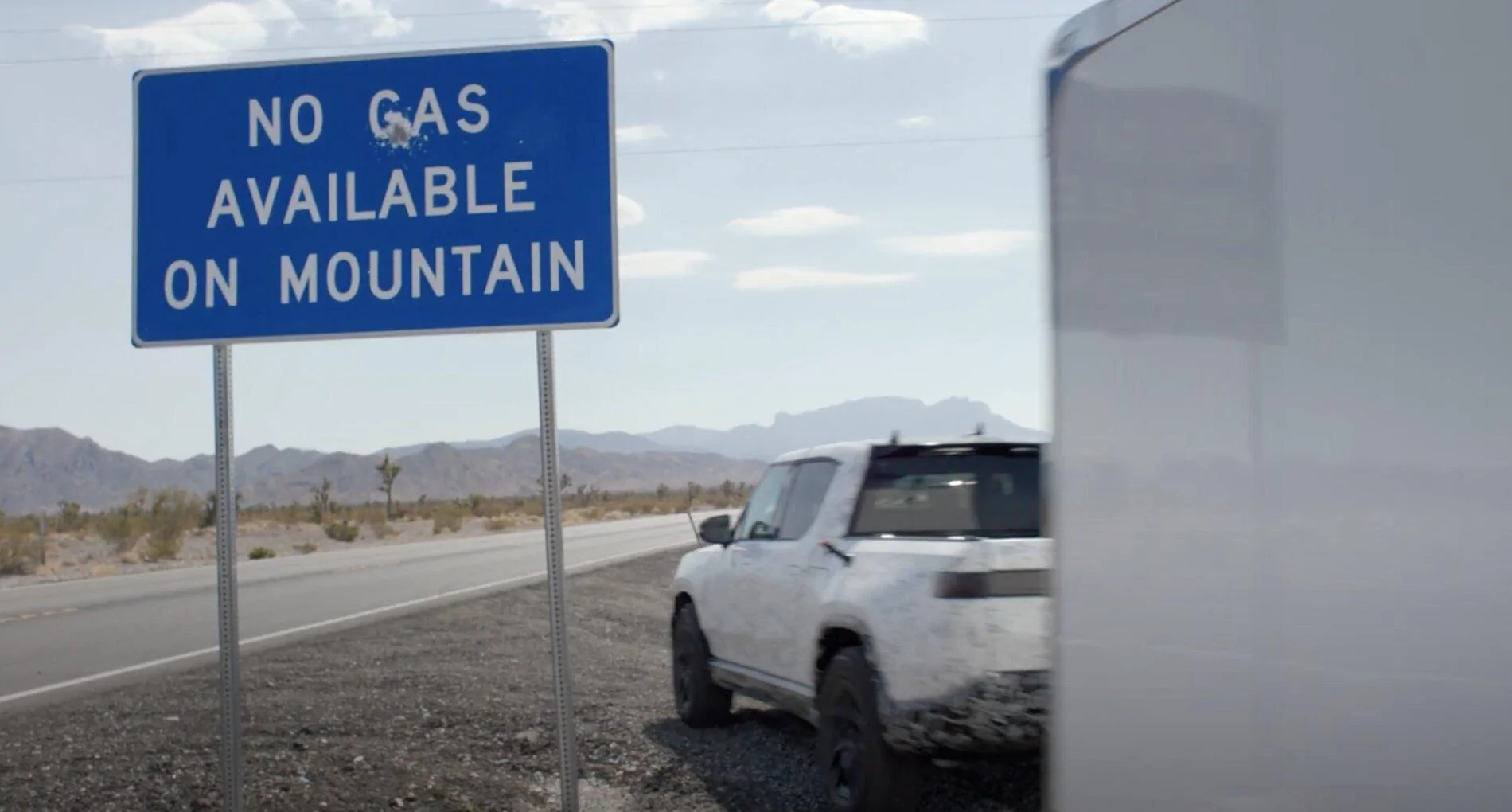

Last month, R1T validation continued with hot weather towing exercise, which included the SAE’s Davis Dam certification site and runs through Death Valley. Towing 11,000 lbs up high grades at 118º F demonstrates the capability and robustness of the R1T. Check out our latest blog post for all the details. stories.rivian.com/hot-weather-towing.

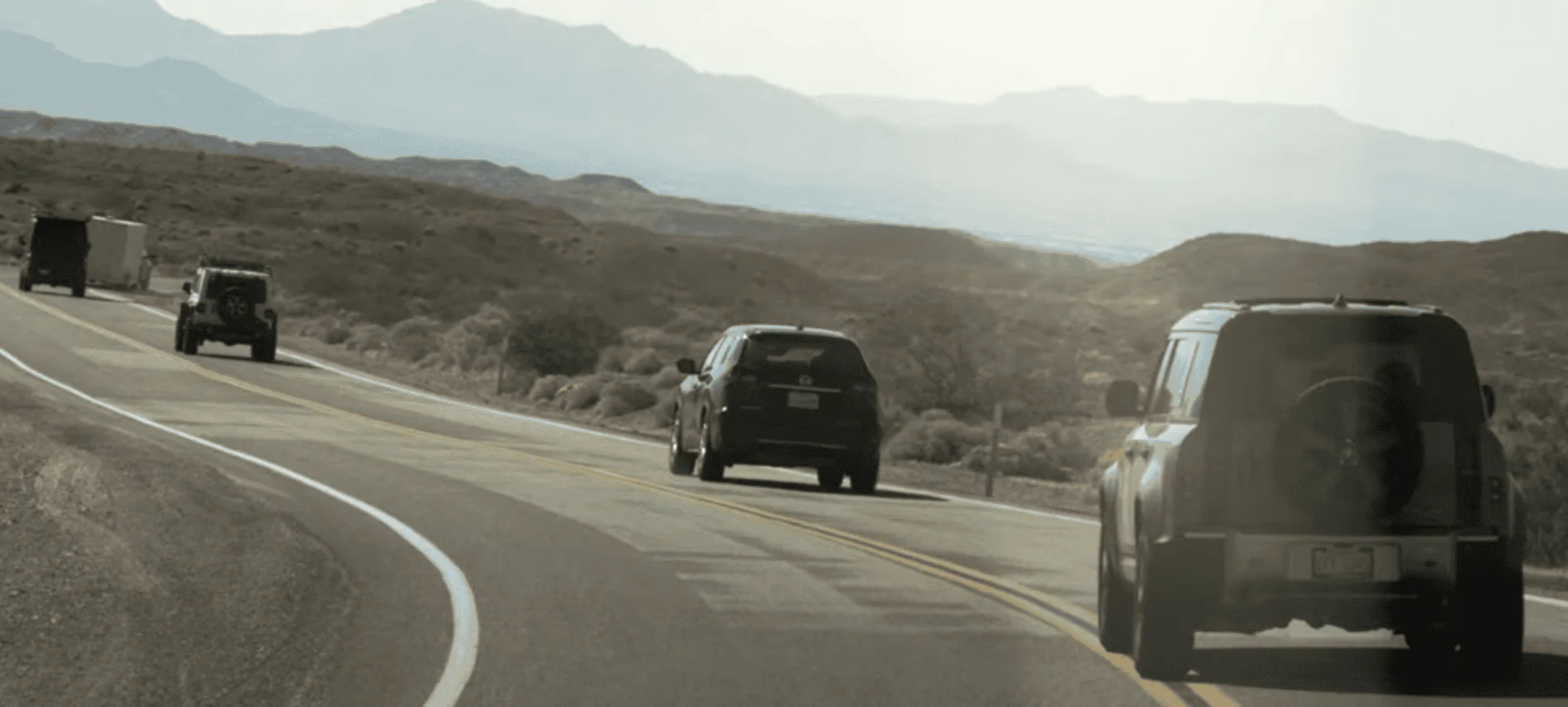

Anyone have thoughts on what type of testing & if we'll see it?
Also, I wonder what other testing/benchmarking is going on. There is a Jeep Wrangler, some sort of Nissan CUV/SUV, and a Land Rover Defender 110. I saw several Dodge trucks in the other towing video as well.
I hope we get to hear or see the results of whatever comparitive testing they're doing!
