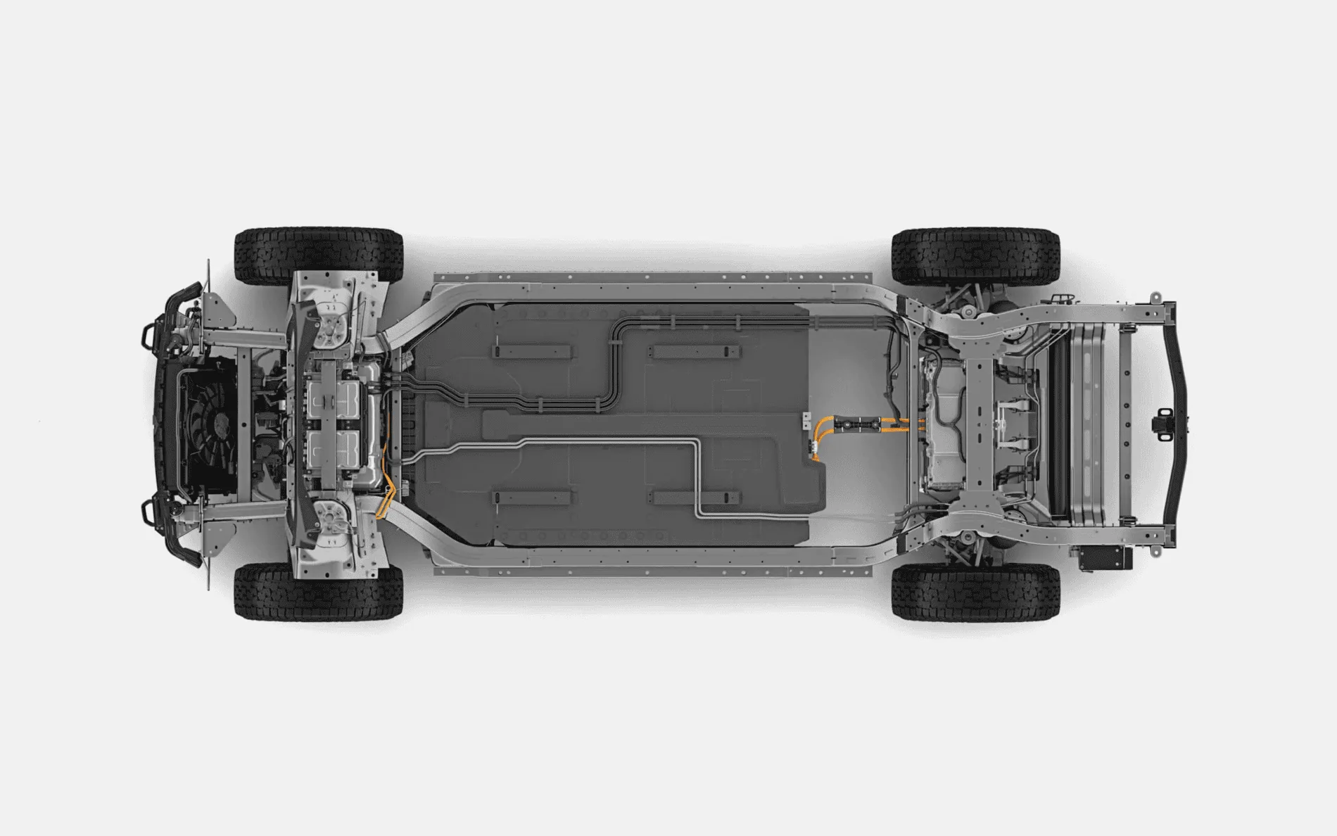

I also am trying to design the method for securing one or two Altas (electric dirt bike) in the back. In the front there looks to be two rows of bolts on the front wall that could accommodate a rail/carrier for the front wheel. I may use a simple chock or a cam devise like the old ATK Bike Shoe. At the rear I need to know where the wheel will sit and in particular the foot pegs. I will need to drill the bed for some small rails that I will attach foot peg cams so as not to have need for tie downs. What I don't want is drilling into a battery area so I need to get more detail of the structure under the bed at the back, towards the tailgate. Anyone have pictures of that area?

Rivian has multiple pictures on their website that may be useful. Here is a top down view, but there are other angles:
Rivian R1T R1S Video: R1T spotted on the highway 1611158120437
We don't know how final any of them are, and what may change, but it would be surprising if we found an extra battery crammed in the back behind the rear wheels, which I think is the area you're talking about.
I've been looking at the same thing to support a bed rack, and my concern isn't what I might drill into on the other side (although that is a real concern, I'm guessing it will be obvious once I have the truck in front of me), it's the fact that Rivian calls it a composite bed, and it isn't really clear what that means. I've asked Rivian, and got the usual "more details are coming".

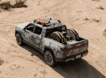

I am not quite sure how they mounted the spares in the Rebelle Rally truck, knowing what they did during the Rally and how secure they seemed to be, I would assume that this setup was pretty sweet. It definitely looked the part.
Rivian R1T R1S Video: R1T spotted on the highway Screen Shot 2021-01-20 at 8.25.20 PM
