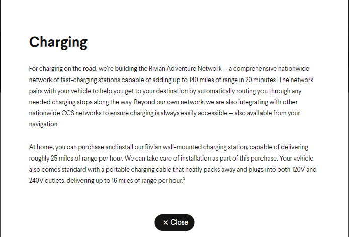

Seems they are wrong when saying Level 2 is limited to 16 miles per hour added range?
They are wrong. The R1T/R1S come with an 11kW onboard charger. At an estimated energy consumption of 425 Wh/mi, this equates to 25.9 miles of range added per hour of charging. This, of course, requires a 60amp breaker hard wired to 48amp charger to get 11kW.
16 miles of range per hour would be a consumption of 688Wh/mi which is absurd.

They've stated peak at 300kW, sustained at 200kW, and then "140miles in 20 minutes". To @kanundrum 's point, this is something they should be able to clear up, but it's the real world tests using the RAN sites that will really provide the info we're looking for.
For level 2, my guess is if the person who made that Youtube video had spent more time on Rivian's site and less time making that thumbnail, they could have done a better job,. The site is pretty specific that level 2 will support 25 miles of charge per hour.
The cable that comes with the truck is rated at 16 miles of charge per hour.

All of that data is on Rivian's website...16 miles of range per hour for the portable charger that comes with the vehicles and 25 miles of range per hour for the home charger that you can buy as an accessory...This ISN'T new information. It is just information that no one seems to get right...
