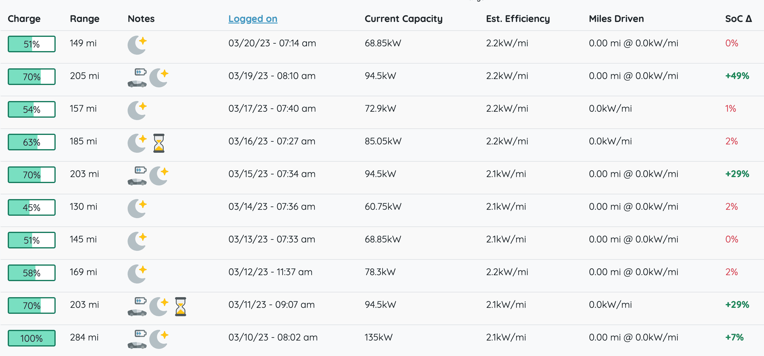

I've held off on posting anything regarding battery drain until I had some good data to share from our R1T. We got our truck in December. We live in the DC metro area, so winter temps at night are often below freezing.
We created a website to track our vehicle usage. Without getting into too many details, the site tracks things like charge %, range, battery capacity, air temp, etc. Over the past three months our average nightly drain is around 1%. I posted a screen shot of our data set from the past 11 days. Positive SOC numbers are nights we charged. With warmer nights we've noticed 0% battery drain. Even when we go back to January/February data, the drain is not significant.
We also track driving with the site and we're seeing better efficiency than what the truck reports. I'll share more data when it's relevant, but I just wanted post our experience with battery drain. It has not been significant.
