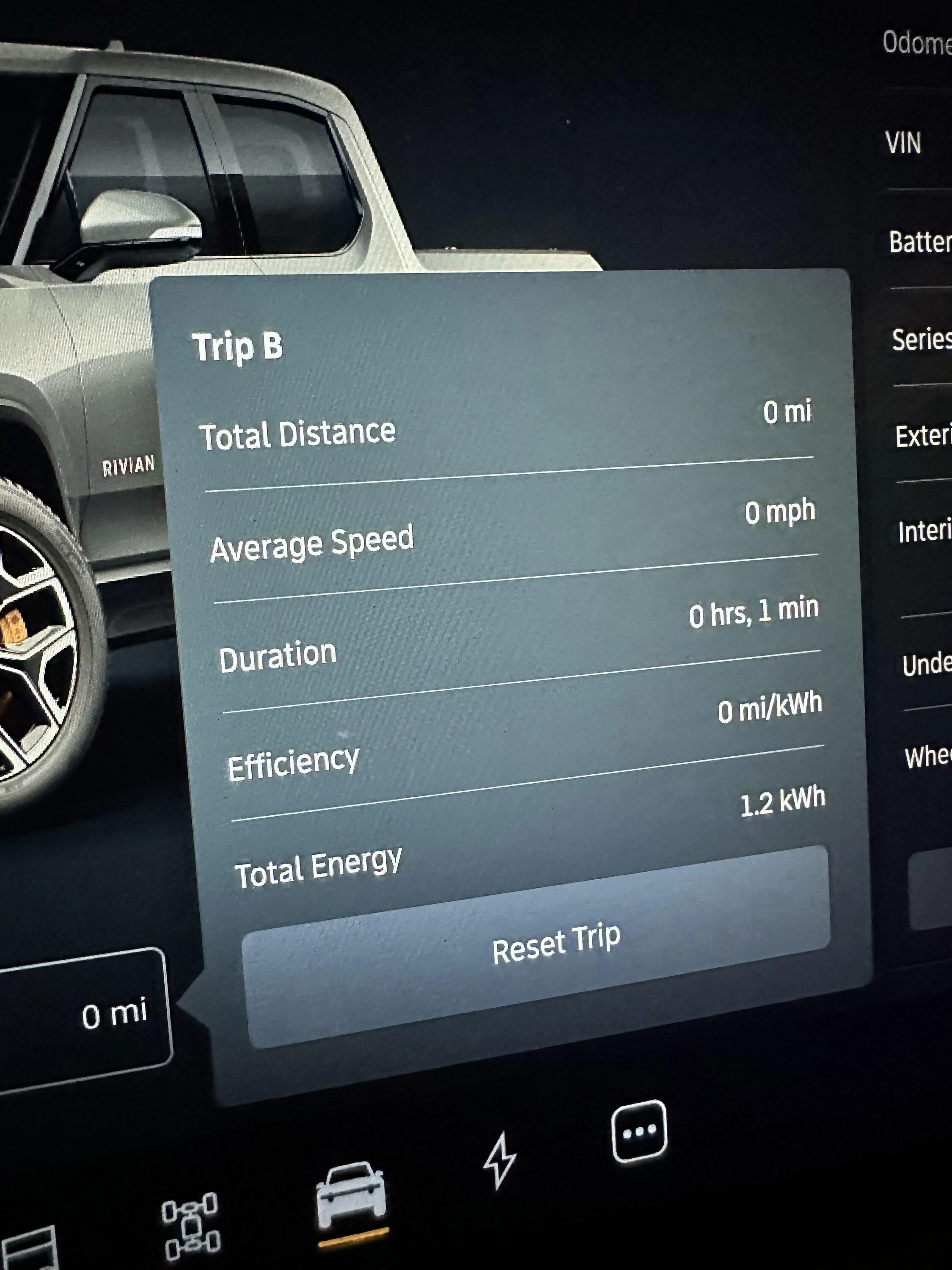

Lost 1.2 kWh last night overnight according to my trip gauge from 9pm to 9am not plugged into my charger, everything turned off, GG off at home, this equated to 1-2 mile of range on the app. 0.1 kWh per hour essentially.

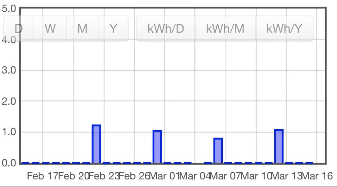

An example from my MINI. I left it parked for the past month because I was driving other cars. I left it plugged in and about once a week it took in 1 kWh or 4 kWh in about 30 days. I've left it unplugged for 2 weeks before and saw no more than 1% of a 28.9 kWh usable pack.
