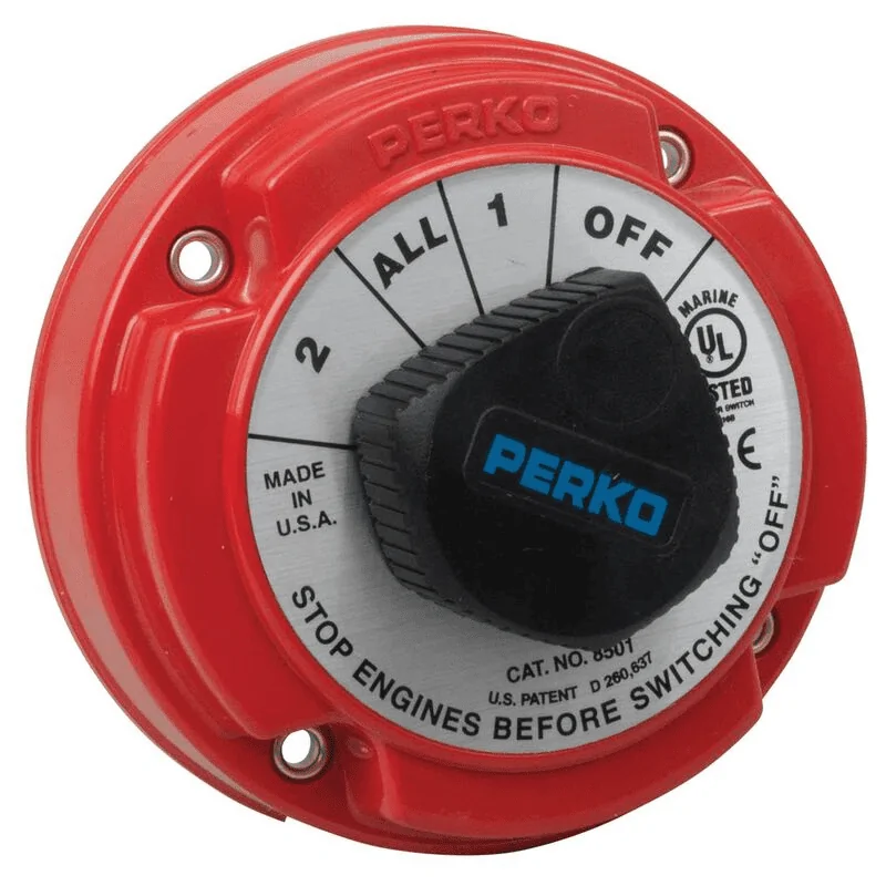

... just saying 😁
Rivian R1T R1S Vampire drain - what's the latest battery % loss people are getting? 1678460341041
