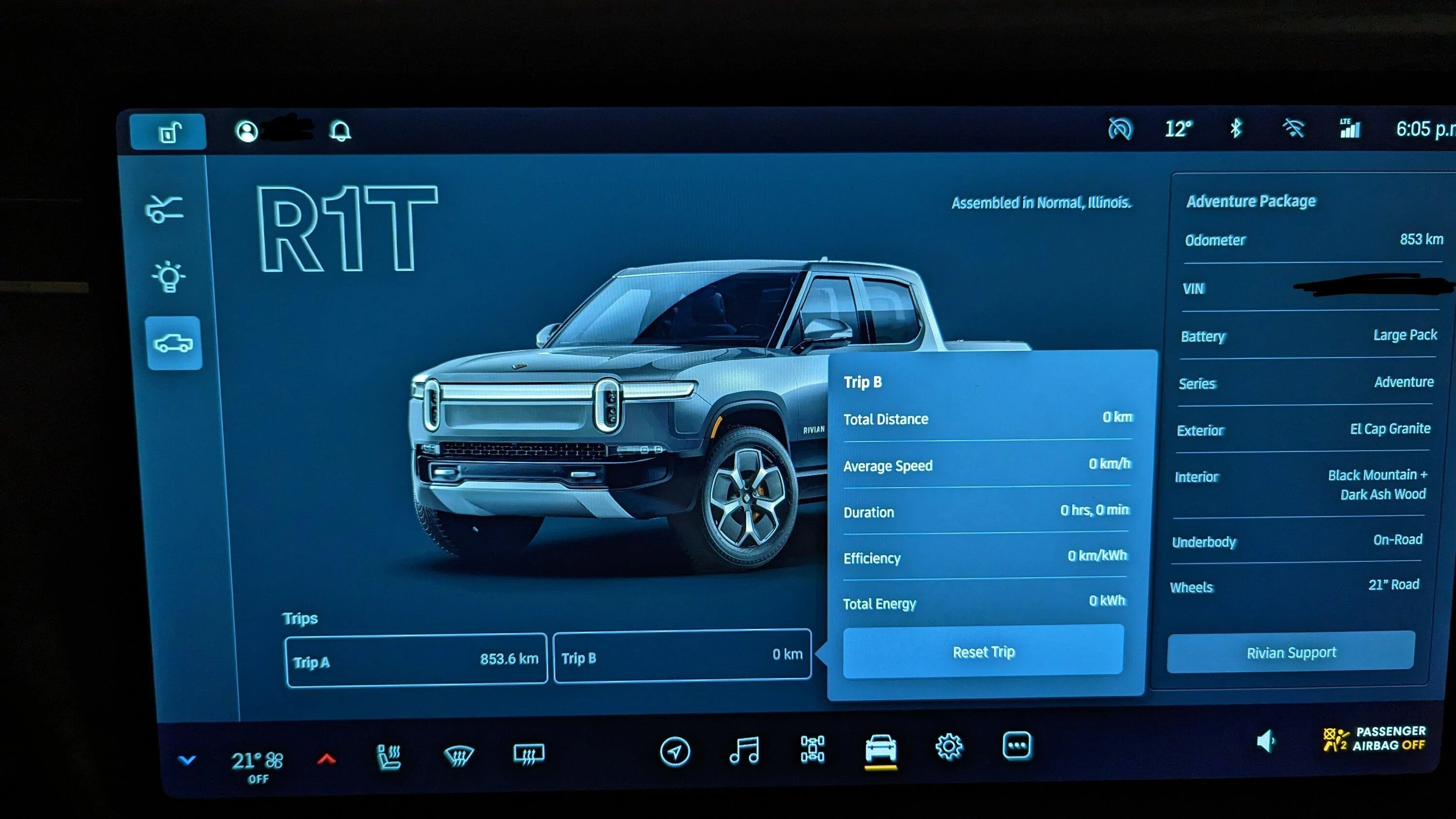

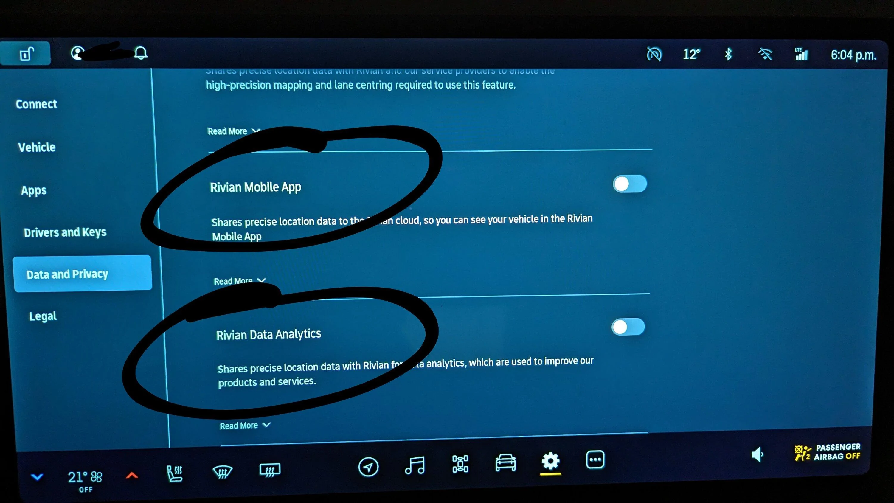

Alright, running my first round of tests of disabling various things. Tonight I'm not going full disconnect of network, just two settings that I think are most likely to be contributing to the problem of data upload and waking up the vehicle:
Rivian R1T R1S Vampire drain - what's the latest battery % loss people are getting? PXL_20230321_010456826~2
For posterity, I've zero'd out the odometer and will check in tomorrow at around the same time to see total energy usage by kWh, not %:
Rivian R1T R1S Vampire drain - what's the latest battery % loss people are getting? PXL_20230321_010507298~2
Temps are at a nice 12 C and stable overnight. PAAK and GG off as well. SoC currently at 62%.
Will be interesting to see if that makes any difference. I think I'll try it at work tomorrow.
Curious to see what comes of this. I've heard of people doing packet captures on trucks connected to their home wifi networks, but I haven't had the chance to as I've always just had it connected to mobile.
From what I recall reading it was pretty talkative with all of the diagnostic broadcasts to the cloud.

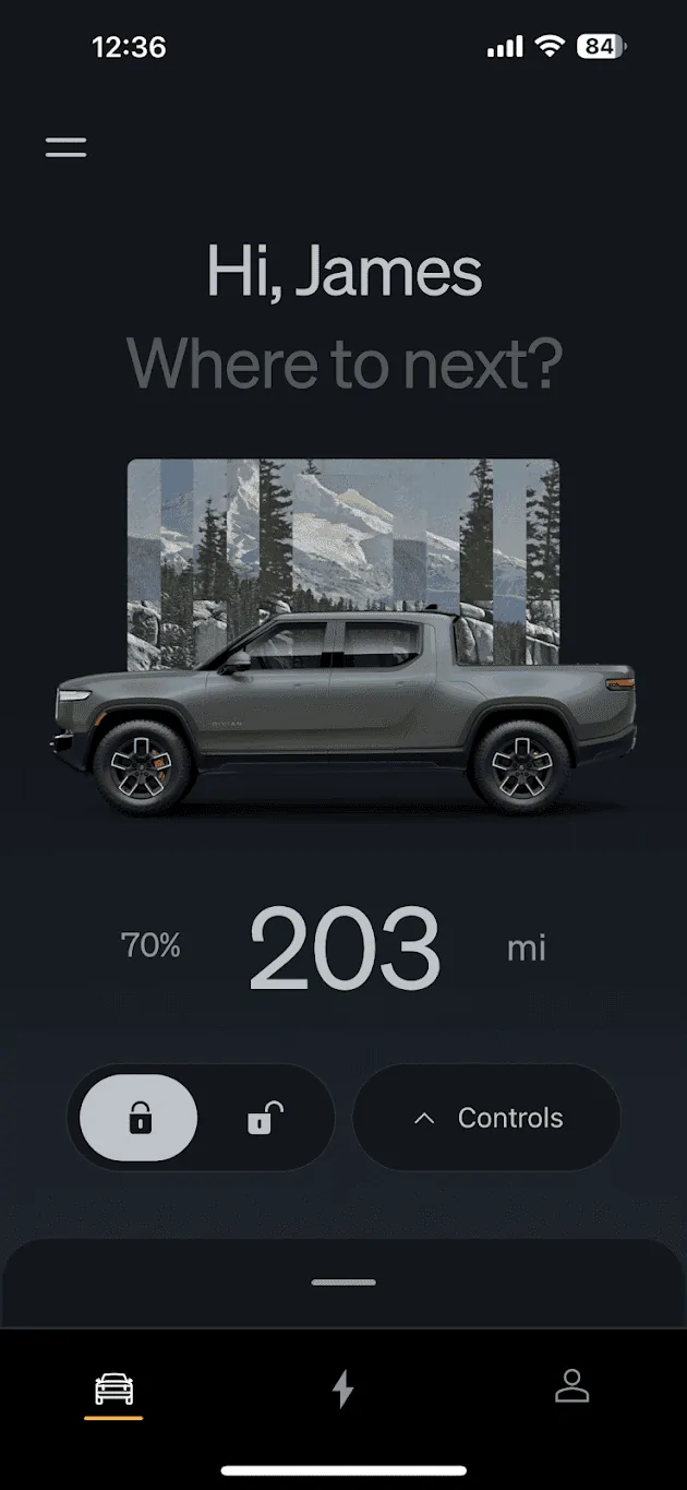

I took delivery of my R1T on Friday. My number 1 concern buying it was the vampire drain. With so many different experiences in the community, it was hard to tell how big of an issue it was going to be for me. On Saturday evening, I charged it to 70% and in the morning noticed that the battery was down to 61%. I wasn't completely sure it charged to 70% though and I think the gear guard may have been on so I didn't want to panic.
Yesterday afternoon I made sure to charge to 70% then unplugged the truck at 12:36pm. The truck was parked outside, low temperature of 46, phone as key and wifi turned on, gear guard off. I never opened the Rivian app during the test. I waited until 11:58am the next day to check for drain. I lost 3% in a little less than 24 hours. It was down to 67%. The eight miles of stated range loss is more than I drive most days. It lost that doing nothing! I charged it back to 70% and it took 4kWh. I'm so disappointed. That's beyond awful. One year of vampire drain from my R1T (1460kWh) is more electricity than my home uses many months, including charging two other electric cars (Model X and i3)!
I'm going to run one more test tonight with climate and wifi manually turned off. I'm leaving phone as key on because I'm not willing to own a $80k vehicle without a proximity based key. If I don't see an improvement, I'm not sure how long or if I can keep this truck. At least for me, it sucks a lot of joy out of owning it. I understand that many people would scoff at selling it just because it wastes $200 in electricity a year but I find the unnecessary inefficiency incredibly off-putting. You wouldn't put up with a gas car venting 3% of its tank a night. Neither of my other EVs waste electricity like this. It's totally unnecessary. I know we're not going to save the planet driving 7000lbs electric trucks but this is just crap engineering and in a year and a half, Rivian hasn't shown they can consistently or meaningfully get the drain down. I'm not confident they're ever going to fix it. Alex on Autos called this out seven months ago and my truck drains even worse than his did. Now I've got to do the math on how much of a bath I would take holding onto it until one of my other EV truck reservations comes up or just turning around and selling it next week. This is not how I thought my Rivian honeymoon would go.

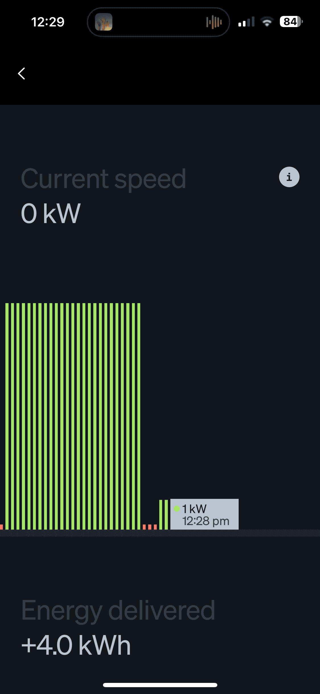

Wouldnā€˜t measuring the amount of power from the wall required to charge to a set level be the most accurate measure?
emoore
Nov 29, 2020
2,500
2,627
Iā€™m surprised too. Itā€™s maddening.
You would have to know what the loss is from the charger. Also on the Rivian app the power delivered by the charger is always a whole number so not very accurate in my mind.
