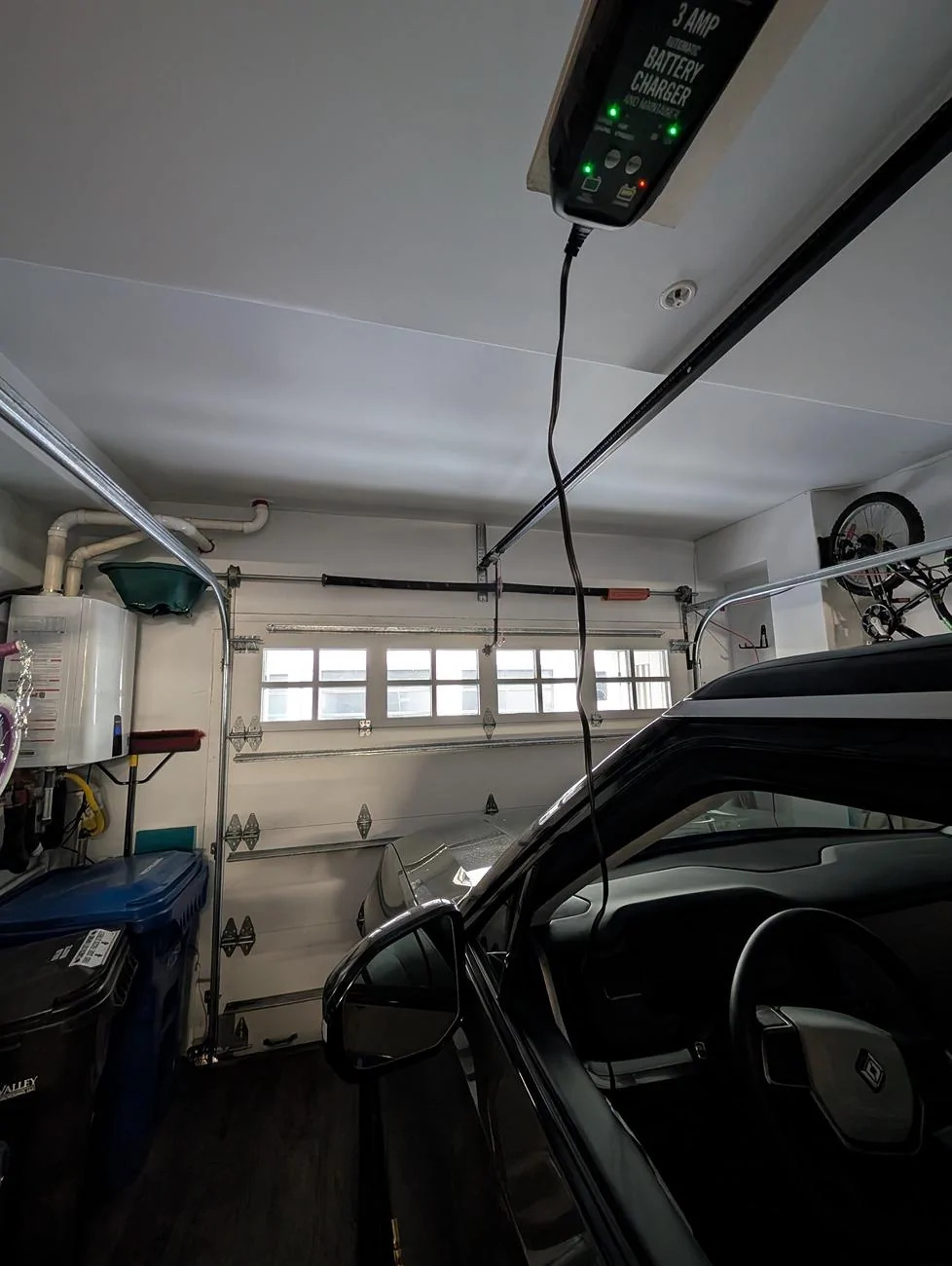

Has anyone run this out the door and closed the door - or just pass through an open or vented window?

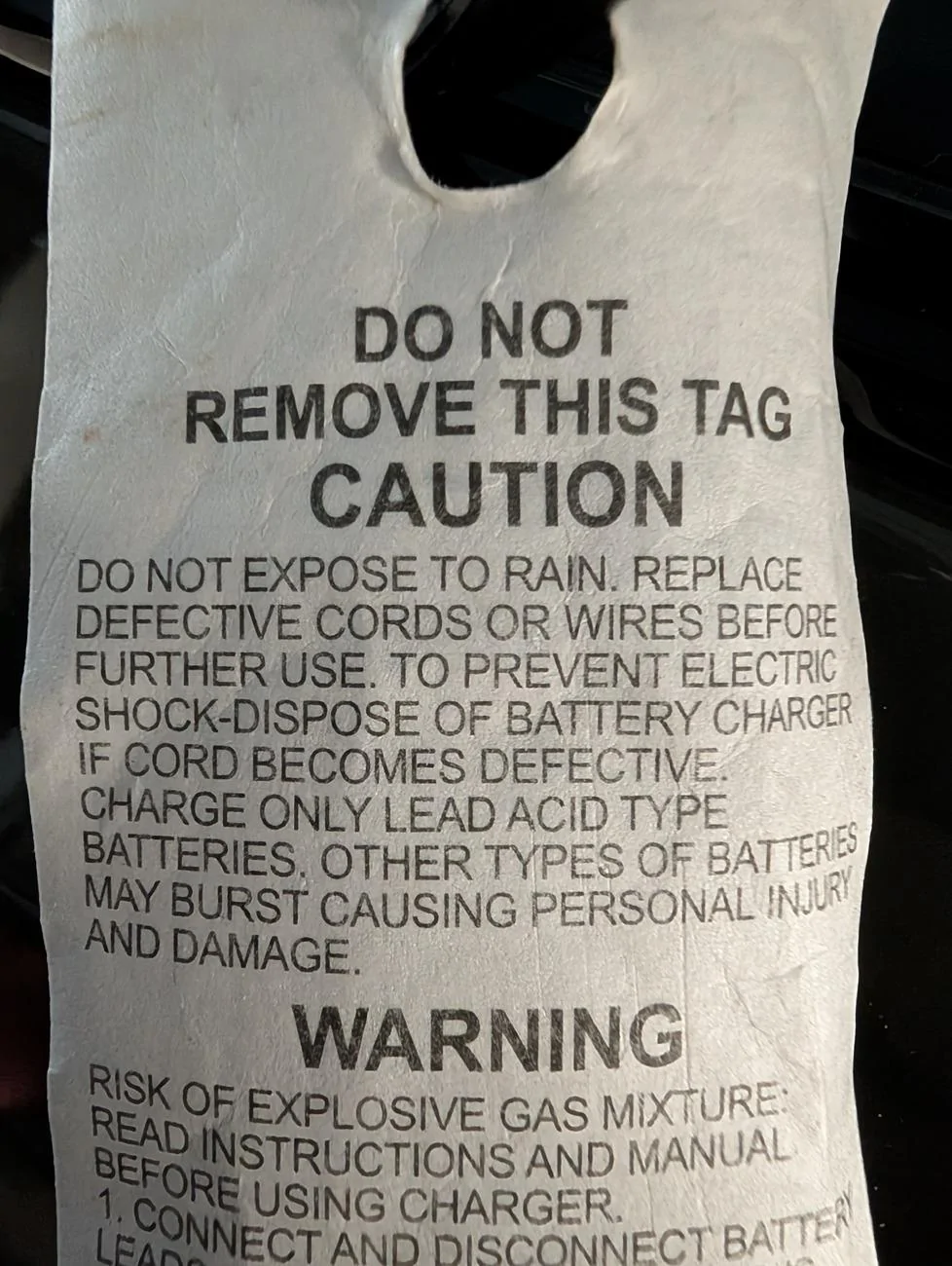

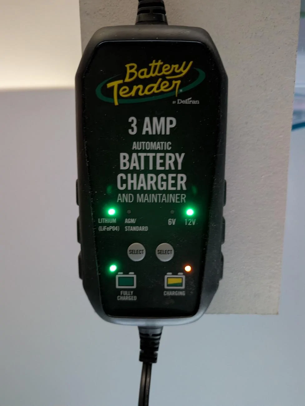

The tag on BT, says only for Lead Acid batteries, but the device is in lithium mode, confusing. 12 V - Do I want AGM Standard or Lithium mode, OP your lights indicate AGM Standard has been selected?

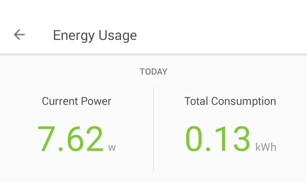

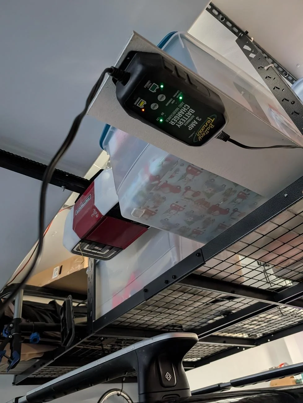

Ceiling/Rack mounted connected via a smart outlet (max 18amp) for easy power off as well as continuous draw measurements.

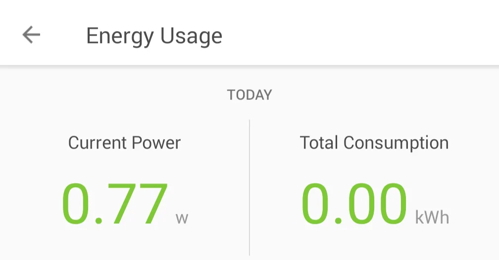

So far, asleep per electrify

You want AGM mode, that's the 12v chemistry.

Yes, AGM as others have also noted. I just run mine through a slightly cracked open window, when garaged. Good luck over your 10 day trip, I'm curious for your results.
