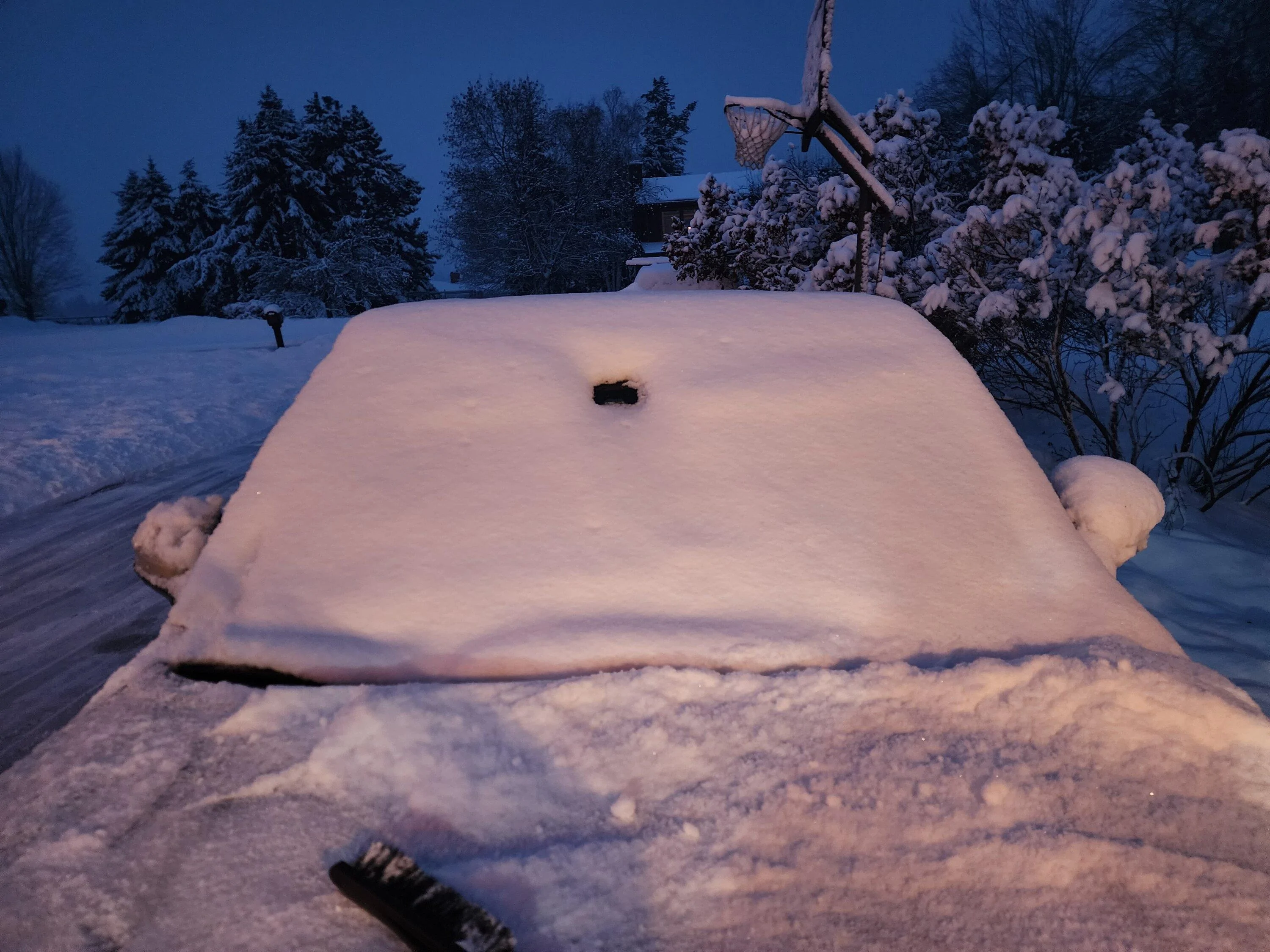

Like many others I've been experiencing a fair amount of daily vampire drain in my R1T. As I posted earlier in this thread - on a trip recently I left my truck at the airport and lost an average of 4-4.5% per day sitting idle in ~20F temps.
A few days ago we got a bit of snow and I noticed something I haven't noticed before. It snowed the night before and I left it plugged in, charging but with climate control off. When I came to clear the truck off in the morning before turning on climate control/warm up, I saw the attached. Looks like my truck has a heater for the HA cameras/sensors going non stop. Anybody else run into this?

It's not suppose to apparently as it means it's not sleeping, but mine definitely keeps that heater on. Snow this morning and big empty spot there and ice down the window.

Sorry - everybody is seeting their Highway assist heater running 24/7?! I'm aware that vampire drain is an issue experienced by many and have posted accordingly. My question is specifically with the HA heat.
Previously (early 2022) there were posts showing thermal activity (captured by an IR camera) on the cameras showing that they were operational even if GG was inactive. I don't remember seeing this on HA, but it's very possible that I missed it.

That camera is used for everything from HA to collision avoidance and ACC. Probably GG as well. And it isn't that it always has a heater on, but that it is always on and generating heat, as you can see from your photos.

I have no idea if this actually happens or is monitored seriously, but I have spoken with my guide and they have a system to report issues directly to the software team. Assuming you had GG off, I would suggest you send this picture to your guide and ask that it be sent to the software team through that system or to Wassym Bensaid. This seems like it would be an easy software fix.

I saw this this morning as well for the first time! but again this might have been the first time I have had snow on truck .
