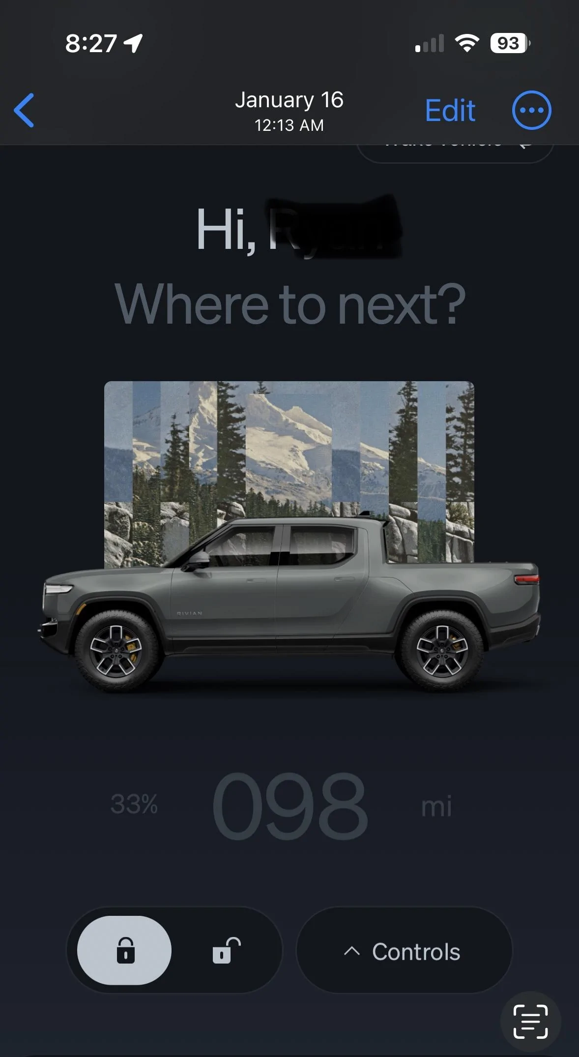

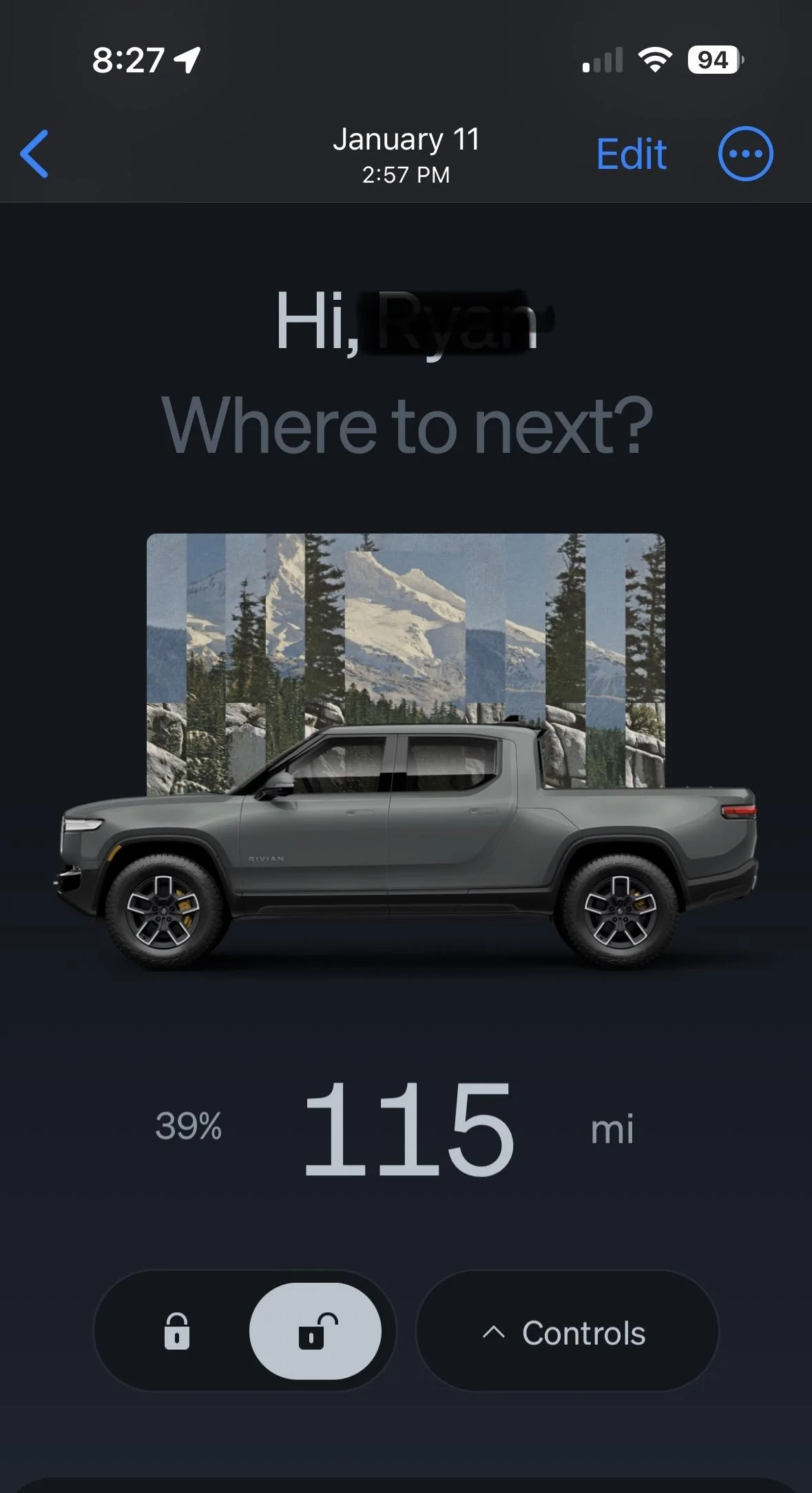

I'm at around 1.5% per day based on a trip last week when all airport chargers were full.
Left Wed at 3pm unplugged at 115miles range - 34degree ambient
Back Mon at 1am with 98 miles range - 31 degree ambient
16 miles in 105h = 3.41 miles per day.
Here is a variable I can't control: the initial reading was obtained after driving 50miles - warm batteries, warm truck etc.. The final reading was taken with a cold vehicle and batteries.
Gear guard off. App quit after checking initial and not turned on until I landed (*note was still at 98miles when I got to the car)

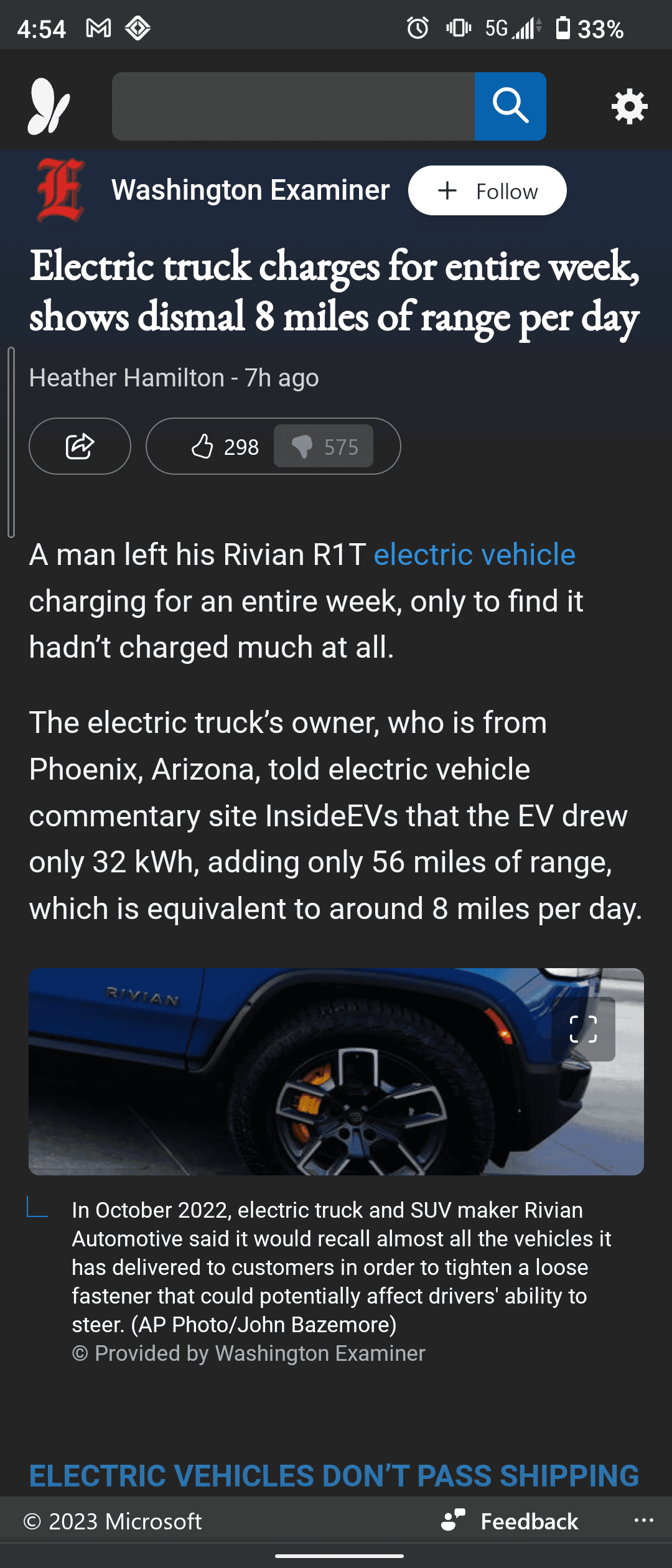

Congratulations! Your story was wildly misconstrued and used as anti-ev propaganda by the Washington Examiner.
The phantom drain thing is a real environmental and potentially usage problem though. Rivian needs to address this.
I saw this as well. It even prompted me to write them a comment via their Contact Us page. I have low expectations that they'll redact that article, which is littered with complete misinterpretations. I legitimately can't tell if it's intentionally misleading to support their well-documented political leanings, or simply the complete lack of editorial scrutiny that now passes for "news" at some of these outlets.
