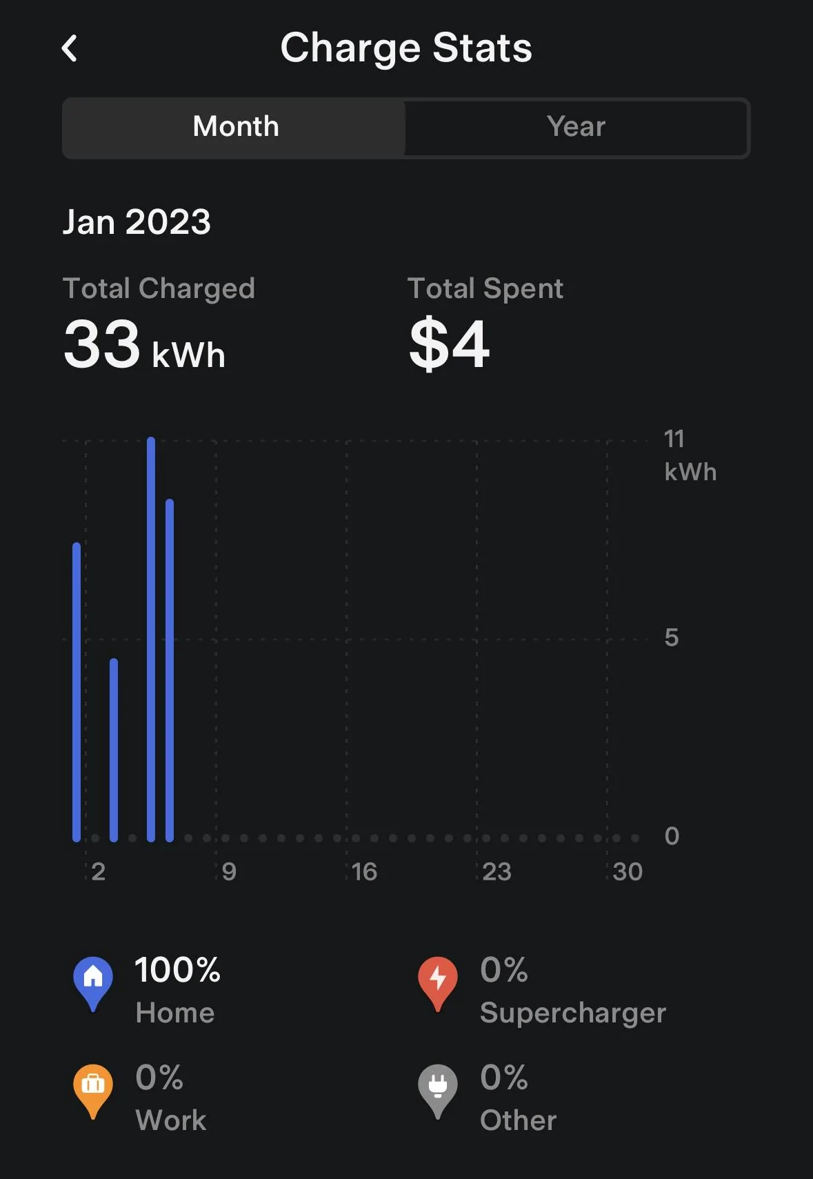

I’ve been out of town for the past week. My R1T has been sitting at home in my carport plugged in.
- 70% Limit
- 240 V @ 48 amps
- Charge schedule from 12am to 12pm daily
- the info below covers the period from 1/7/2023 to 1/14/2023. The car was charged to 70% after midnight on 1/7. My mobile car detailer washed the car later that morning and then plugged it back in. The car has been sitting there ever since.
- Gear Guard is off at home
- Car is connected to WiFi
- I didn’t pay attention but I’m guessing the weather in Phoenix, AZ during this period ranged from daytime highs in the upper 60’s and overnight lows in the low to mid 40’s.

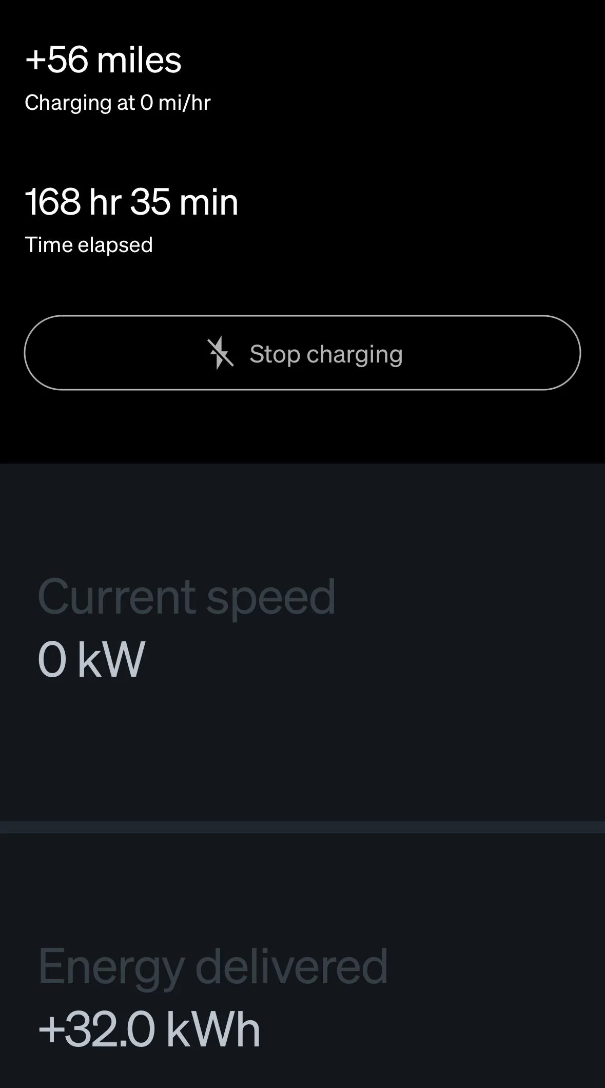

According to info in the Rivian app, the truck has taken 32 kWH of electricity in the past week and added 56 miles of range in 7 days.
That sure looks like losing 4.57 kWh/day and 8 miles rated range per day while the truck is sitting idle.
Am I interpreting these numbers correctly?
I did call Rivian service, who said this is more than expected, and they are scheduling a service appointment for me.
Here are some screenshots. The second is from our Model 3 which is plugged in and parked right next to the R1T. It has taken 0 charge in the same time period.

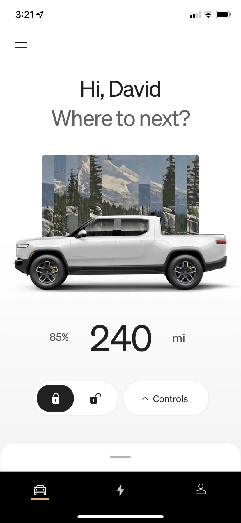

FWIW, as a test, I let mine sit unplugged, outside for almost 10 days while I was out of town. Temps were in single digits Fahrenheit much of the time. It went from 85% to 82% during that time frame.

My R1T has been sitting unplugged for almost 5 days. Started with 85%/240 miles, now down to 77%/216 miles.

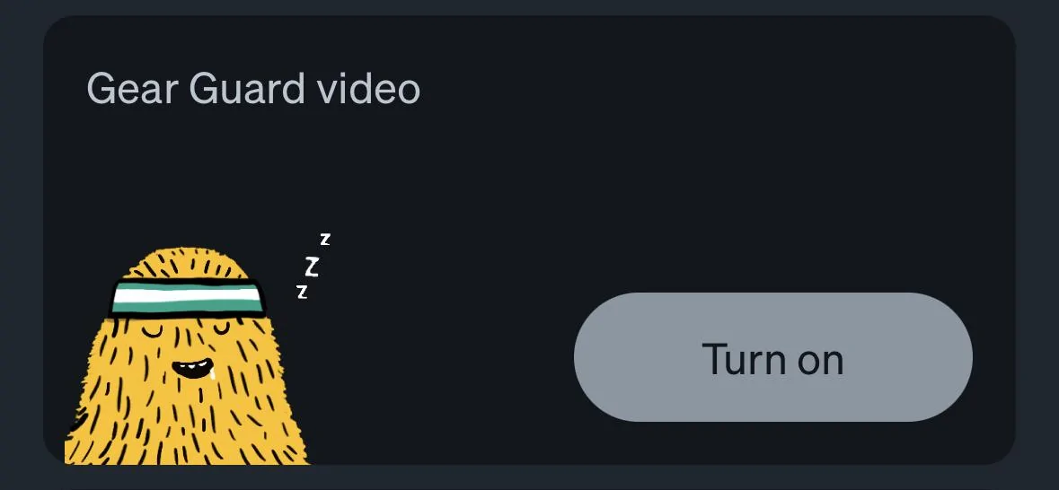

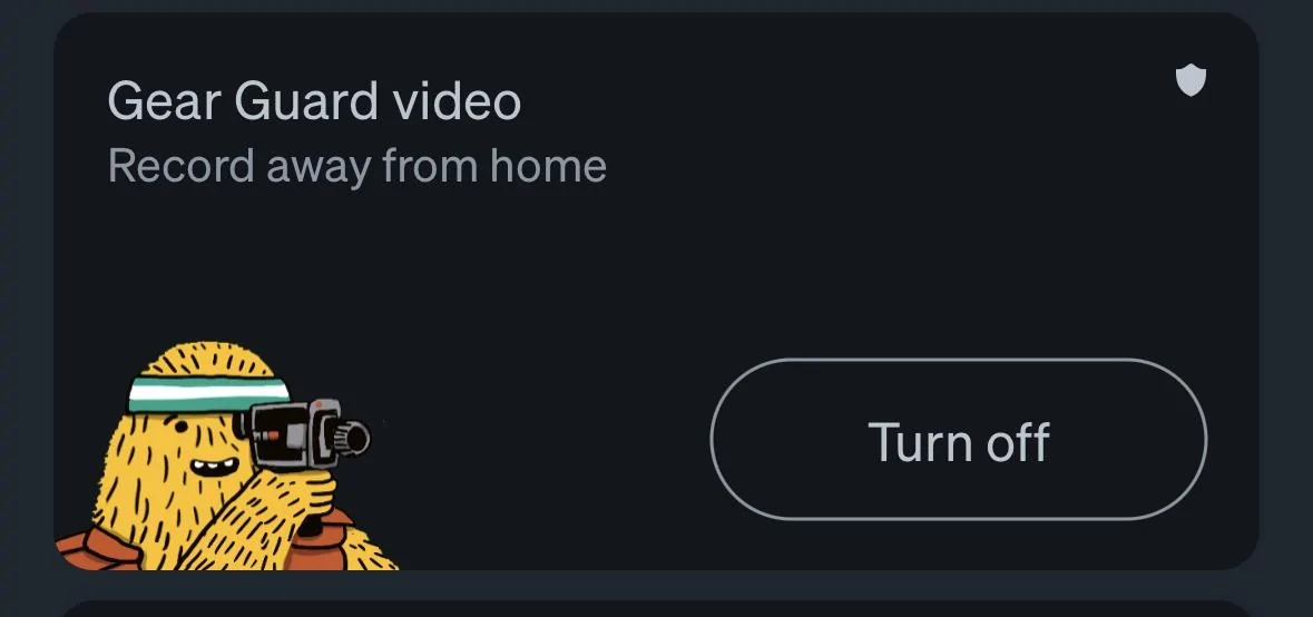

I just looked at my app again. I’m wondering if Gear Guard was on in my case? I won’t know until I get home and see if anything was recorded.
Anyway, I saw this in the app - Record away from home as I set it.
My car is at home, but does that picture mean Gear Guard is on?
I just manually turned it off via the app. We’ll see if that makes a difference. I’m not back for another week.
