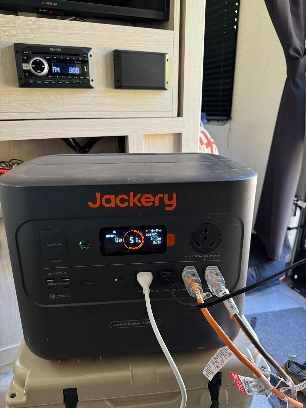

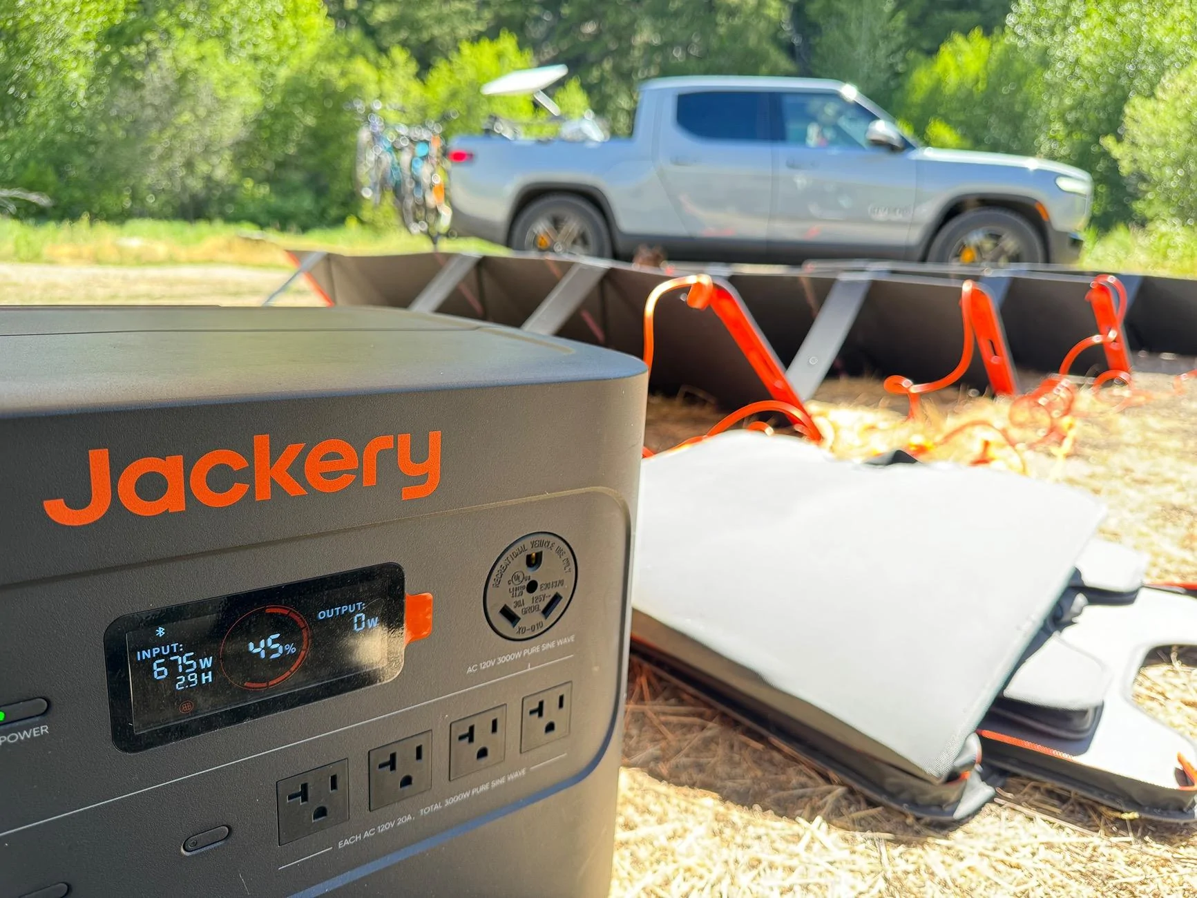

I’ve does this, but without any major appliances/ac running. However I typically use an electric generator, and then if needed charge the generator via the truck 120v - or on a sunny day break out the solar panels. This is a Jackery 3000 generator, which on a hot day can power the RV ac for a couple hours. By rv I mean 28’ travel trailer

No, only charged the Jackery with DC via the solar panels, not the truck 12v.
Also FYI in case it applies to other product brands - because the 110v of the truck is rate limited to around 800-900w, I’ve needed to use the Jackery “slow charging” setting, otherwise it tries to pull too much power and trips the truck’s outlet power to turn off. So without that feature you’d be up a creek - but on slow charge setting it works fine…
