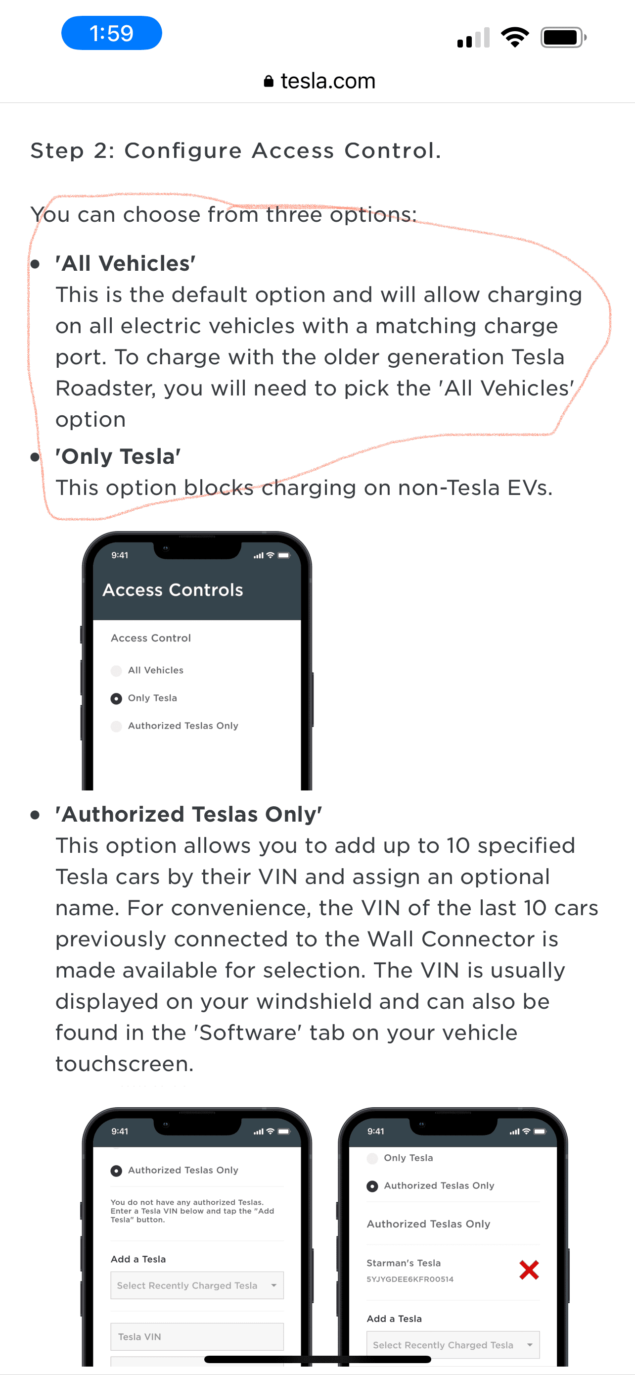

I have two Tesla Gen3 wall connectors currently on two separate 50a circuits (would like to go to 60a in time possibly). It’s early days, but I am experiencing mixed results with charging the R1T with the Lectron 48a adapter. Initially, the R1T charged at about 15miles/hr without issue (over about 4 hours) but lately I have been receiving an error when trying to charge, wall connector ā€˜cycling’ and ultimately R1T port turning red and no charging. I have seen the ā€˜wait 30 seconds after attaching adapter before connecting to vehicle’ tip mentioned, but that has not changed anything.

I’m sure you done this, but just Incase. Did you go to the settings on HPWC Gen3 and open it up to other vehicles? You do it through its network ip address.
Thanks for this. Unfortunately, I don’t have Wi-Fi yet at this location so have not connected to the Tesla connectors so maybe that is the issue although I am confused because if the initial successful charge of the R1T.
The Tesla v3 HPWC, has its own wifi, in the install, there was an ip address need to connect. If you use an iPhone or iPad and refresh the wifi it might show, if not recycle by pressing the ā€œbutton on handle, and holdingā€ until the charger reclycle. On the side of the charger there is a QR code that you can scan.
Thanks. I will connect next time I’m there. Turns out that the default mode out of the box is supposed to be ā€˜all cars’ vs the ā€˜Tesla only’ option, so that should not have been the issue. I need to talk to Tesla when I’m at the chargers.

Default is ā€œTesla onlyā€ on my chargers, I have 3
Hmmm, ok, I was just reading from the manual where it said default was ā€˜all cars’ but when I connect, all will be clear.

I finally got connected to the Tesla units and realized the default amperage setting was 60a. Changed that to 50a and from that point on the R1T charged fine with the Lectron adapter.
