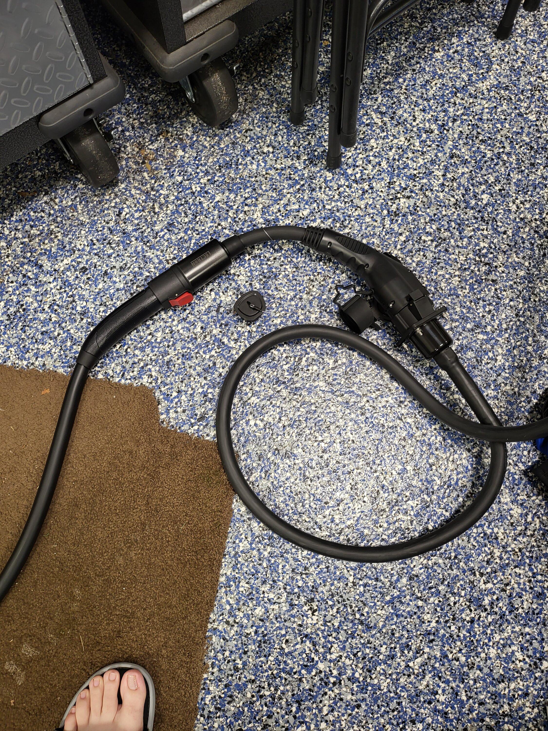

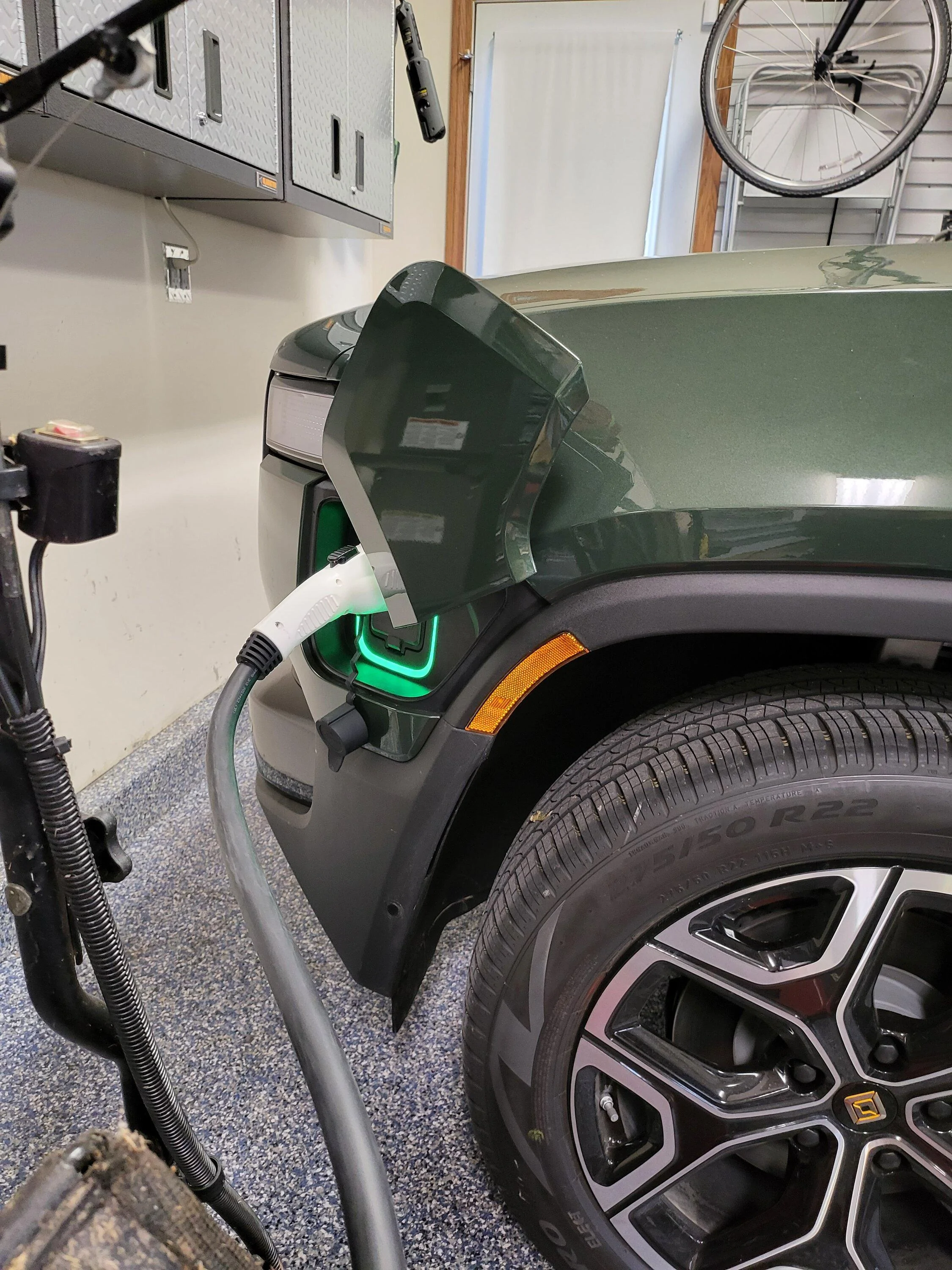

FYI, I did #4 because I was already setup with two HPWC. For the most part it works and it's hard to say that it doesn't work except for one time.
https://www.rivianforums.com/forum/threads/tesla-hpwc-lectron-adapter-red-ring.6284/
I just picked up a second, slightly used, Gen 2 Wall Connector this past weekend. I'll be installing it over the next week. I'll provide an update on my results shortly.

I just finished installation of 2 Gen 2 Tesla chargers on a single circuit. I'll update my video to show anyone interested how that worked out.
