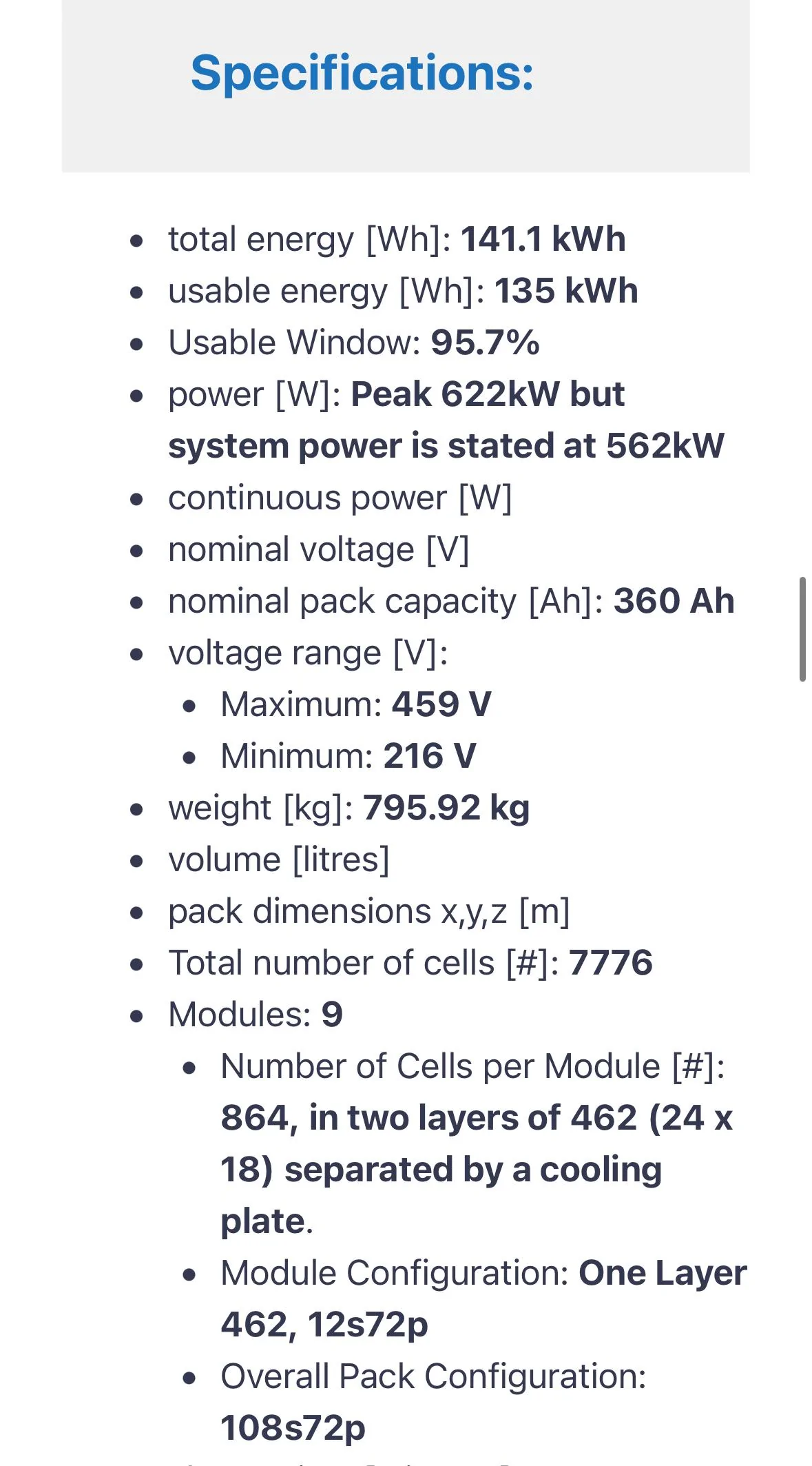

This unofficial page says 135 kWh usable, 141.1 kWh total. There was a software update at some point in the last year that increased usable capacity slightly:
https://www.batterydesign.net/rivian-r1t/

Whoa! This reports a lot more useable battery than I have heard previously. I wonder if useable means for actually driving purposes or if some of that useable is reserved for other functions.

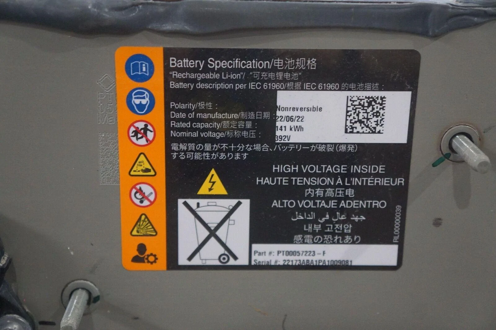

Okay. I give up. 127, 128, 130, 132, 135 🤷🏼‍♂️
Well, to make things even less clear, the specifications stickered on the actual battery packs say 141 kWh.
