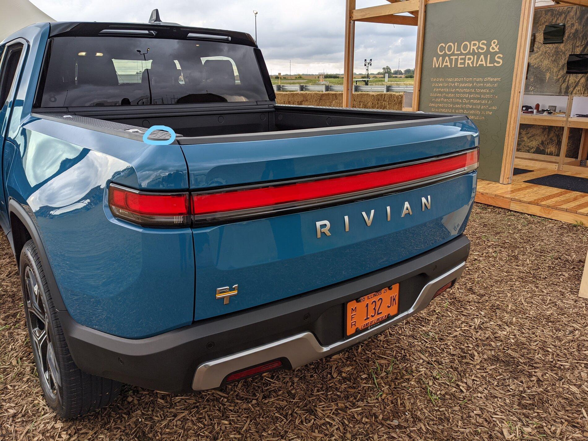

But to be more specific here is what I am talking about, that corner just pulled out. I am not sure if its by design or not, but seemed too easy to snap in and out.
