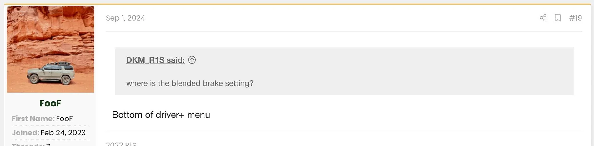

How does one turn the brake blending off? I don't recall seeing this in the options.
