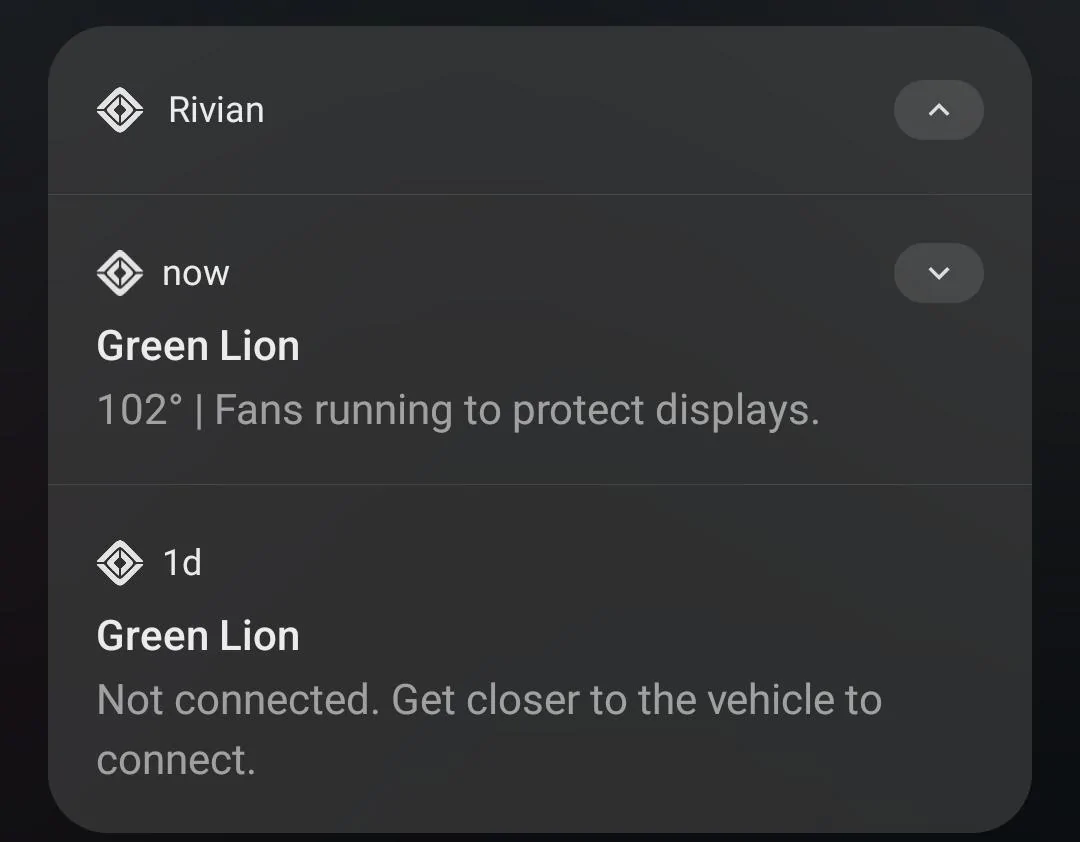

Why do I sometimes get a notification that reads "turning on HVAC to protect screens" but other days like today the cabin was 140f?

I have zero evidence to substantiate this theory, but I had a friend who speculated that it is not tied to ambient temperature in the vehicle, but rather surface temperature sensors that could possibly be located on the screen. So it's not triggered necessarily by the car interior being hot, but rather direct sunlight on the screens heating up the surface.
But again this is unsubstantiated speculation

This is my speculation as well. But still seems inconsistent. It's not as if I park when the screens in direct sunlight

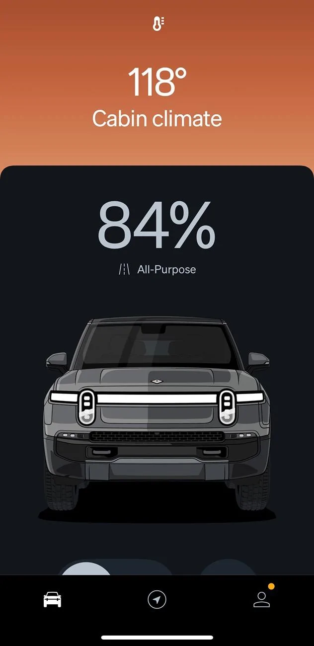

This is a great question. I get the little thermometer showing up in the app with a message that the interior is hot, and have seen it as high as 140, but I have never (to my knowledge) seen or heard the HVAC kick on nor gotten the protection verbiage in the app.

Right but if its turning on the HVAC in some cases, it's Because these devices do not have their own cooling ability, you would assume ambient air of the cabin works like an oven to drive up the surface temperature of everything in the car including the screens.
My R1S, with Ocean coast gets hotter than any other car I've had. I park on an uncovered driveway , where the sun directly passes over the car from the rear to the front. And have seen cabin temperatures near 150F and it not have any screen protection and other times when its 115F and have screen protection. Just seems odd

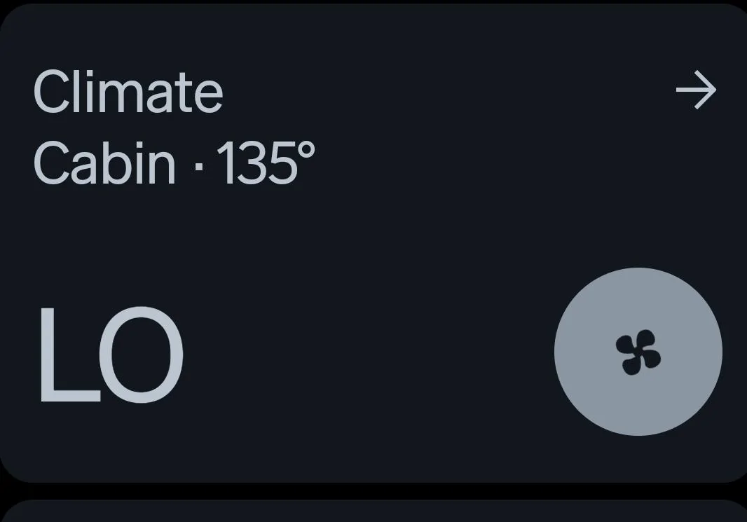

Today ?‍♂

I don't know what part of that is strange to you, I see it regularly here.

I’ve never once had “fans running to protect display”. Even at 140+. This is all I ever see:
