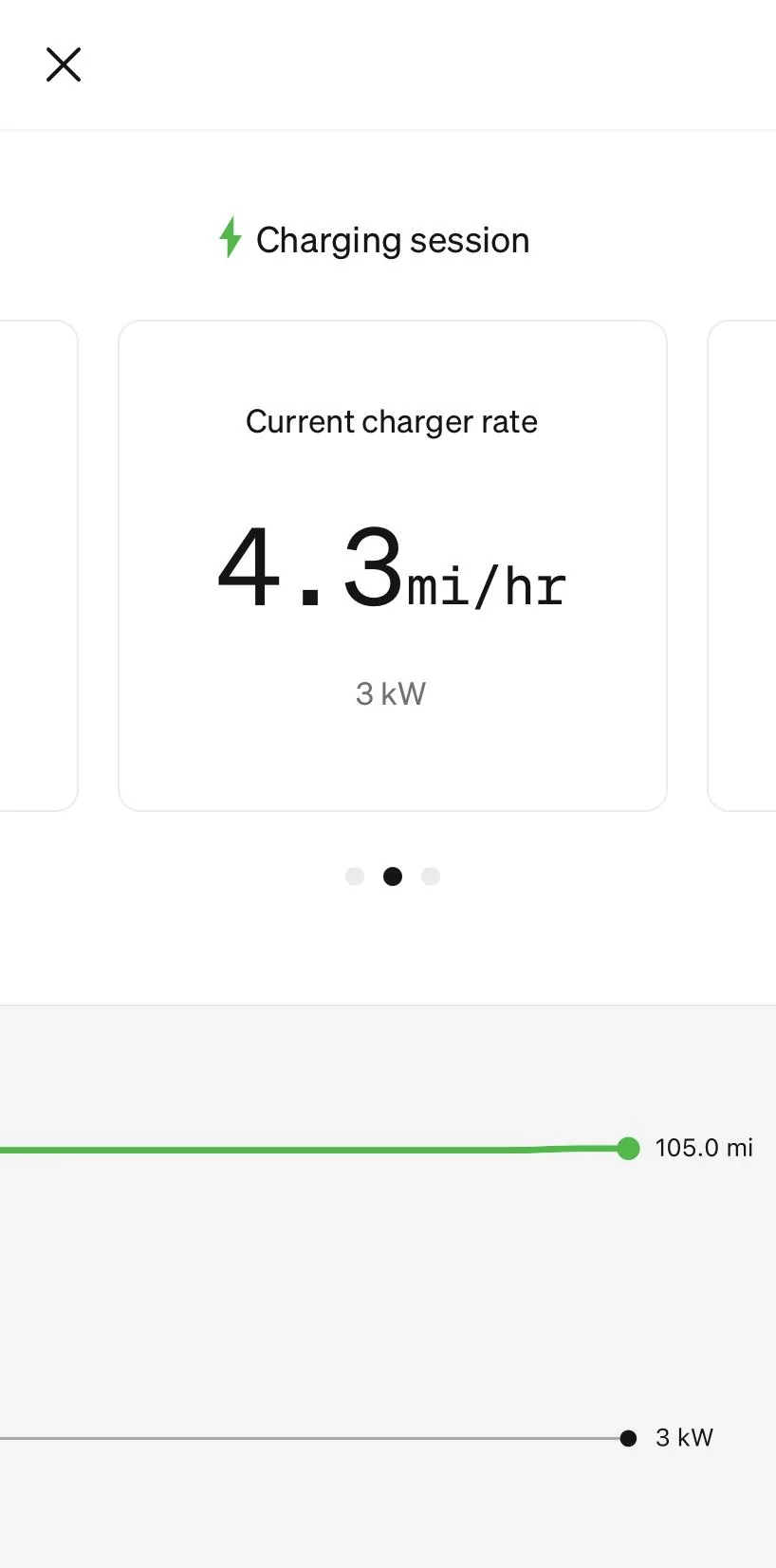

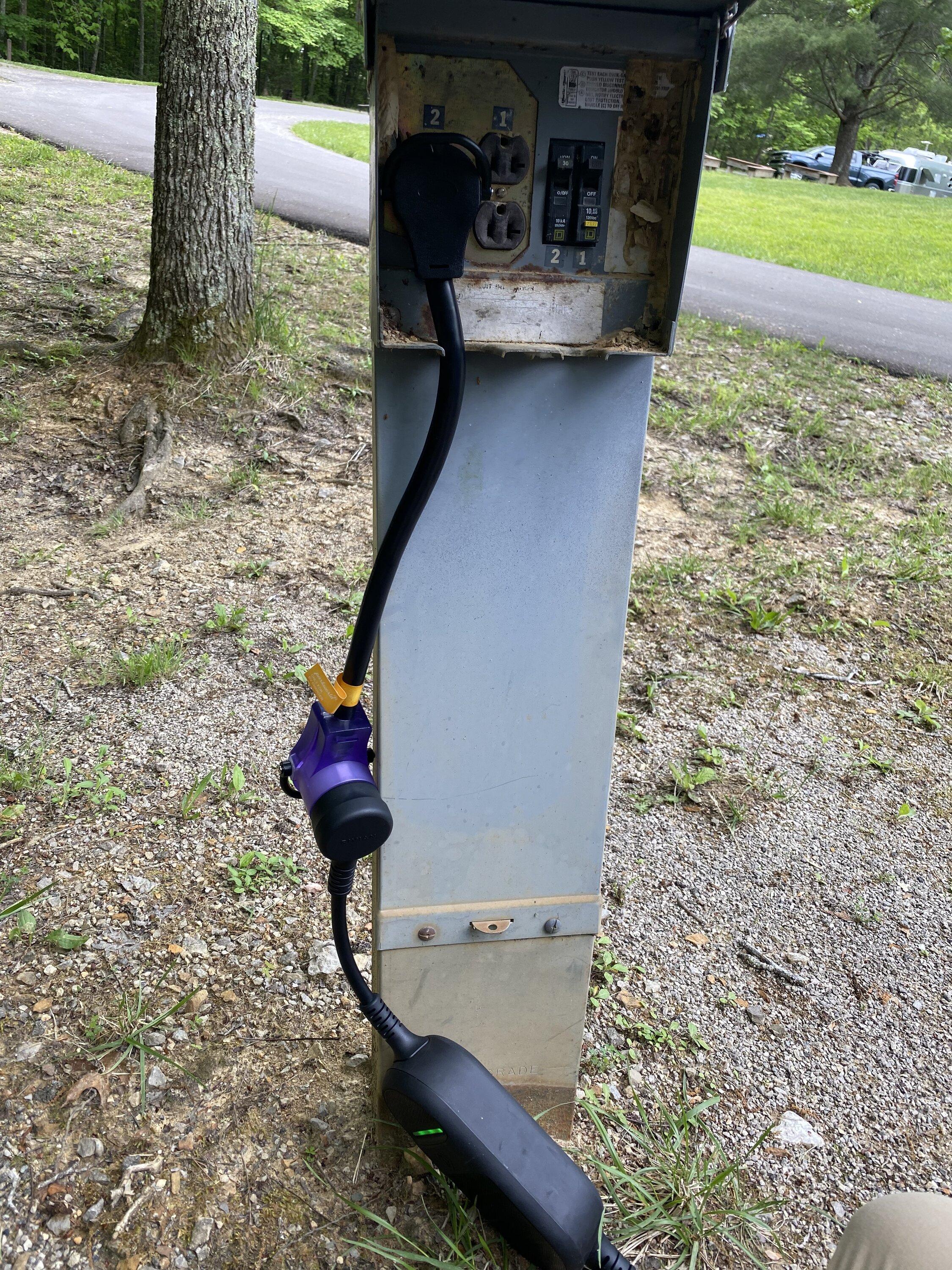

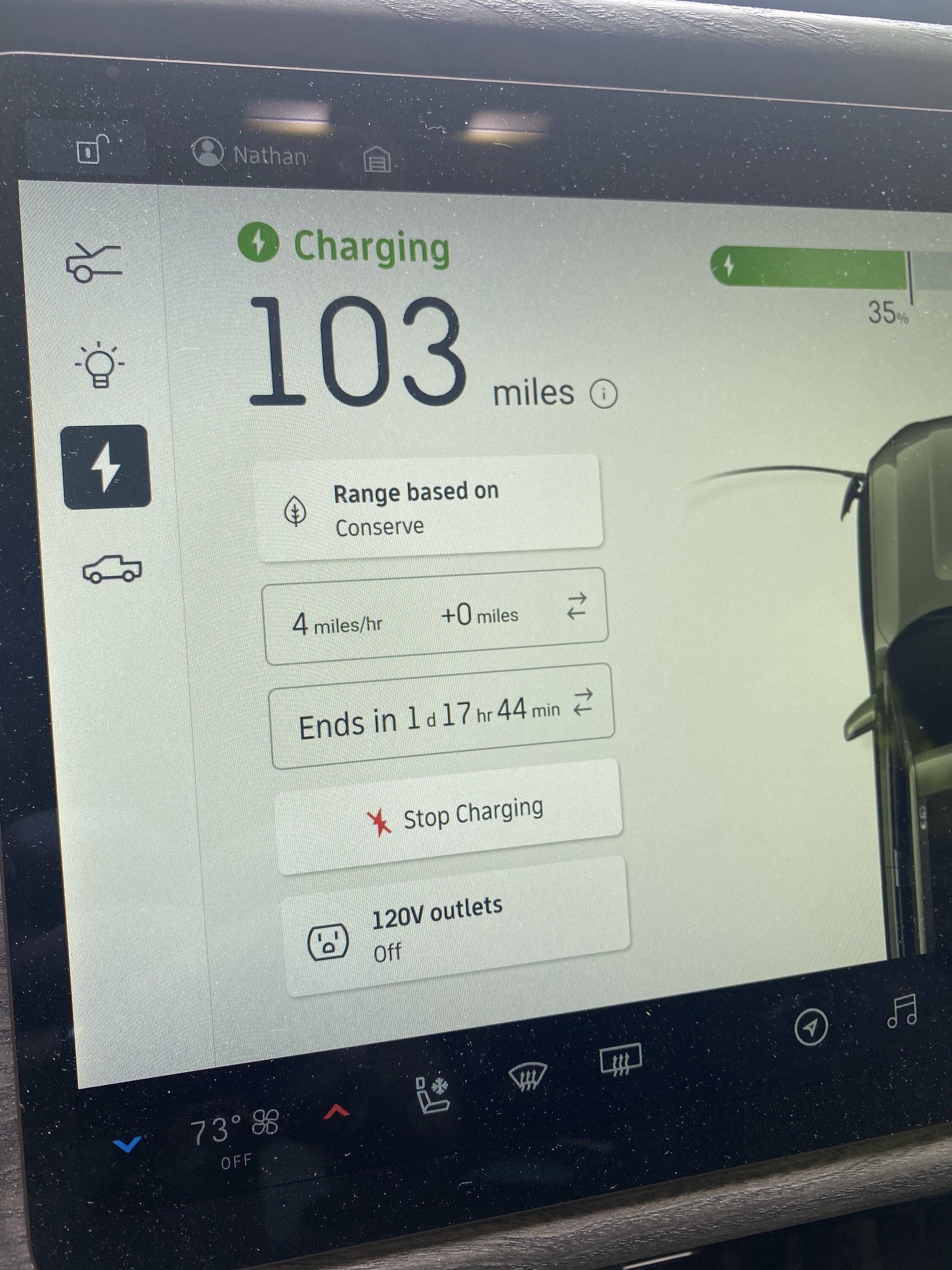

So far so good….
Rivian R1T R1S TT—30P (120v) to 14-50P (240v) adapter? ED0DF92F-1BAE-4614-B8D5-368A1BC50B6E
Rivian R1T R1S TT—30P (120v) to 14-50P (240v) adapter? F63944E1-52DC-4561-A7F6-3978DBB38392
Rivian R1T R1S TT—30P (120v) to 14-50P (240v) adapter? DC03100B-9C49-443A-9E3D-5F61237C6913

It is doing a 120v pilot @ 24 amp (I assume limited by the car's ability to limit amperage)? That is awesome to hear.
Factory EVSE or did you have to buy one?
3,384
6,391
The photo shows the included factory mobile charger.
